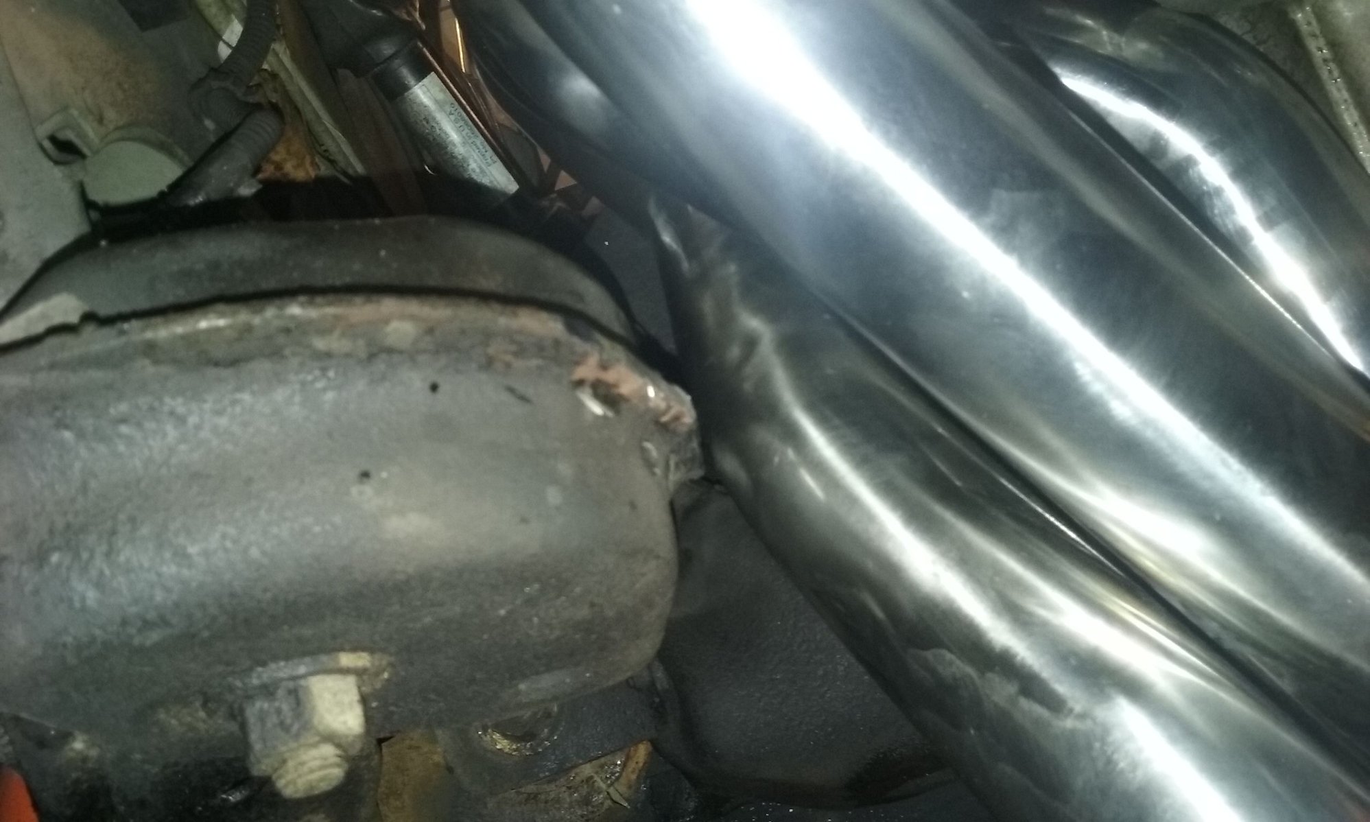

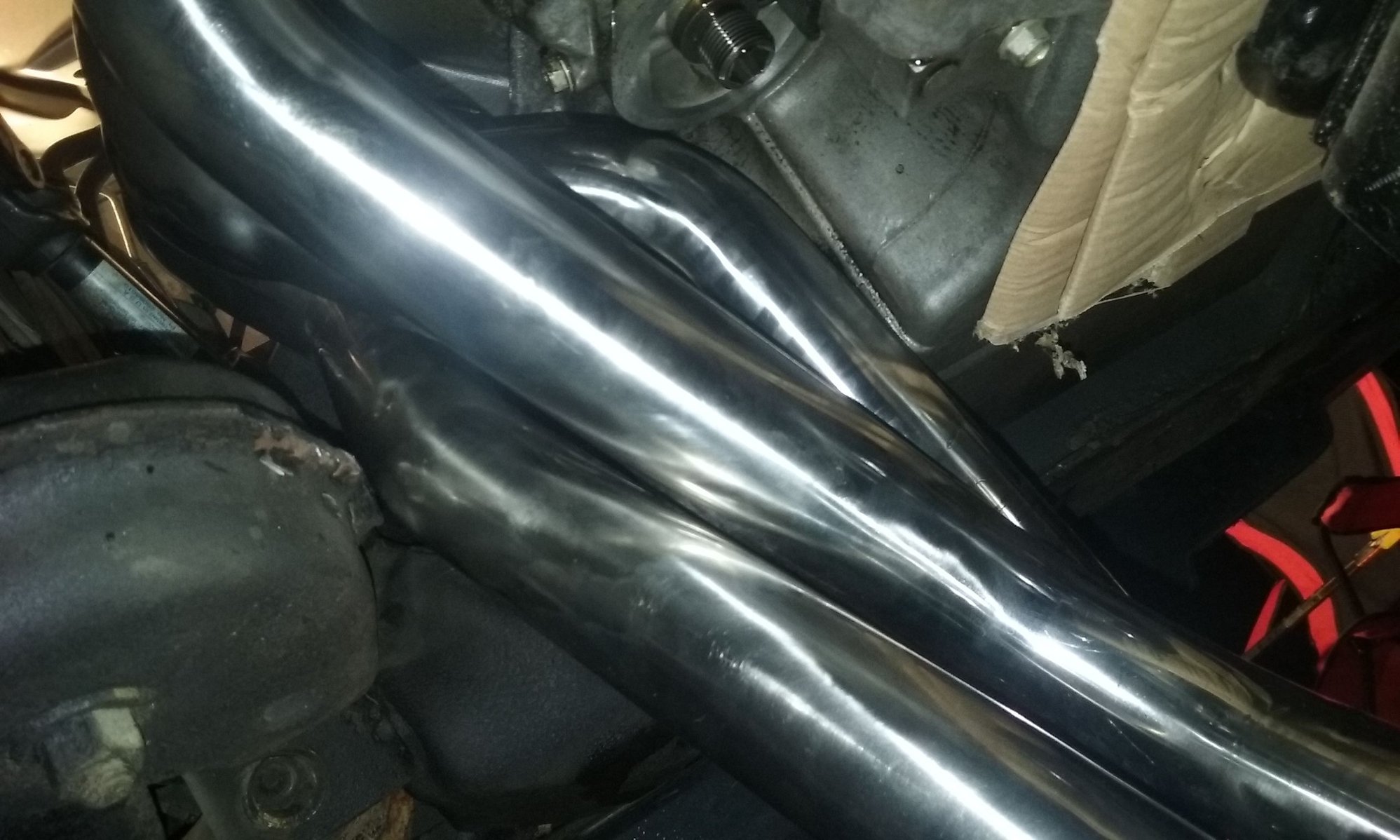

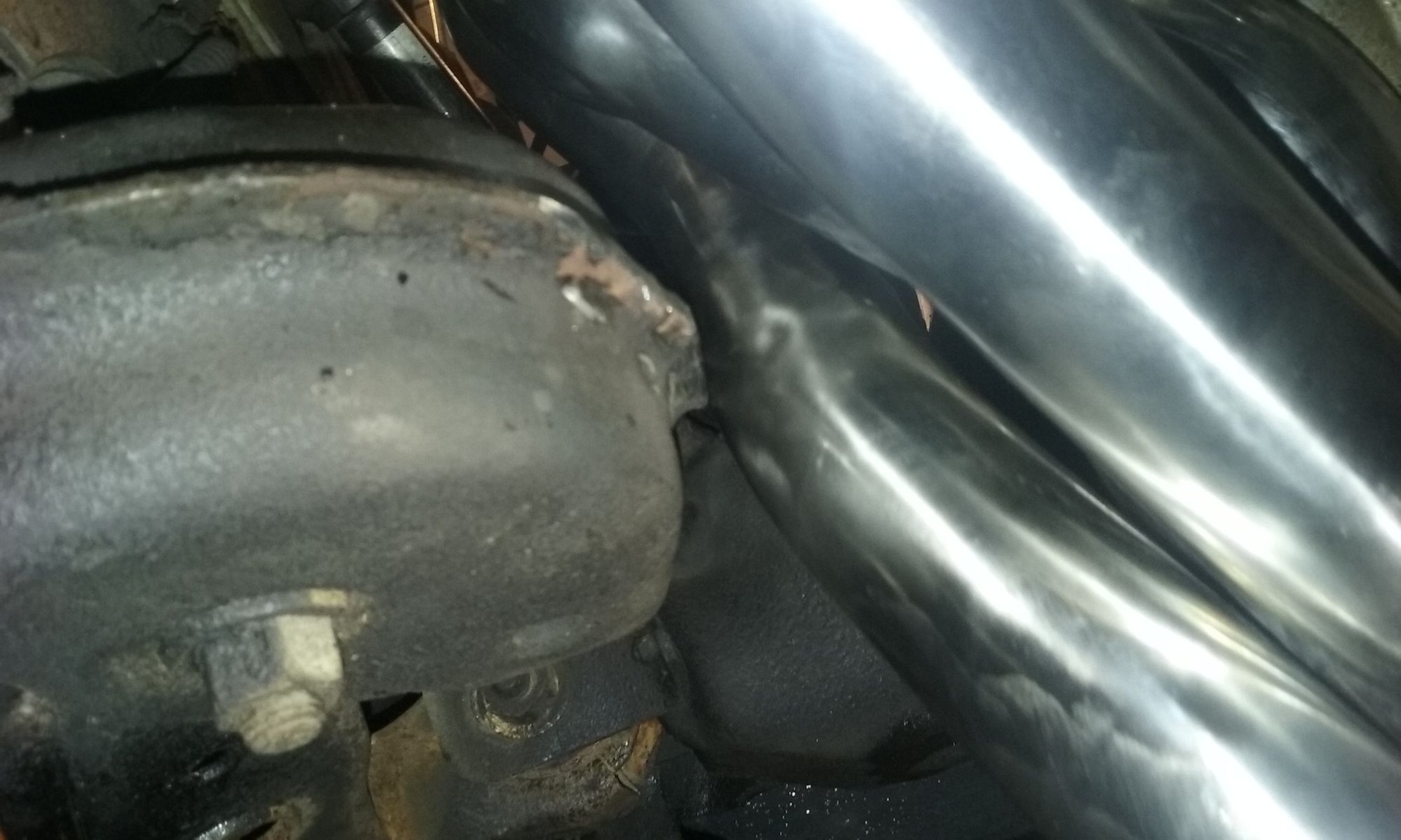

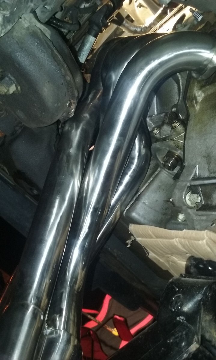

Default Update: possible bent tsp header
You can see the dent, It's small, but right on the outside of a bend in the pipe
I'm thinking I have a bent pipe in my header, I've got the car up as high as I can lift it, lifted the engine another inch or so, ground the lip of the k member, pulled the oil filter, and the damn thing just will not go in. I'm attaching pictures of where it's binding up.
