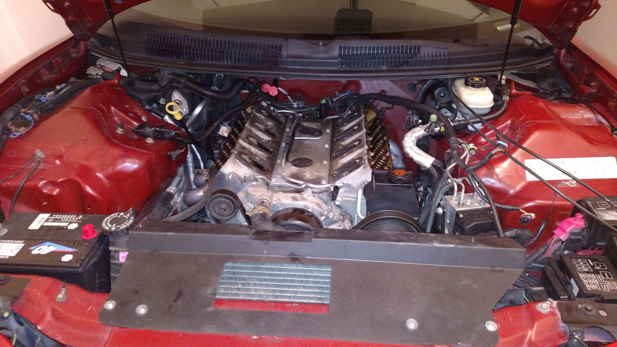

No need to practice on a vehicle. I removed my intake, valve covers and rocker arms last night in about 2.5 hrs.
Removed the fuel line in literally 3 seconds.
Put disconnect around line, push silver fitting in, push disconnect tool under silver fuel line connector then pull.

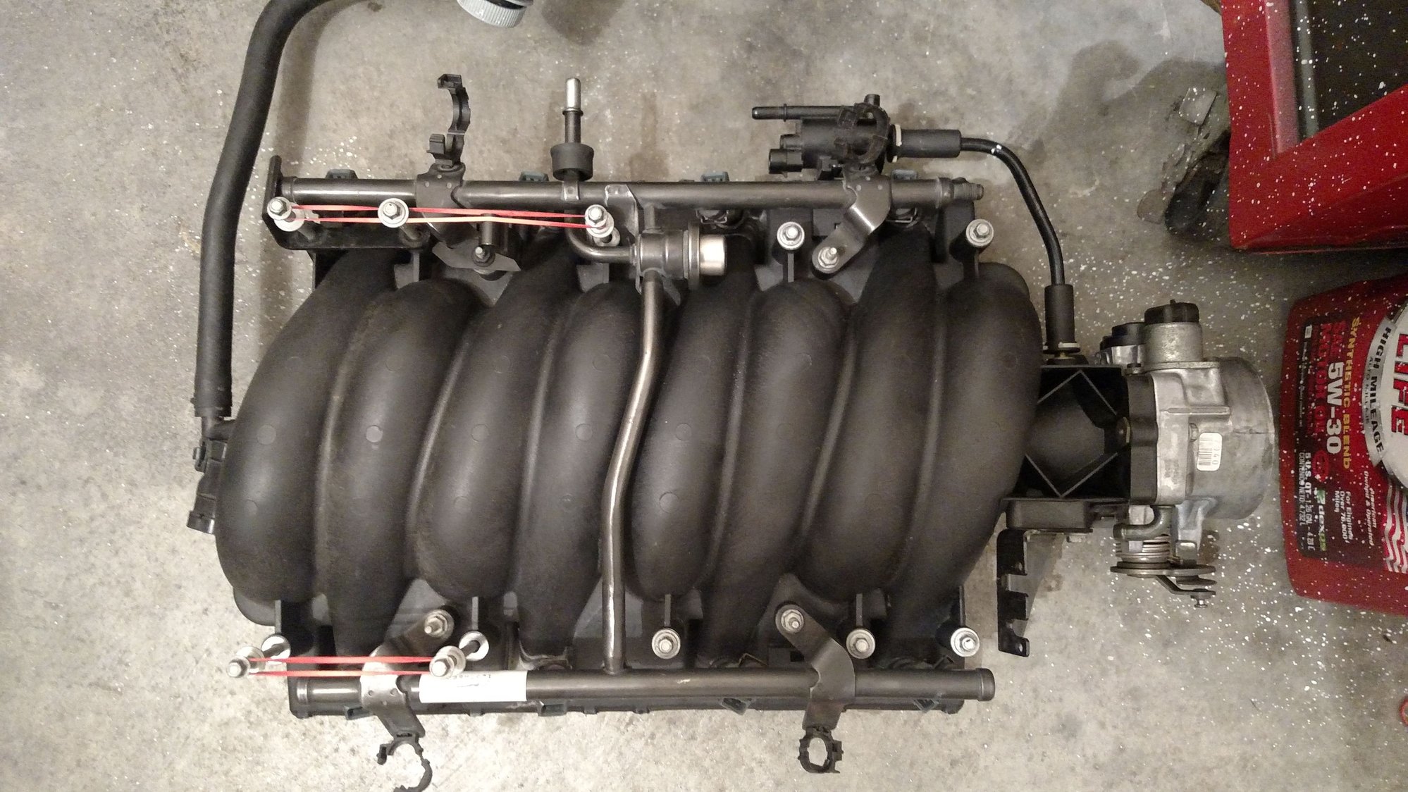

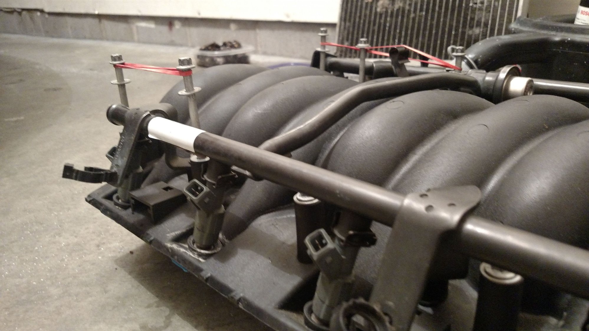

what are they? rubber bands? that's a good idea, was reading about using tape to hold them up but like your idea better. Thanks for the help, very much appreciated.

Ya those are rubber bands. Also to help prevent breaking the oil pressure sensor the first thing I would do is pull the vacuum line out of the brake booster.
