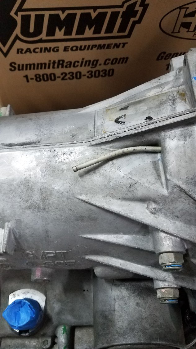

Its this just a vent? Its on a 2002 4l60e. If so, what do I do with it? Its going in my 64 Chevy II.

Exactly what it is.

Do I just leave it alone or run a piece of vacuum line off of it?

Slip some hose on it and run it to a place where any oil coming out will NOT hit any part of the exhaust or anything else hot enough to ignite tranny fluid.
