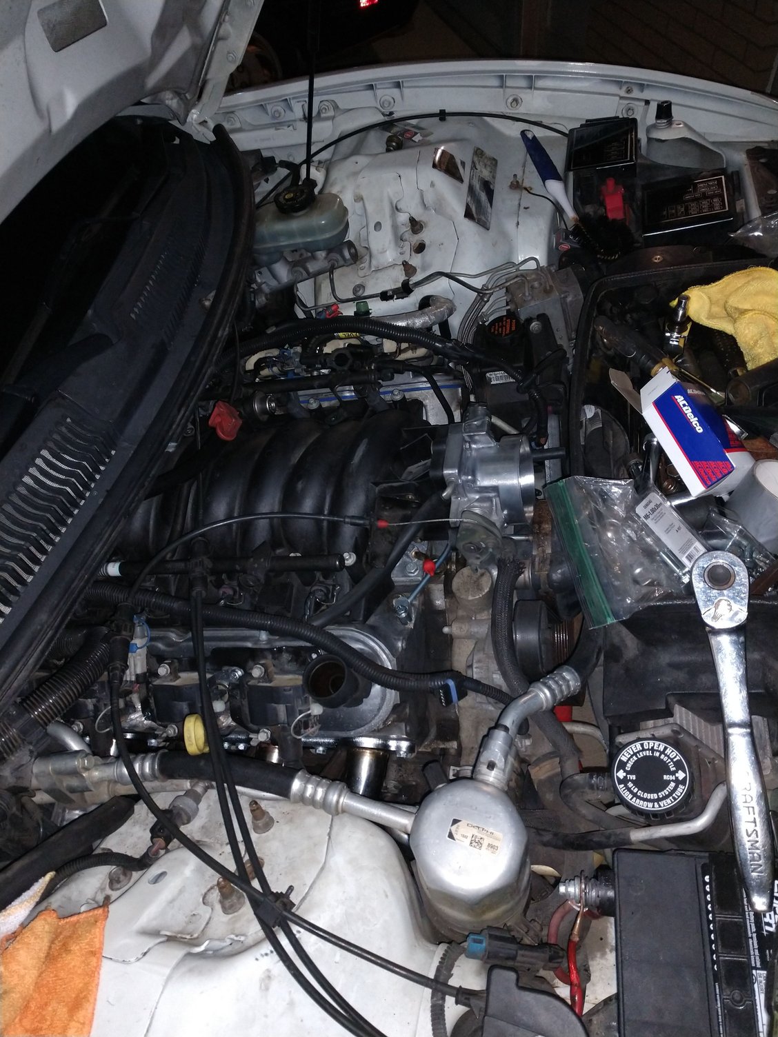

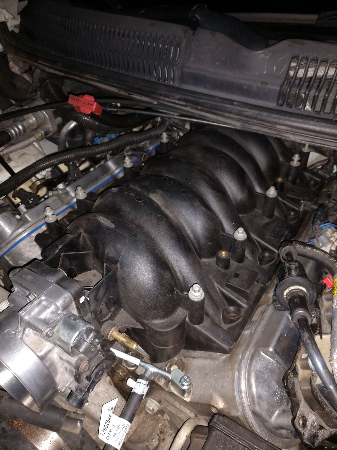

So far so great! Intake is installed, coils are back on and the car just needs to get the remaining hoses for the pcv setup. I have a few open ports I'm lost on what they go to ( both ports for driver side valve cover and rear passenger valve cover).
So few questions:
1. The ls6 pcv has a small rubber hose coming off, I installed it on the front, where does it go to?
2. On the rear driver side, there's a hole/gromet there, can I block it off or do I need to run a hose to it.

There's 2 ports on both valve covers... What do they go to?
Is the bottom port for the HVAC?

Originally Posted by ls1fan92
Is the bottom port for the HVAC?[/i]
yup surely is

Trying to go strictly off memory here. Vent hose goes to drivers front. Drivers rear and passenger rear come together in a T and run to the front of the engine along the passenger side. The pcv valve was in that line and it connects to the intake.
The threads on catch cans have diagrams and better info.

So far I have the ls6 coolant line going directly into the driver side of the to. The pcv valve is connected to intake going back to the valley cover. Passenger front going to top intake on passenger side... Still trying to find a place for front throttle body port and a plug for the rear driver side valve cover

https://www.ls2.com/forums/showthread.php/829128-Stock-LS2-PCV-routing
That has a decent breakdown of the ls6 pcv set up. It has a few part numbers that could help

Something to hold until monday
Pretty sure I followed it correctly
Got the plug and passenger rear blocked to.
Tried to make sure I followed it to everything... I some how managed to lose my HVAC hose... Not sure if it's necessary at this moment (heat or air isn't a issue right now...) But I just got a few more bolts for the coil packs and she's good to go! Hope for the best...
