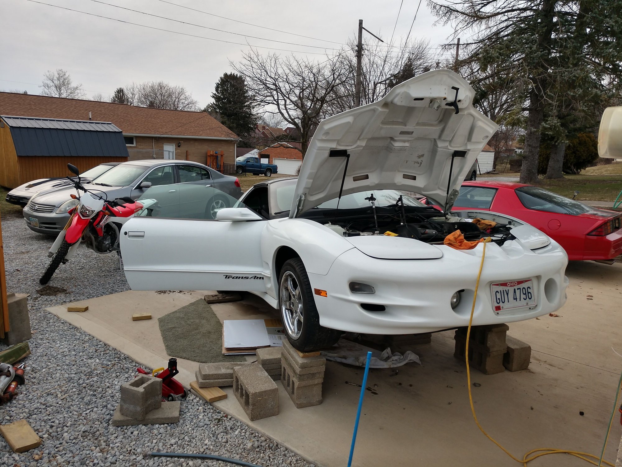

Good morning! Finally had a break in the weather, decided it's time to buckle down on this install...
I got the car jacked up a decent amount (sitting on a single cinder block with tires still on) but I'm having issues with the passenger side... There's these metal tab/plate that covers the firewall that's pretty bendable, but even with it moved I keep catching his corner... Is it necessary for me to remove the starter to get that extra 2-3 inches in or can I just grind that corner of my firewall away? I'd like for my car to start but I also don't want to end up in my passenger side carpet lol.

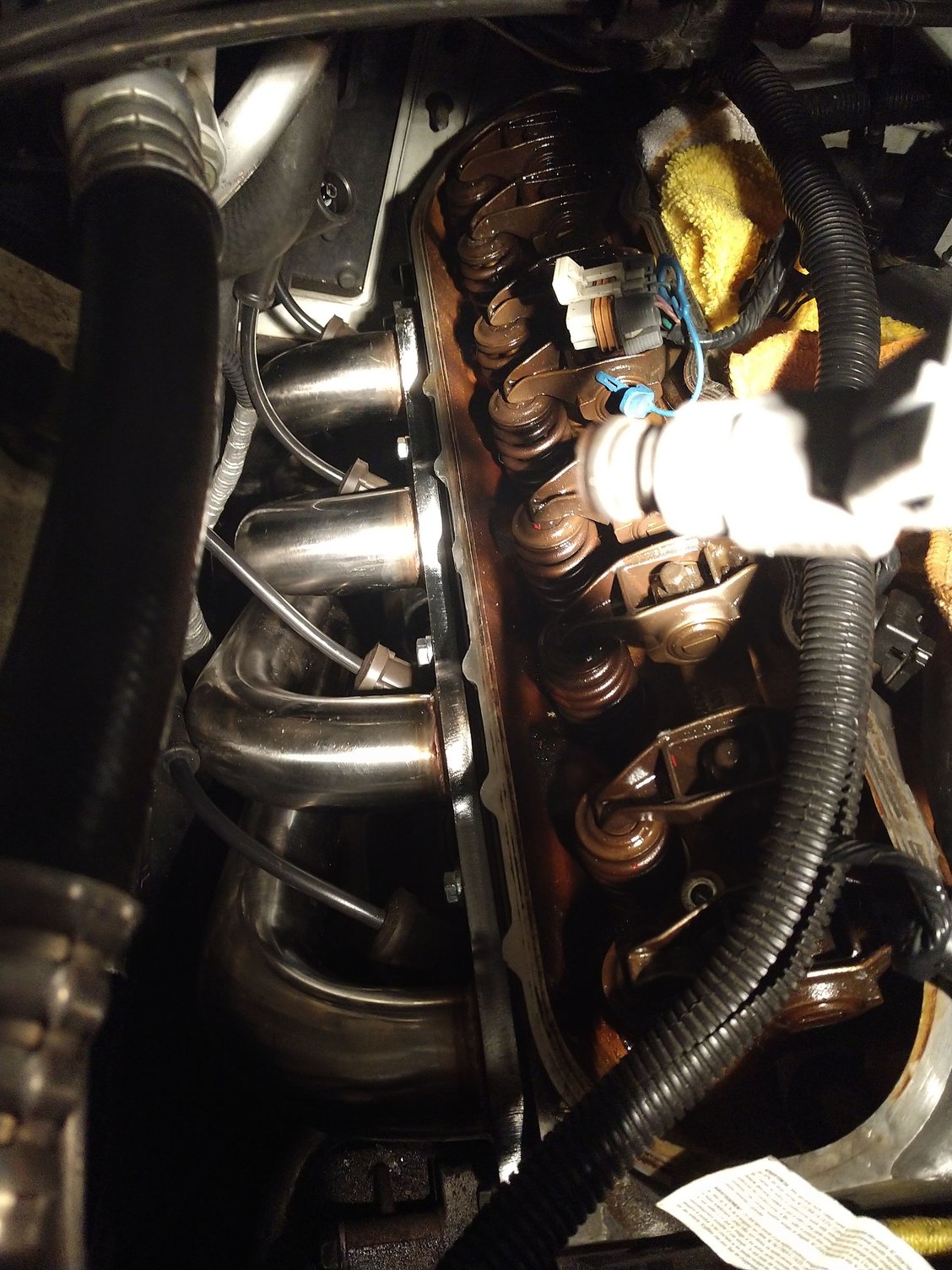

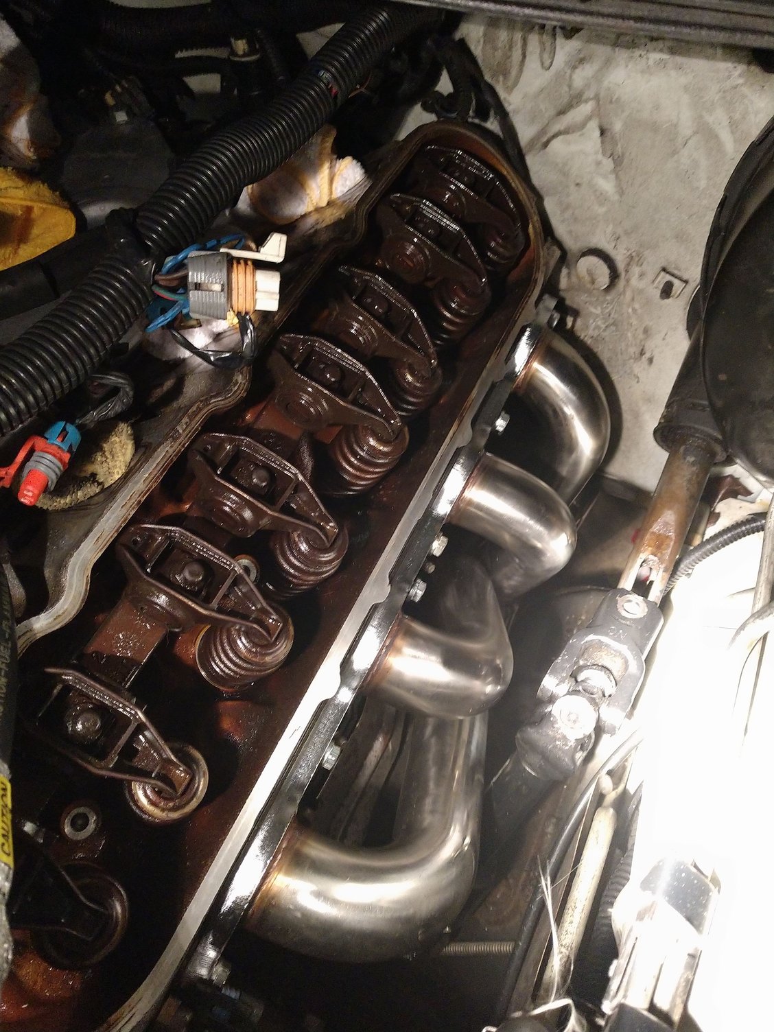

Fit through the bottom
Didn't have ramps to use, improvised.
Finally getting it together, passenger slid in like a glove, need to bolt up and test the drivers next, will keep posted, SO EXCITED!!!

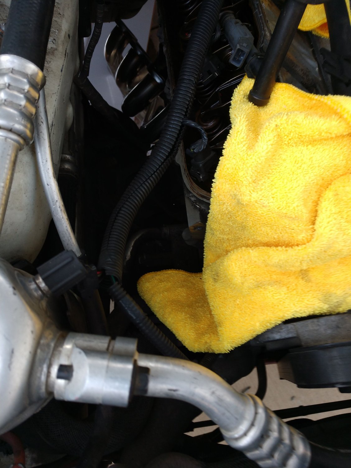

Need to piece the Y pipe together
My dad helped hold it from the bottom while I got the bolts in... Works best to install plugs, headers, then wire s
Need to bolt up steering, bent the metal plate/heat sheild covering the motor mount to get to the bottom bolt
The steering knuckle was a b**** to get unbolted at the bottom, I ended up almost with a stuck wrench and socket pressing against the power steering pump.

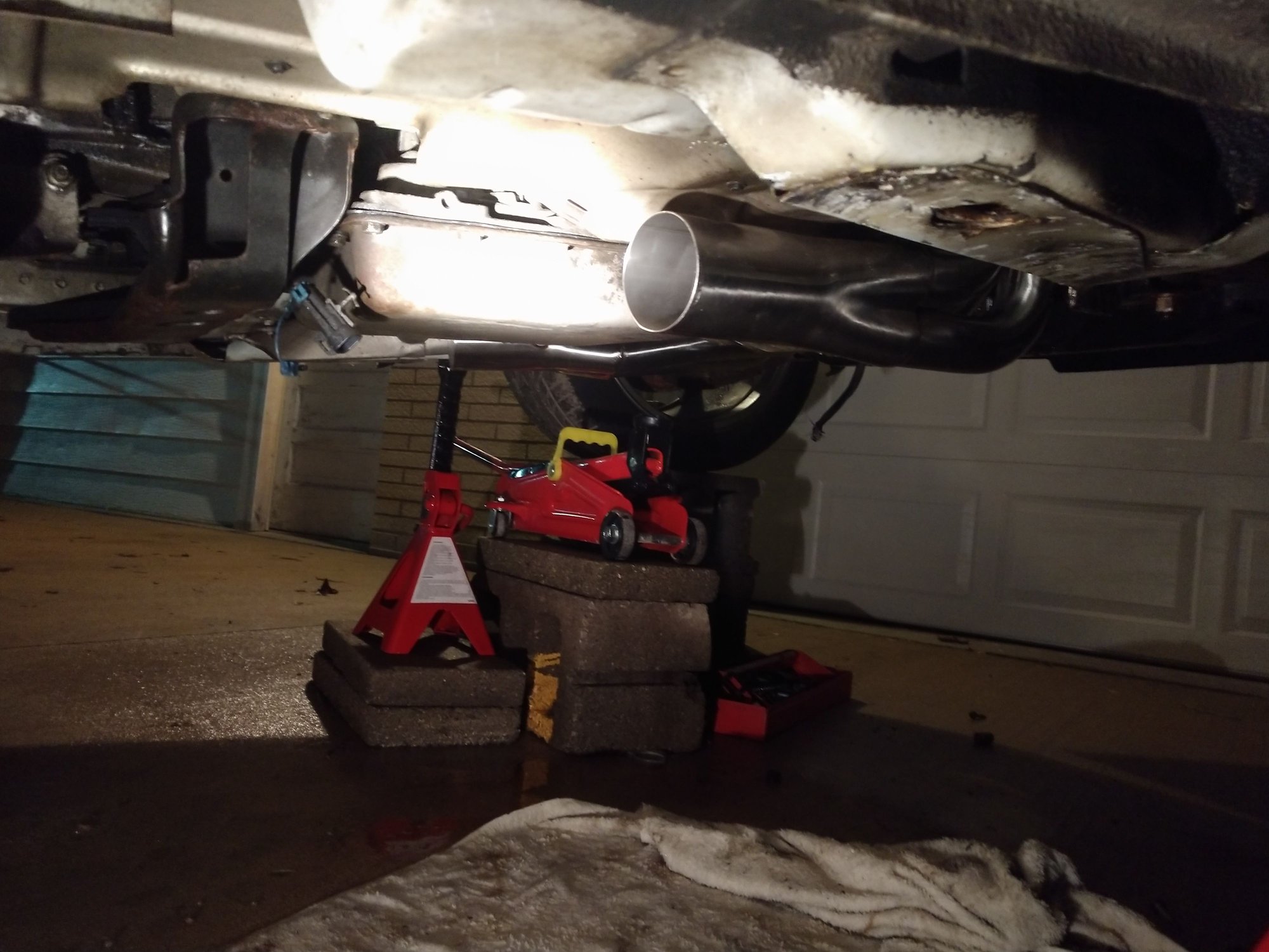

So far so slow... Got the 02 sensors in (rear driver plug is sitting on top of transmission....pita). Had to get a new tunnel brace, bmr brace fit perfectly for my y pipe (ORY), I keep reading issues people have with their TSP y pipe, so not sure the difference. Only issue was the 14419 magnaflow muffler didn't fit, was told it would be a direct replacement for SLP LM1 resonator but hey, take everything with a grain of salt... Taking to muffler shop to be fabbed. Will post pics later
