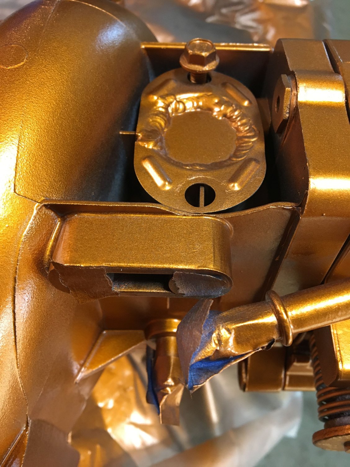

I thought i had a cathedral port intake but now I'm not sure? I also thought this was an ls1 or ls7 intake manifold. can anyone tell me, can I use this intake on my 317 heads (cathedral port from a truck LQ4)
first two pics are the intake i would like to use, the third pic is the stock truck intake.

That is an LS1 intake. It will bolt right up to the 317 heads. Are you using truck accessories? If so your throttle body may interfere with the truck water pump. You can buy a spacer kit to be used with a LS1 water pump and the rest truck accessories to solve the clearance issue. I have also read that you can use a newer LS3 style water pump without a spacer kit, but I have never done that.

Do you see the terrible excuse for a plug someone made for the port in the top? I'm assuming that was EGR or otherwise emissions related? If it's something I'm not going to use I'll have to figure out a more secure and "pretty" solution to plug it up.
I was wondering if I couldn't just crank that little tube counterclockwise. I'll give it a go. Worst case I have another repair to do. No big deal....I have a plastic weld kit

I will have to figure out what all the port were actually for once I start reassembling. I don't recall at the moment. I know there are some things I'll be getting rid of like emissions (since I'm using this as a collector truck more that 50 years old), and some things I'll inevitably want to add like boost reference for gauges/wastegate, location of the MAP sensor, and the differences now that I went from a truck intake to this ls1. I was wondering what that larger port was for that someone already plugged. It looks to be about 1" in diameter and directly on top the intake behind the throttle body.

I think that "terrible excuse for a plug" was actually made by GM to block the EGR hole on that intake manifold, or at least it looks very similar. It looks like someone tried to weld or glue the top portion. This is the part number from GM: 12558346
