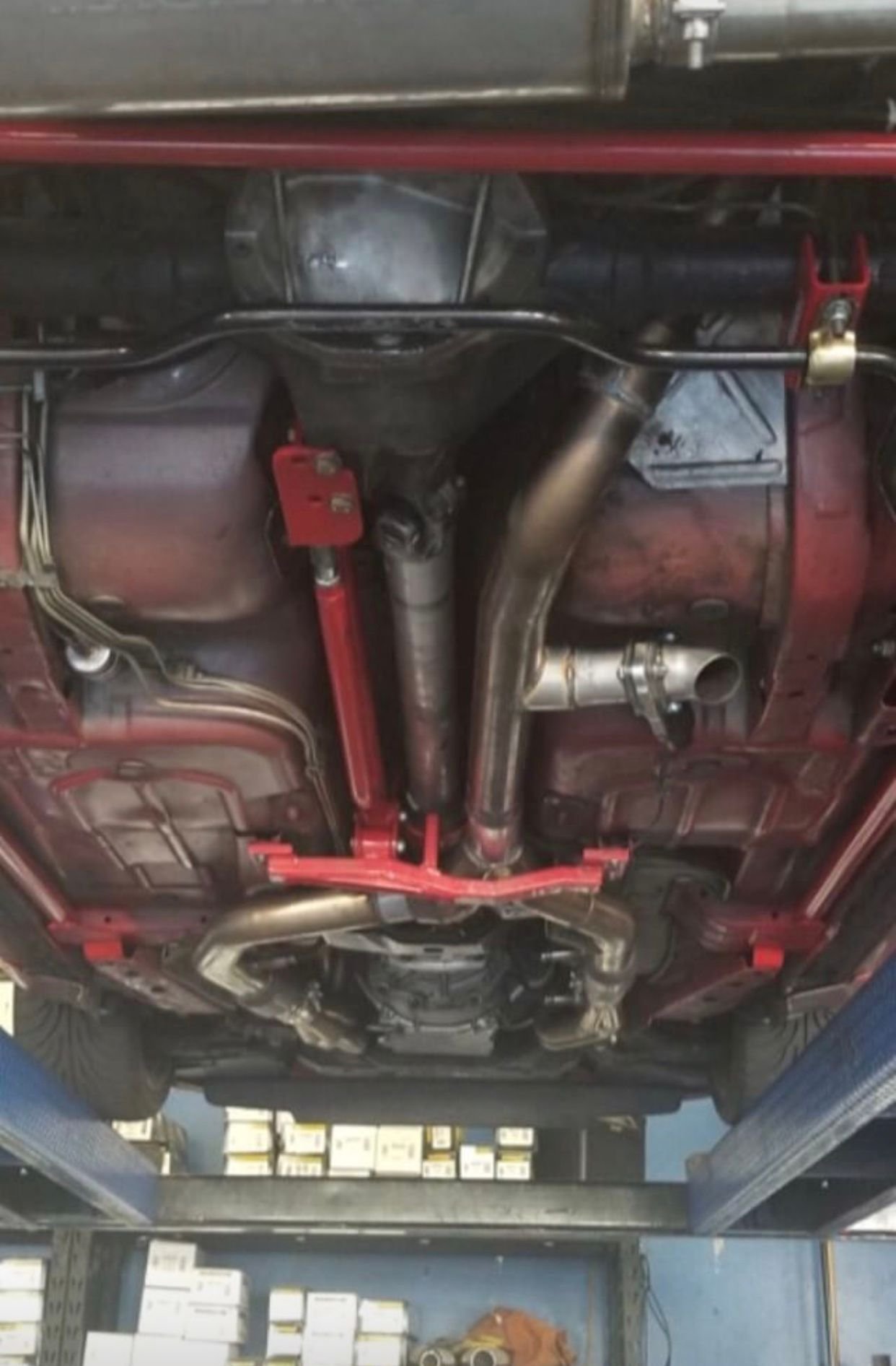

I ended up finding a used magnaflow 3 inch catback for cheap. The piping difference is pretty big between my muffler shop ghetto rigged 2.5 inch catback. Haha

Default Heres the new setup.
