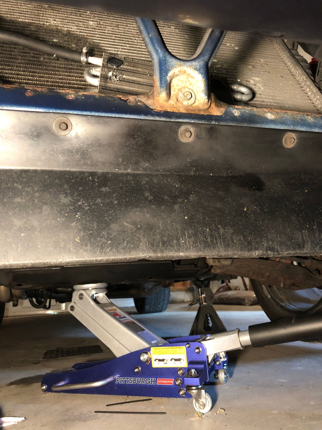

Hi guys I have a 1998 Z28 with the 4l60e. I have a ss4000 converter and a trans cooler mounted in front of my radiator as shown in the picture. I was considering a cold air or ram air kit, but was wondering about the position of my trans cooler. I prefer not to move it, and it looks like the SLP Duct doesn’t completely cover the entire radiator like the SSRA and CHRS1313 do. What do you guys think should I even bother with a kit or just leave it the way it is.
Thanks a lot,
Keith

A friend of mine just did the SSRA and at first had issues with the trans cooler, but i know he resolved it rather easily somehow. He is a member on here as well. Pretty sure you can find answers to this by using the search button

I mounted my derale cooler right beside my ssra.

Research "dope style" mount for the cooler. Then get the Chris1313 ram air. It works great and you wont be left wondering if you left anything on the table.
