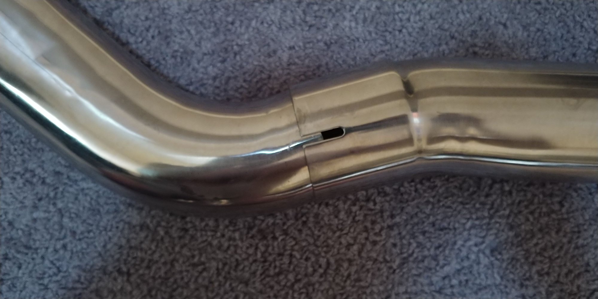

I for the life of me cannot get the driver's side wideband tube to connect into the x pipe correctly. It always seems off kilter for some reason. I don't like how the connection point is so close to the bend in the wideband pipe.
If anyone has installed this kit and can give me some pointers for installation I would greatly appreciate it. Maybe im just doing something stupid. Pics below.
This is how it looks when I try to get it installed. It just doesn't look right.

In regards to the close up pic; is that as far you can get the two connected? If so try to wiggle the male end so that it widens the inlet side. The inlet side might be pinched a little, check the gaps in the relief cuts.

No it goes in further when not connected to any other pipes but the arrangement of the other pipes inhibits it's ability to go in anymore during install.

I had to muscle mine in, coming from the LTs into the X pipe. I started at the LTs and worked everything else in from there. I had to remove different pipes and reinstall a few times before I was able to get the fitment right. Mark ur pipes so you know where they slide in completely that way you can slide in partials and then the rest when you get the X slipped on. Just play with it, you'll get it. What typ of LTs do you have??

Exhaust is always a pain in the ***. A rubber mallet helps. Being on the ground definitely makes it harder.
Try doing it different ways. It's been a while but if I remember right it was easier to put the drivers side all together well and then pull on the system over to the passenger side header and then tap the system forward with a rubber mallet or fight it forward.

OP, when you need to adjust the exhaust loosen the clamps (this would have been best when putting it on but anyway) and then put a jack under the sections you want to be higher and then tighten them. That should help get things where they need to be..
