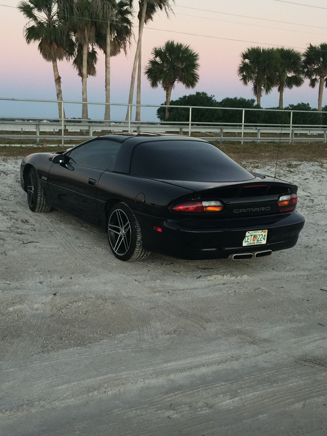

I thought I had better pics, but cant find any at the moment. I snapped these real quick but they aren't very good. Next time I have it jacked up, I'll have to take some real pics.

And this would be the finished product.
