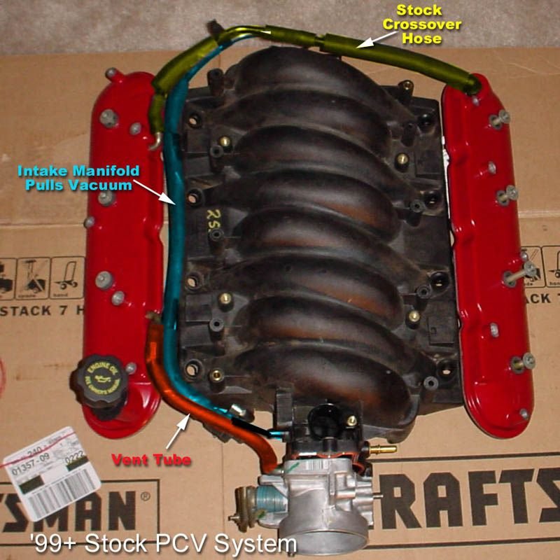

instead of making a new thread im curious if anyone has good diagrams and photos of the factory PCV system, or guide to replace it?
Theres a crossover hose that goes from drivers to pass side and then it goes up to the TB.
is this picture accurate? Im thinking of redoing it all just so I know where it stands and I assume you can use parts that are not factory GM?

High stall converters(9.5") can cause similar symptoms due the smaller diameter not loading the engine the same, but a TBSS stall shouldn't be an issue. It's still a standard size converter.
Yea you can use non factory parts like 3/8 heater hose....Fyi those lines are notorious for cracking and causing issues like you describe. I would replace them for sure.

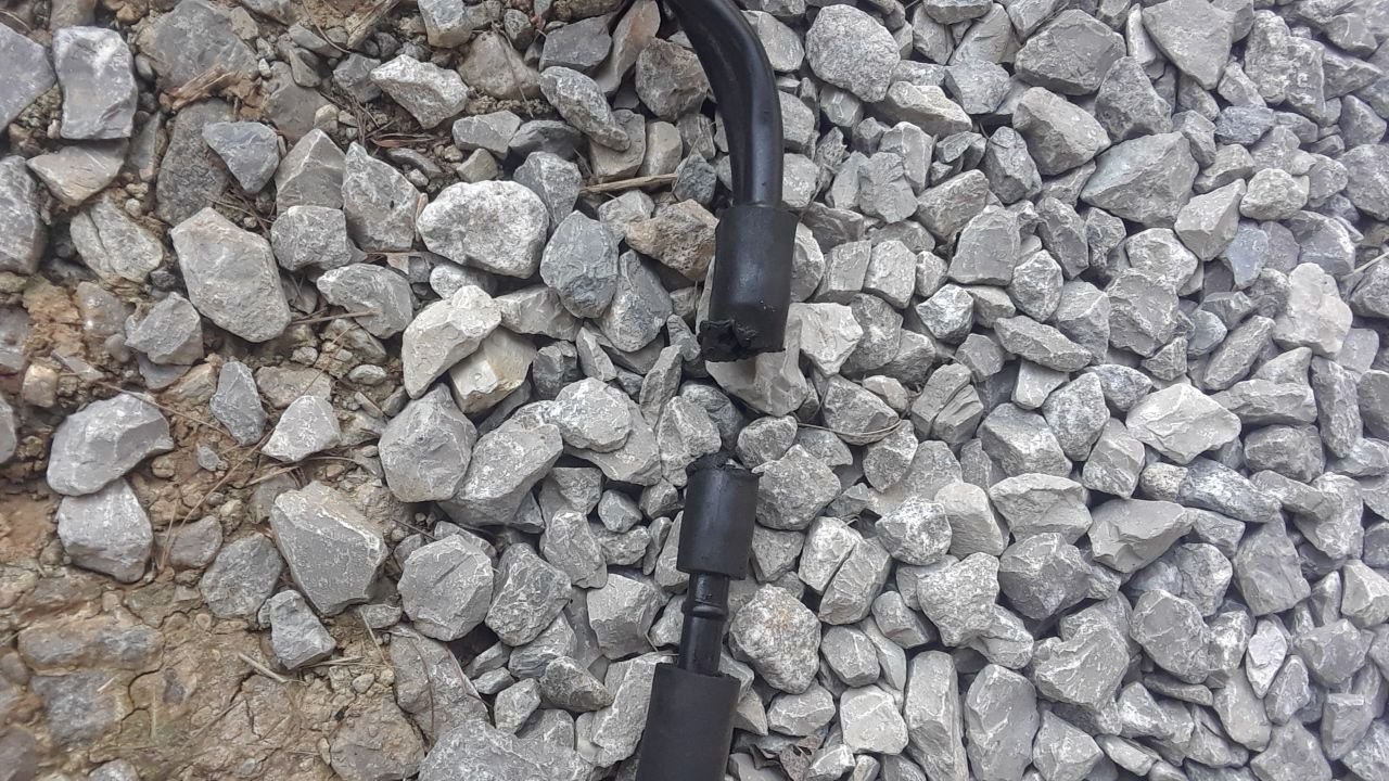

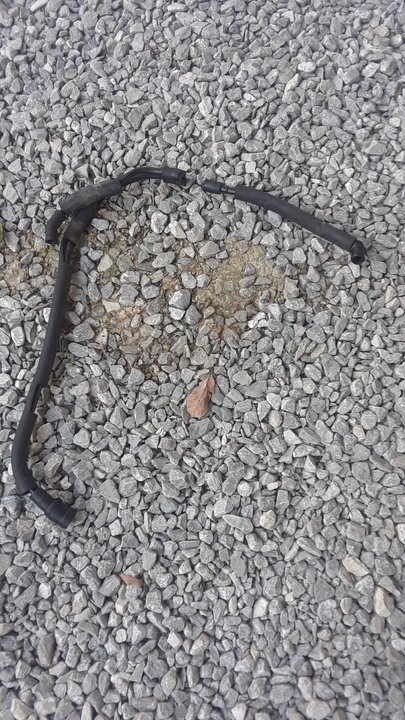

Well, I started disassembly for my ws6store hotcam, everything going smoothly so far. Used side cutters and trimmed the spikes above each valve cover, blew through all 10 coil pack mounting bolts in about 15min. Passenger rear bolt took about a minute which I was happy with after reading how much people fuss about it.
anyways the reason for this post is because the problem presented itself.
So yea, the way the hose was routed I couldnt tell anything was messed up. That definitely won't be effected by the carb cleaner method at idle.
so I'll be replacing that and things should be good! Just gotta finish the cam swap up.

Well I got the 3/8th heater hose and left the drivers side valve cover piece complete, slid a piece of hose on it and into a t fitting, from there ran a new line to the pass side valve cover and ditched the whole hardline, cut the hardline to the front near the pcv leaving about 5 inches and slid the hose over it from the T, then used the rest to do the line from the other valve cover to the the TB.
Idle is way better now, pretty much rock steady even with the hotcam, $8 well spent. Shes running pretty good! Glad I left the factory tstat in with the 30 degree temps we just got after a week of high 80's, heat is working awesome with new coolant!
