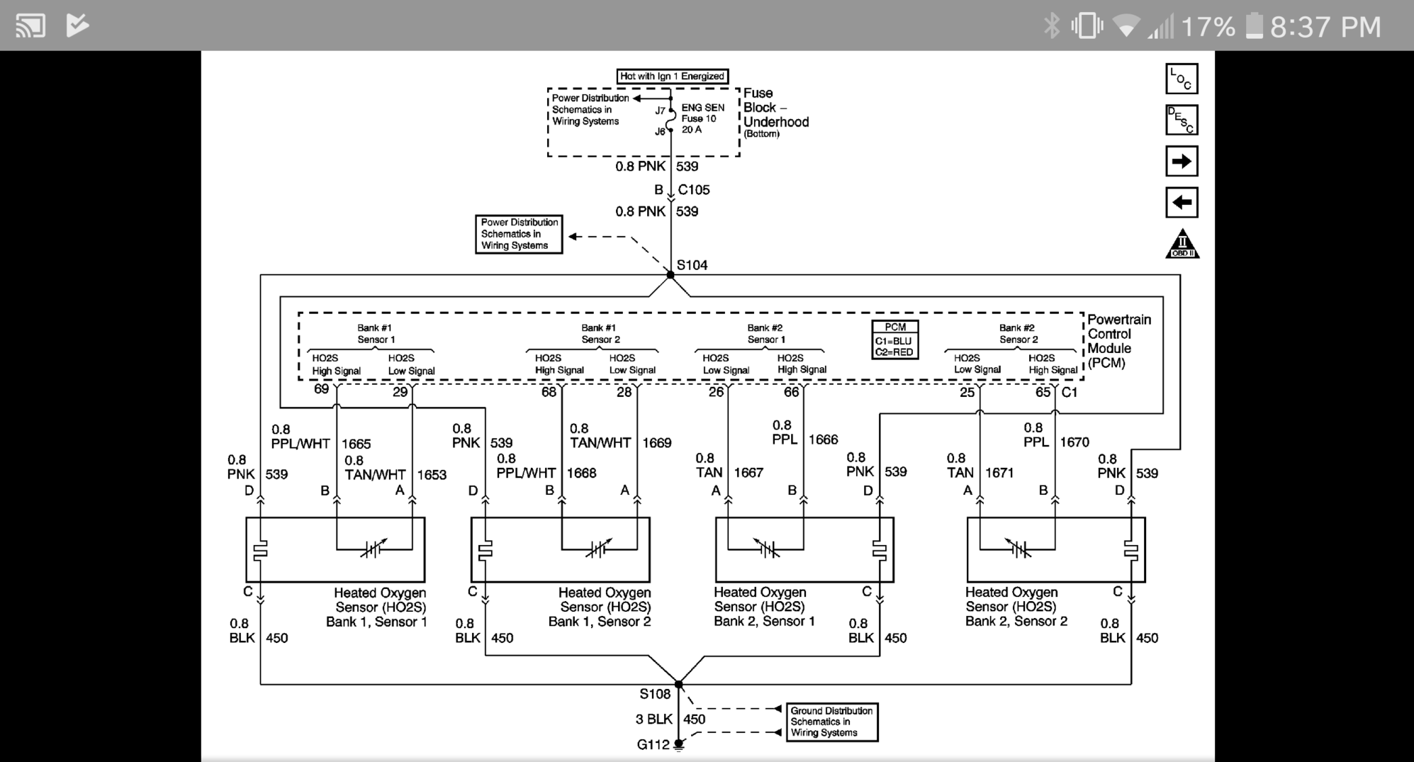

After i got G Atsmas' mssg I went and double checked a diagram i used. So my understanding is this is "ign. on, heated cuircut on" "ign. off, heated cuircut off". However your saying this should be temporarily on, could the ground be switched? Im pretty sure i grounded to chassis or block.
Old Aug 21, 2018 | 08:54 PM
Sabes's Avatar
Joined: Jan 2018
Posts: 19
The only other possibility seems to be switched ground assuming the heated circuit doesnt ground through the exhaust pipe.
Old Aug 21, 2018 | 09:10 PM
Sabes's Avatar
Joined: Jan 2018
Posts: 19
This one shows a pin 63 i may have missed it also attaches to engime coolant temp. Could that be my problem if i missed it?

Black is ground and pink is hot which powers the sensors. Purple and tan are the signals coming back from the sensors. You want to look at the power distribution schematic to see if the pink is run through a relay (which I'm pretty sure it is). The relay will only send power to the sensors if it's switched by another sensor (most likely a pcm signal or a temp sensor directly).

The PCM controls almost everything by the grounds. The coils, the injectors, the heater circuits for the O2 sensors - I don't know what that diagram is but the PCM needs to monitor the heater circuits. You should be getting codes with them connected directly to chassis ground.
