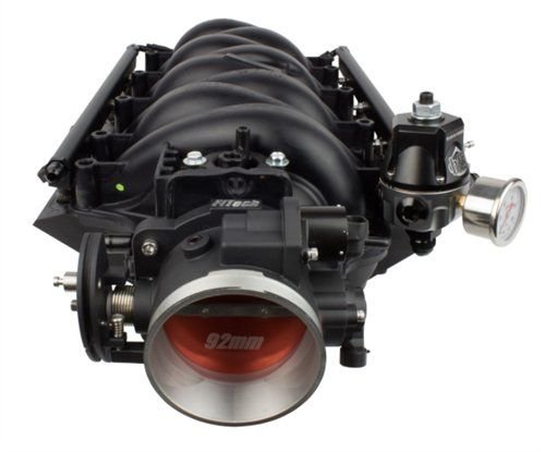

Comes with everything including injectors regulator and gauge for 799

I called them and they swear they did not use the Dorman intake
