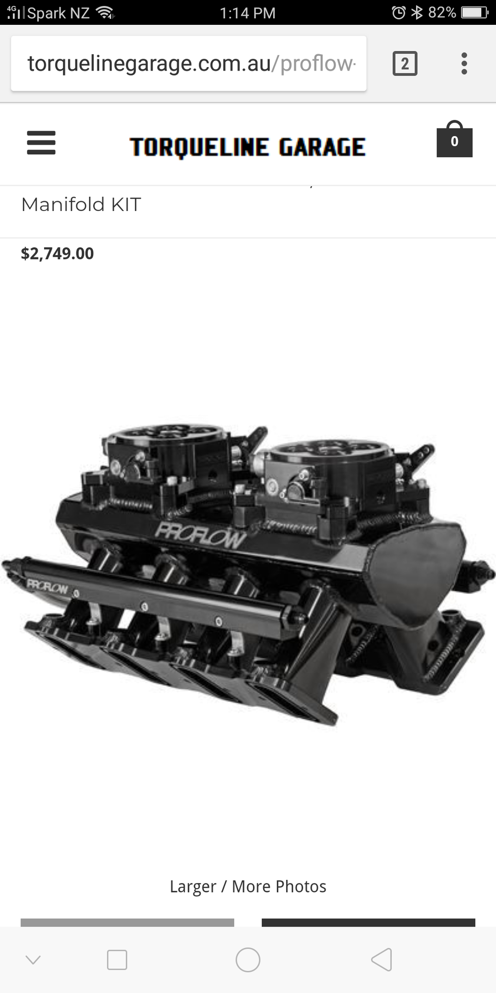

Hi there,
I have just purchased a high rise, dual throttle body intake to run on my 5.7l ls1. I have two 4150 throttle body's on it, both are 1000cfm. I am stuck on what injectors to run. Is there such thing as too big?
what does everyone recommend?
thanks

How is the rest of the motor set up? No matter what, a 346cu in. engine will NEVER EVER use 1000cfm. Why so much?

You spinning to 11 or something? 2,000cfm is a lot of air for a 5.7

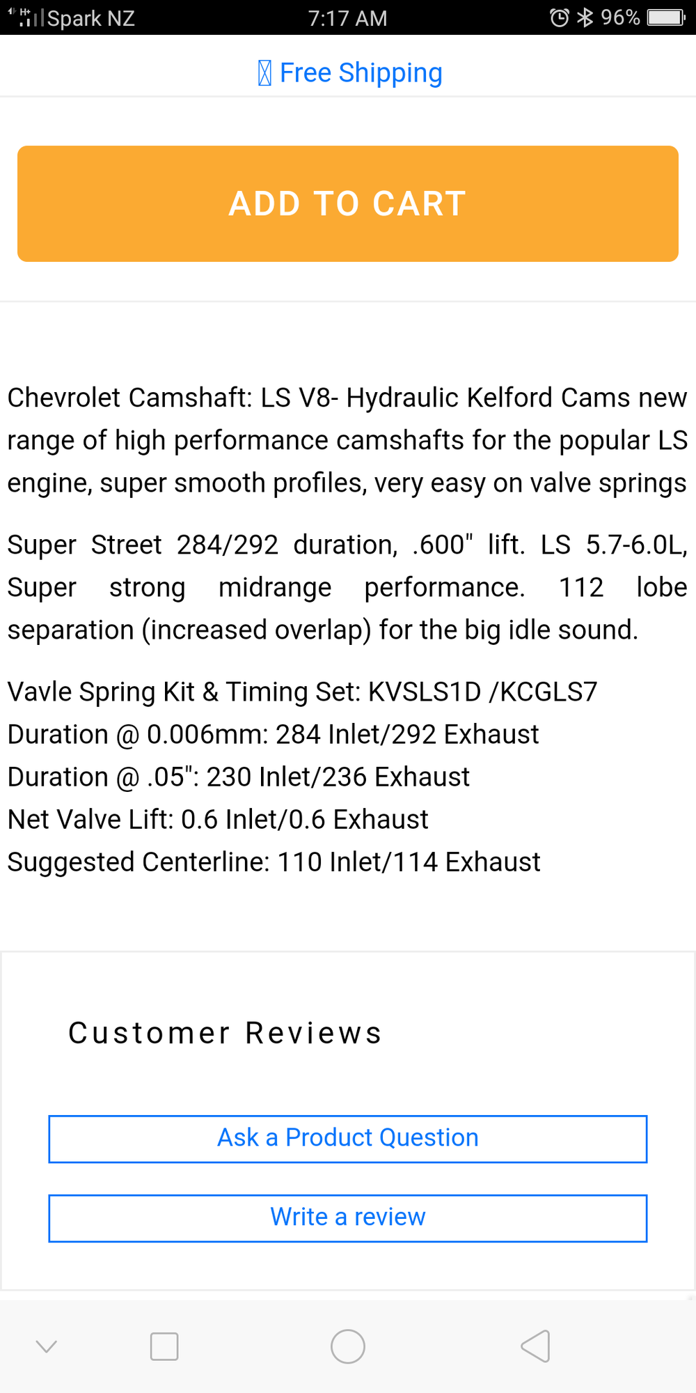

That's just the size of the throttle body's that came in the kit I brought. I thought they were 500cfm each, not 1000cfm each. I have this Cam, also I have 3 inch headers and I am in the process of finding the right heads to get as well.

You guys are missing the point here! He got that "(increased overlap) for the big idle sound"! Big idle sound demands big airflow!
