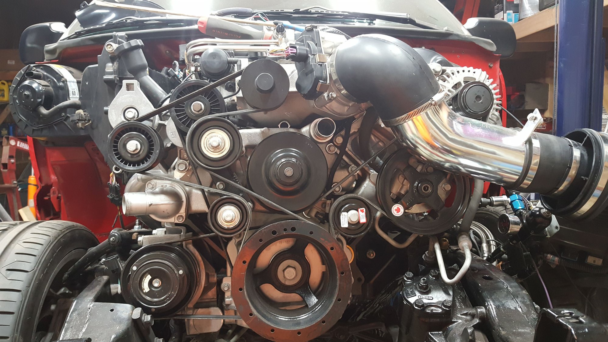

You have to be careful on your choice when installing in a S10, Low mount A/C compressors will need the frame notched to clear. You also have to be careful with the drivers side configuration because you have the steering box. I used gm Modified LSA Accessory Drive kit but I'm also running the LSA supercharger. You'll probably find the info you need on the S10 forum they have an LS section.
Here is what my setup looks like.
