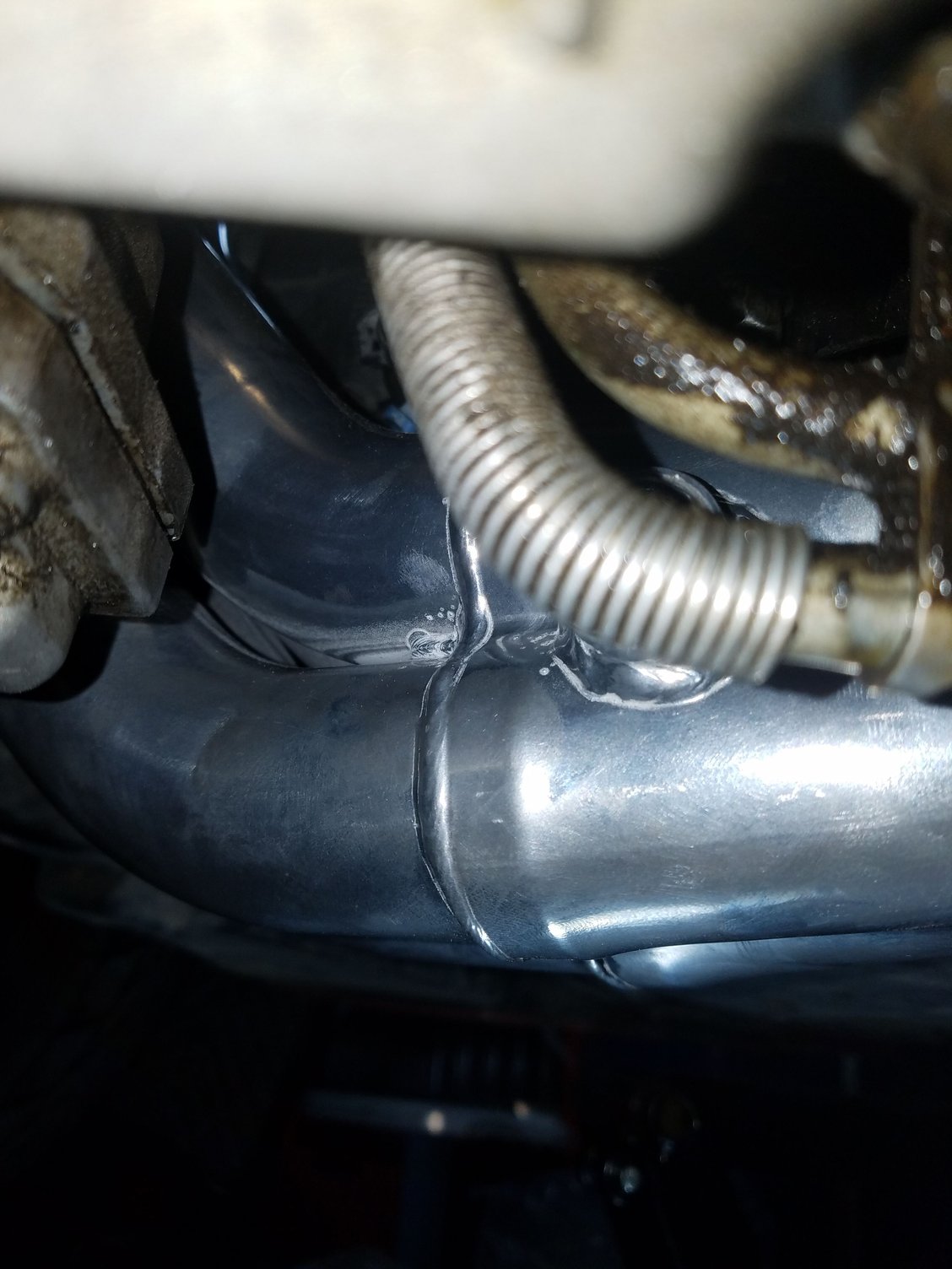

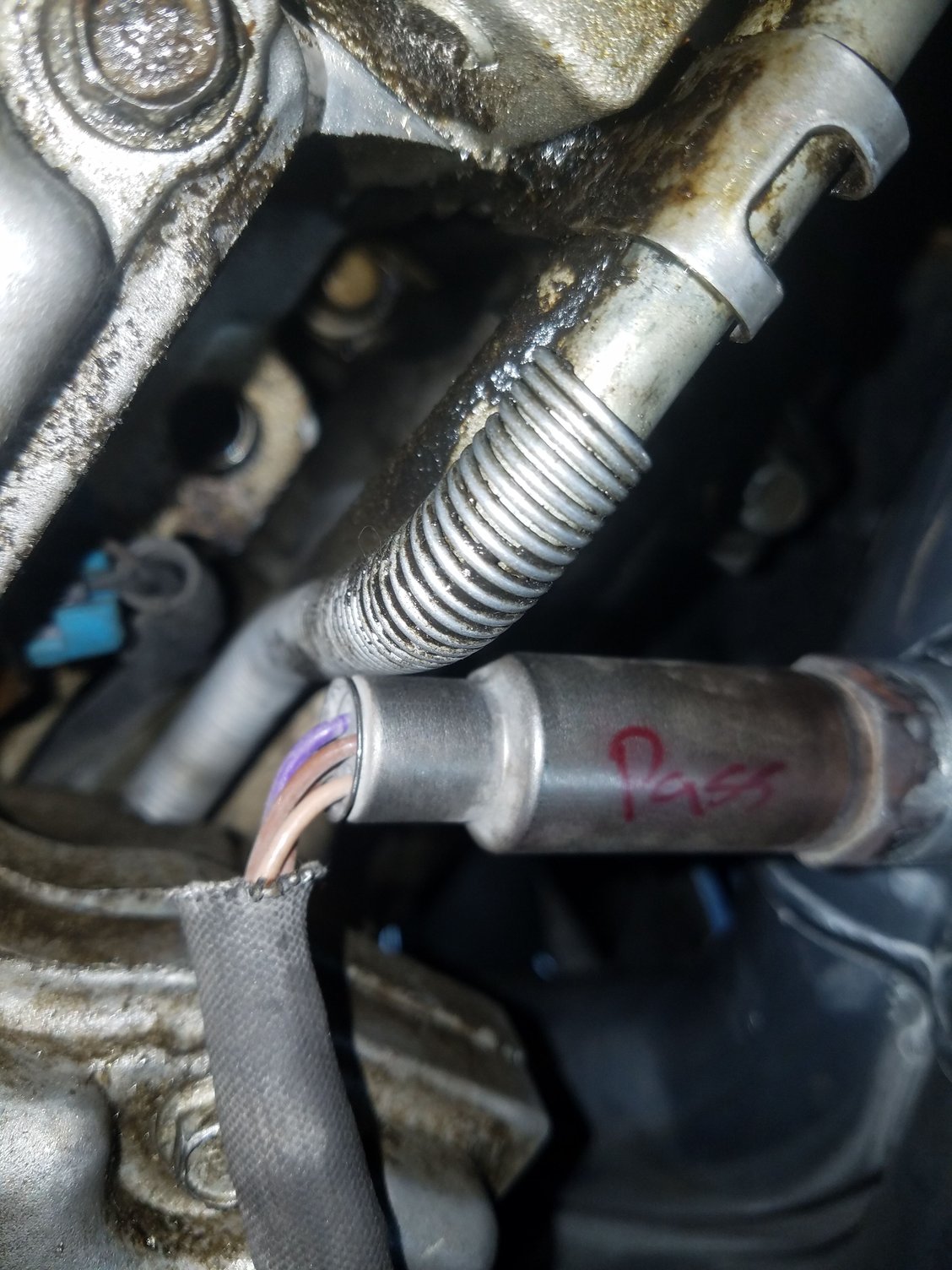

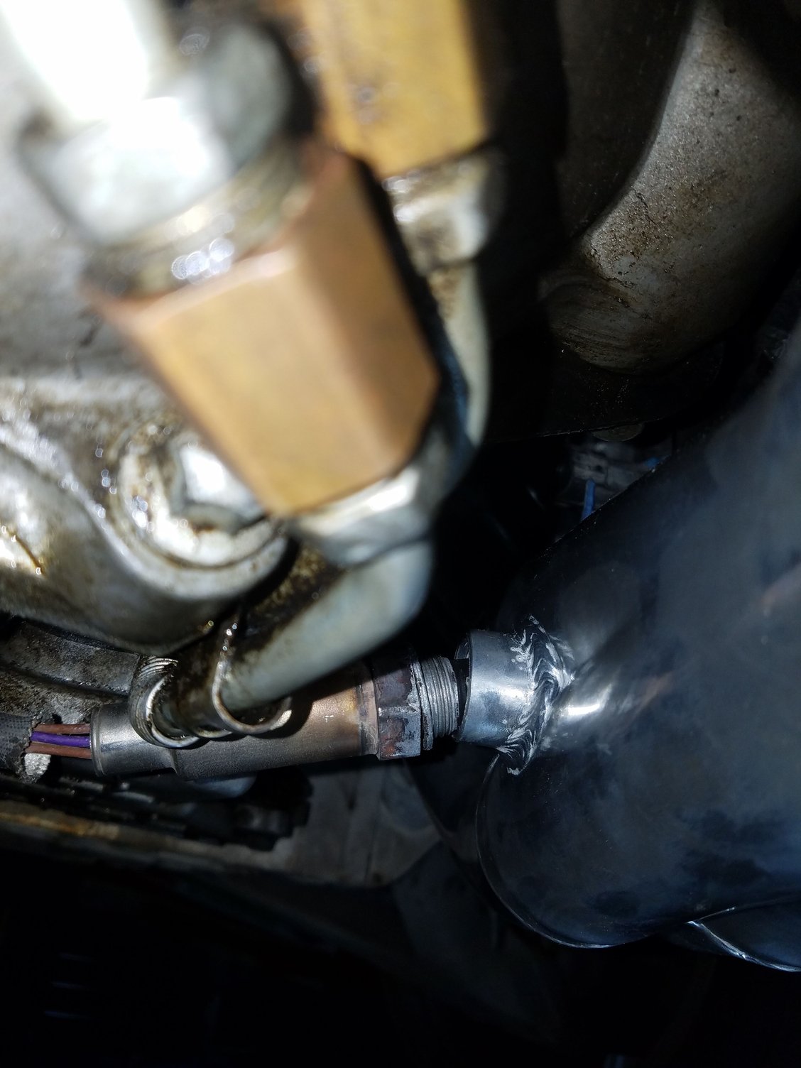

I see that the C6 kits apparently come with a modified bracket to move the lines, but that seems to be because they actually touch the header themselves. My issue is with the passenger side header bolted tight, there is absolutly no way that the O2 sensor will be able to be installed. I have unbolted that bracket and attempted moving the lines around, but anything I gain in clearance for the sensor I lose in rubbing against the starter and other places still without being able get the sensor in. Clearance around the rest of the headers is great, the O2 wiring on the car side will need to be secured back from the header, but otherwise all else is good.
Anyone have a solution for this? Kooks tech support obviously said he had done hundreds and hundreds of these and zero issues with those installs. Period. Not seeing the possibility of that based on this install.

Look on ebay for oxygen sensor spacers. Maybe a 90 degree spacer would solve your issue.

Really stupid question on my part and no disrespect is intended, can the O2 sensor be screwed all the way in and seated before slipping the header into place and bolting to the motor? There are a lot of threads showing and being seated could help reduce the length and fit issue.
Not all O2 sensors are exactly the same size. There a little variation in length and width. Noticed this when I replaced 02's on my 99 TA. I'd measure the length of the O2's sensor and go to the local auto parts store and ask to see several different brands of O2 sensors and measure them. You might find one that's a little shorter. I don't know if that will get enough clearance but it may help. I would replace both O2's with the same brand as they can have a slight variance I how they read voltage. I memory serves the Denso O2's were a bit shorter than the set of Bosche 02's I replaced on my LS1. Not sure if LS2/LS3/LS7 use same sensor.
What year is the car? If the car is an older C6, have the motor mounts been replaced? Over time they can compress and cause various issues with header installs. This is also true on other cars too.
Are you sure they are actually Kook's headers? There are several off shore knock headers that have been passed off as Kook's in the past.
If the headers definitely are Kook's, have you considered asking them for a replacement header? There can be some variation with any product.
I would call Kook's back and ask to speak with a different customer service representative. There is definitely some variation in those as well. The lady that often answers the phone is helpful and should be able to get you in contact with the right person that can help.
FWIW - I have 1 7/8 headers Kook's on my 99TA, they fit nicely, much higher quality product than the Hooker LT's previously on the car.
Best wishes on getting the C6 header install sorted out.

The car is a 2002, and they are definitely kooks as I purchased straight from them and not a middle man vendor. If I screw in the sensor before lifting the header into place, the header jams up against the heat shield and still against the lines. Hopefully they'll be open to sending another header, but I had mine jethot coated so with the way I've been essentially dismissed already, I'm betting they wont. Guess I'll see what happens Wednesday after Christmas...
