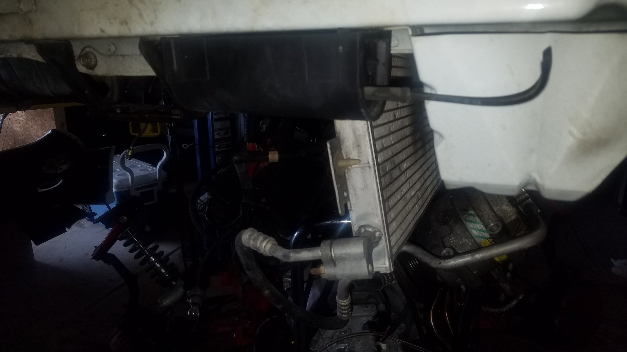

tore apart car preparing for new motor. Found this vacuum canister and looks like the hose was sliced. Anyone know where it should hook up to?
Vacuum canister front pass side by horns and fog light

Routes to a T by the pass-side firewall near the A/C hoses. Acts a a reserve to help open/close door to shift blower motor air from/to floor/vents. This topic/question has been beaten to death...search at least once next time, richard cranium.

hi Chris. Thanks for writing. I am the OP and responder. I felt like an idiot since after not receiving any response I searched vacuum diagram and this vac can was clearly spelled out in several posts as old as 2006. I should have searched before posting. Thanks again
