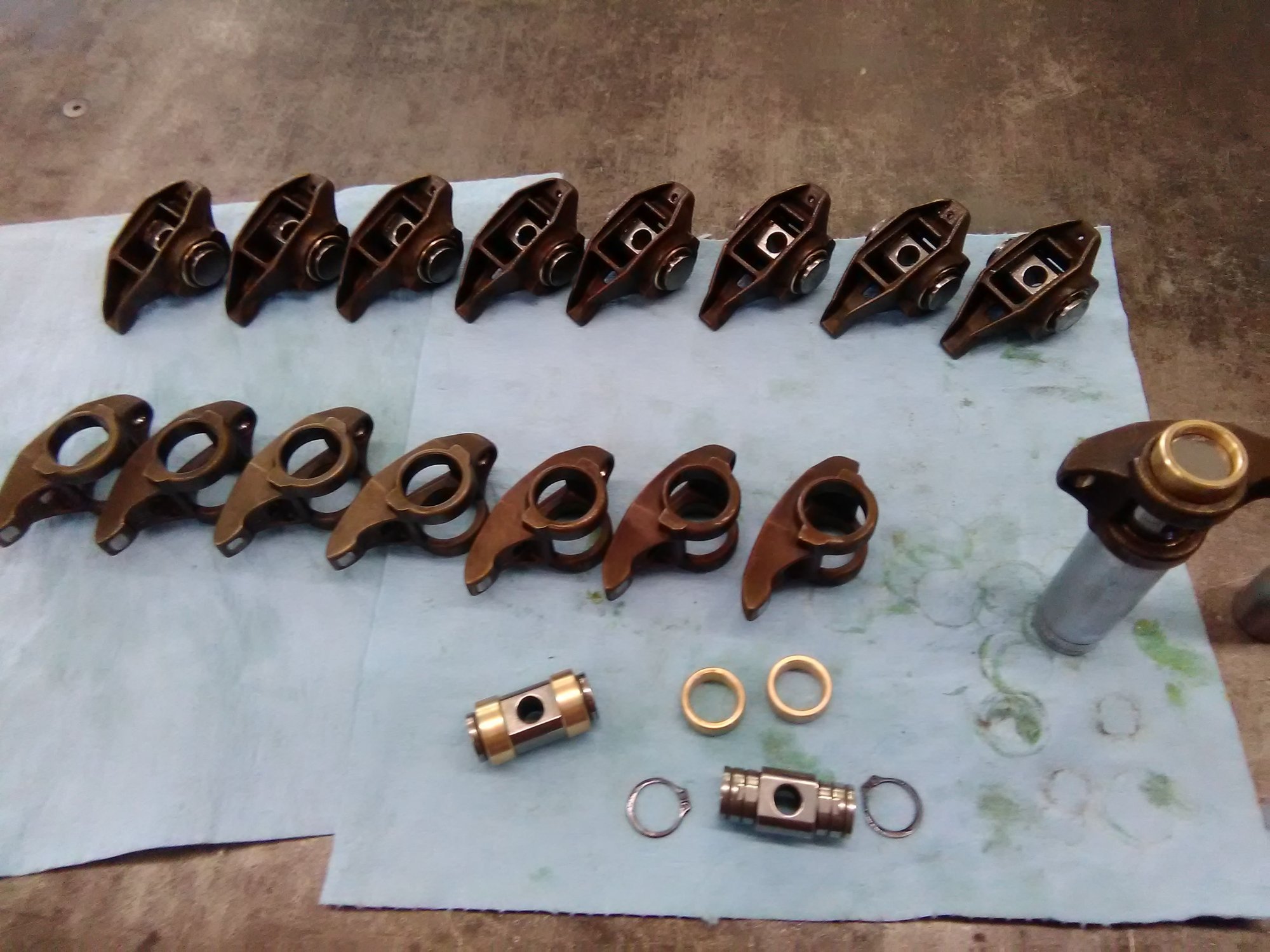

thanks for the replies! Looked at numerous kits and was surprised to find that a few are using "captured needle" bearings. I'm going with a bushing type, to totally eliminate the needles. Going with either Straub, or CHE. Purchased the tool from Summit, so now just need to box up the heads to send out for rehab.

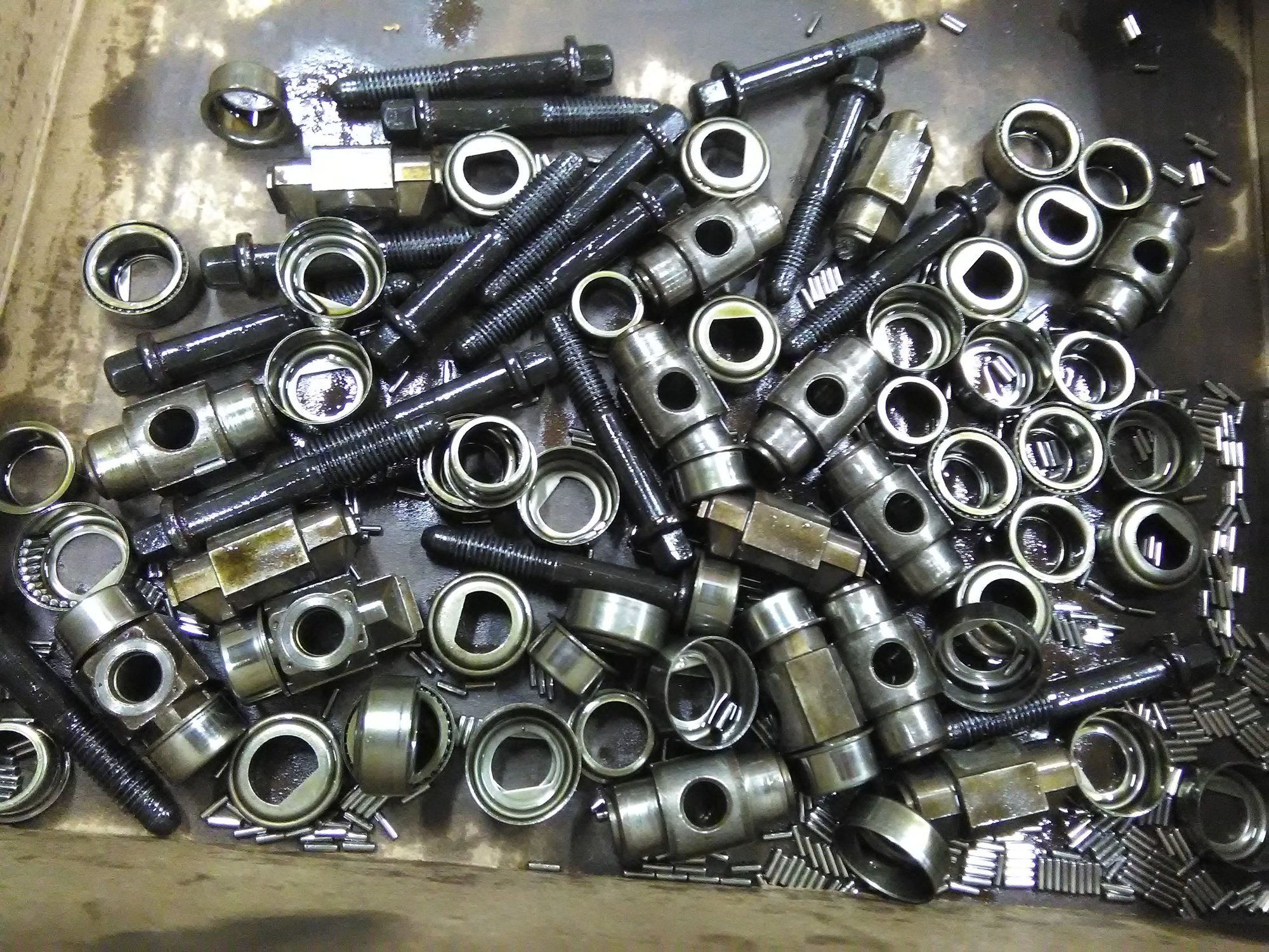

Have used 3 sets ove summitracing retrofit trunnion kits, so far . P/n SUM-141560. It's a re-boxed straub kit. Two of them have over 10k miles. Been flawless so far. Had to pull one due to a broken spring. Pulled apart rocker just for the hell ove it. Looked absolutely perfect ... I suggest take your time and install with common sense and you really can't go wrong with any ove the options you have.che/straub/summit......

That's alot ove needle bearings. (Dismantle)
Much better. Hell I used sockets and a hammer. Just finessed it...

Received the tool from Powerhouse yesterday, will break rockers down tonight. Going to clean them up at work, have a mold shop there so I have access to soda blaster, ice blaster, chem tanks, washers, etc. Give a good inspection and go from there. Leaning toward the Straub kit.

LOL, gotcha. Ended up using diluted purple power and a brass brush. They turned out great. Thanks!

Ended up using Smith Brothers kit. Very pleased with it. Press in bushings installed effortlessly using Lucas assembly lube.
