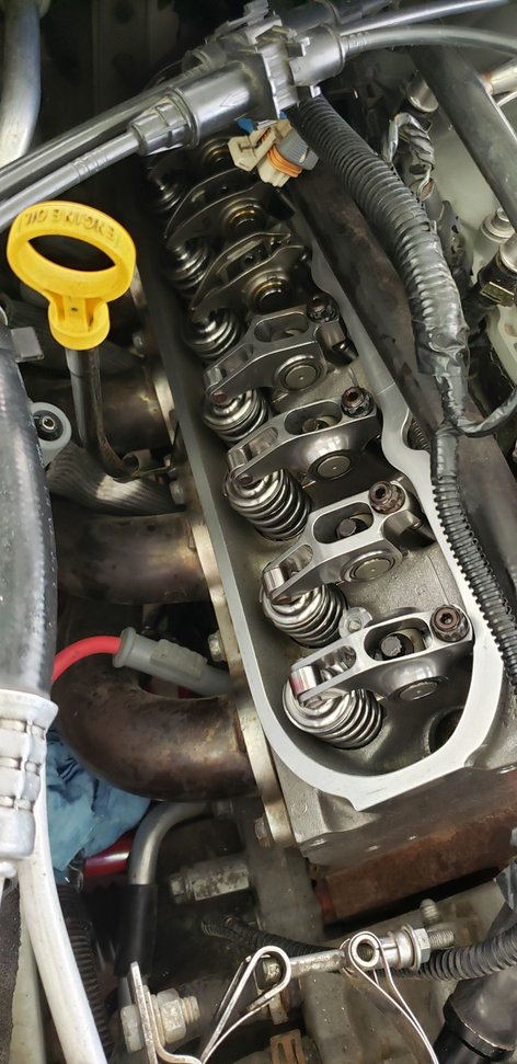

Had to do some minor clearance to the head for the exhaust rockers on the 7 and 2 cylinders but if I do run into leaks then I'll have some 1/2" spacers for sale.

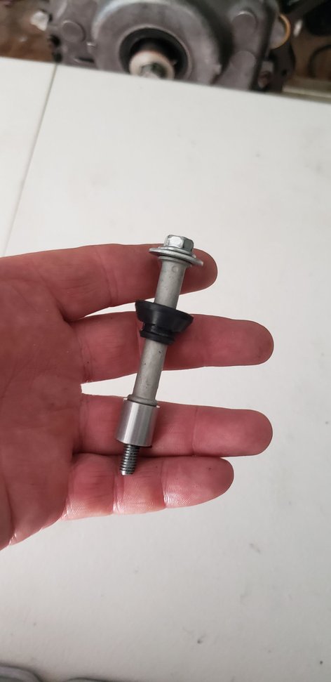

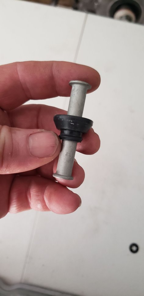

For those inquiring minds here's what I came up with.

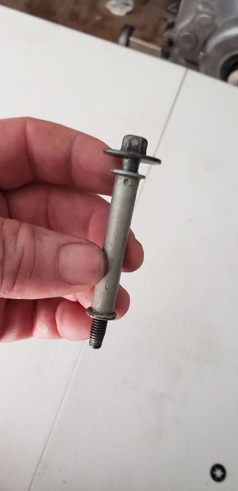

Stock bolt and sleeve.

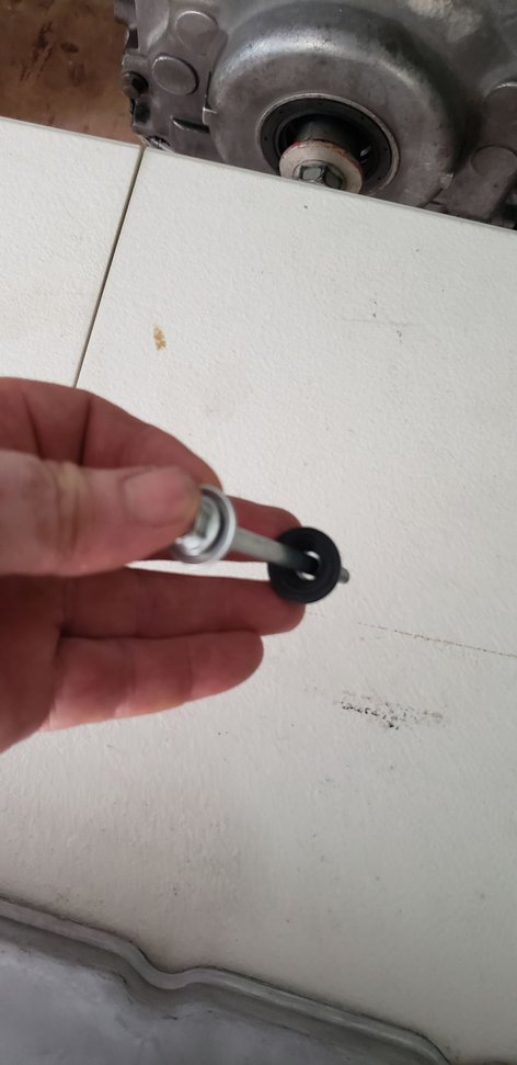

ICT Billet valve cover bolt and washer.

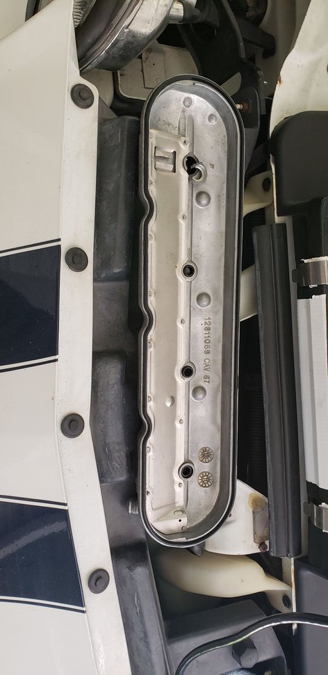

This was how I was instructed to install on the valve cover. The washer would seal everything up but unfortunately once I reached 50 inch lbs on the torque wrench it cracked the casting where the grommet sat.
ICT had sent me this to resolve the matter.
Removed the sleeve from the stock bolt.
And it should look something like this when all isd said and done. Well I don't know about you but I don't like the fact that this aluminum spacer is held into place by a washer that will only fall off and down into the head perhaps the engine once removed.

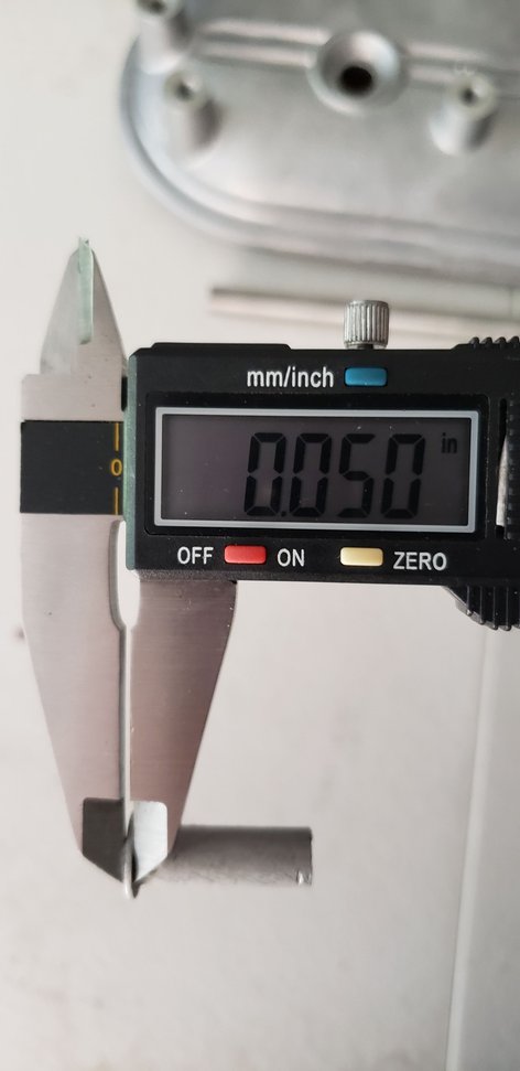

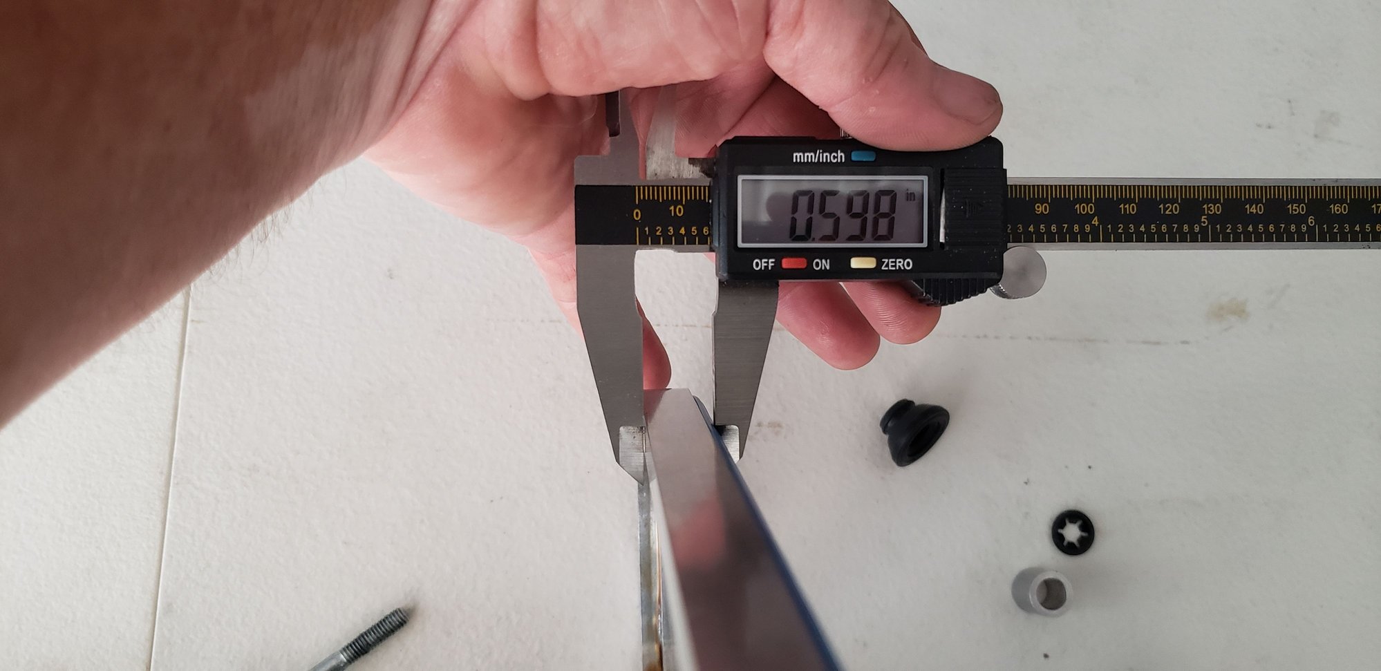

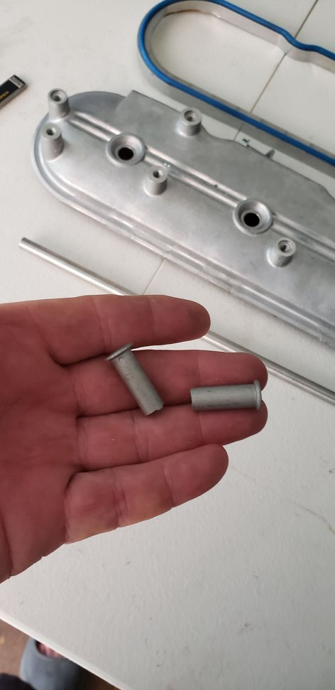

Okay now for my solution to this.

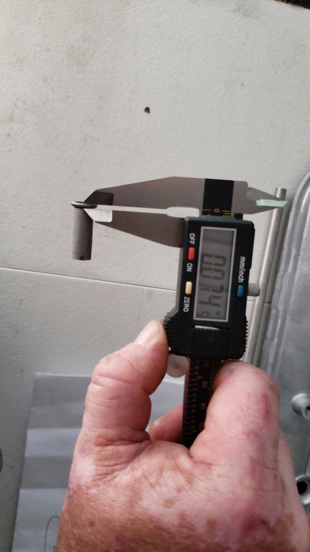

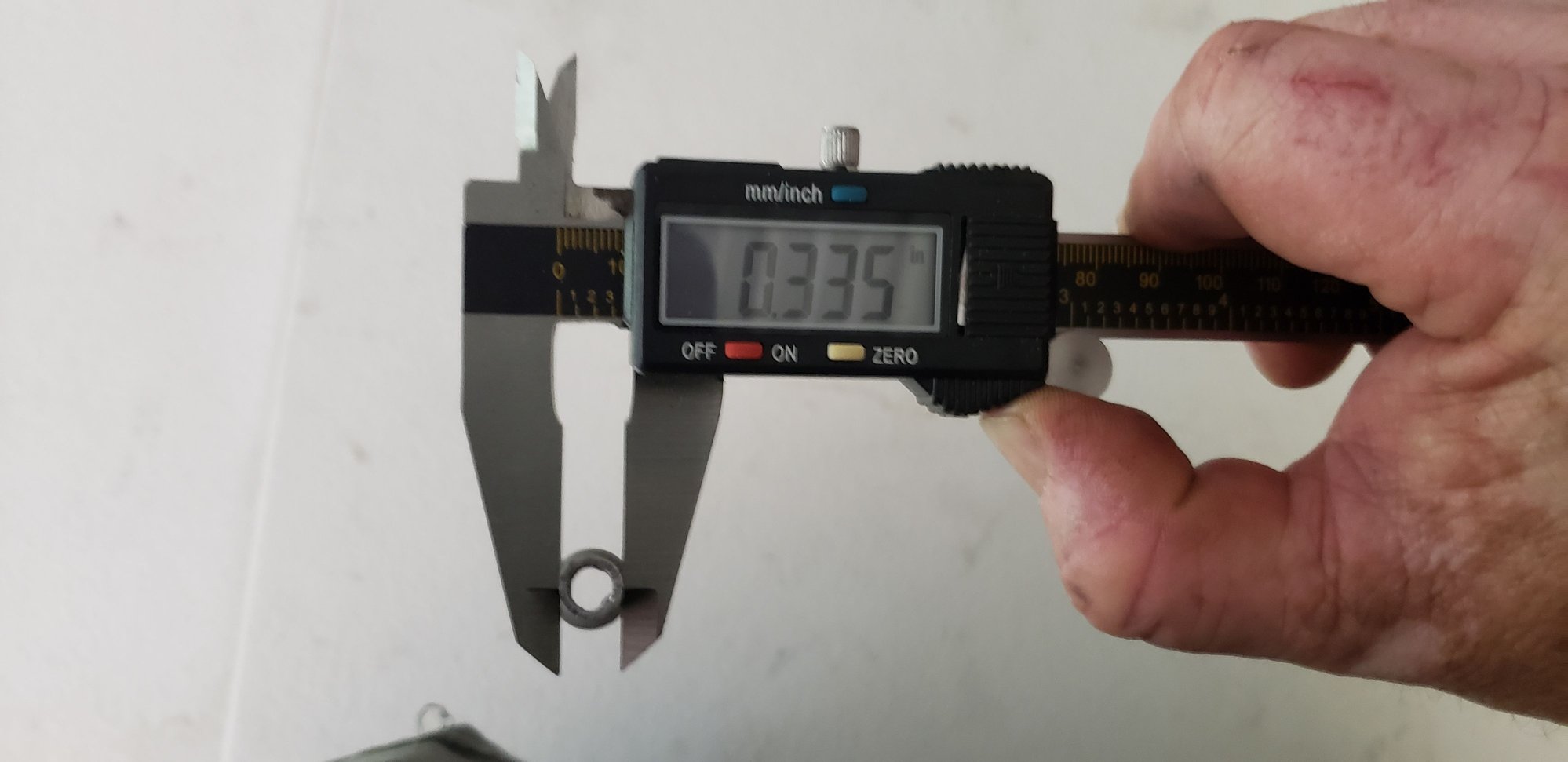

Stock sleeve.

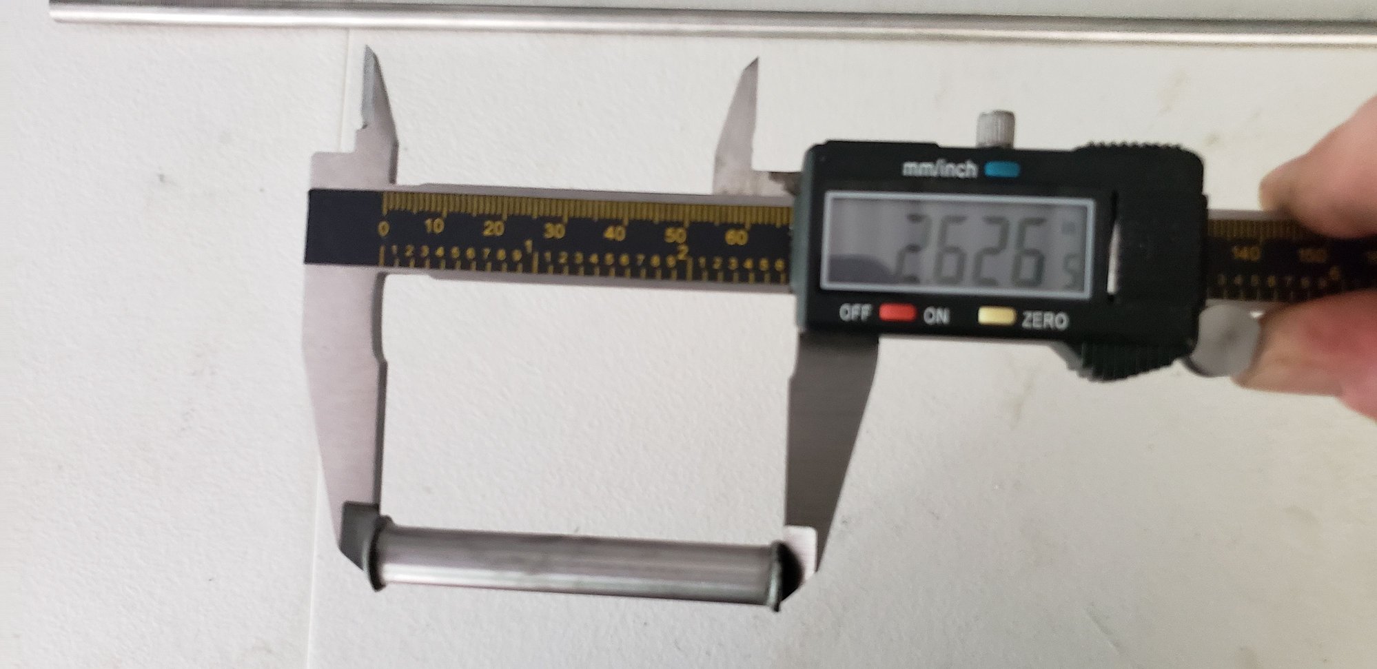

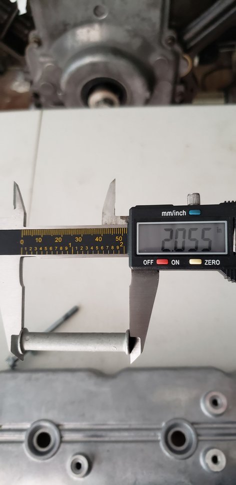

Thickness of the top of the sleeve.
Thickness of the bottom of the sleeve.
Thickness of the spacer and gasket.
OD of the sleeve.

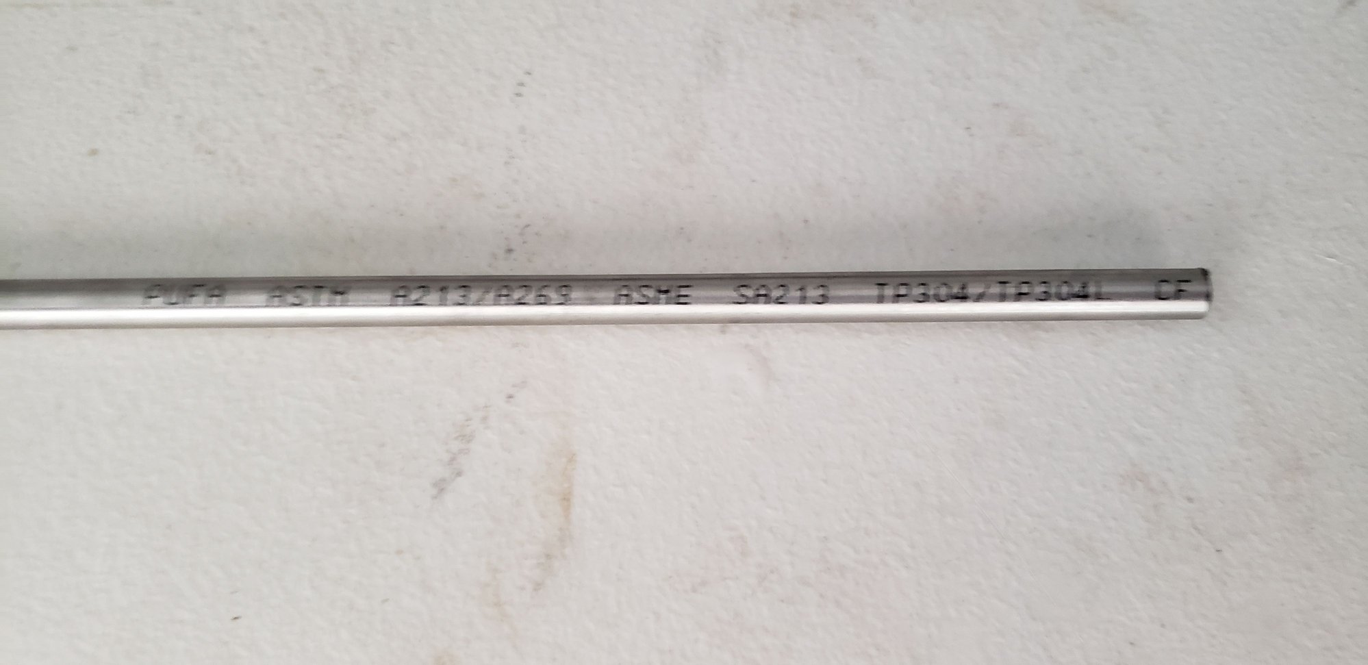

Now to figure out what size the tubing needs to be cut.
Some .375 OD .335 ID 304 SS tubing.
My new sleeve
This will not fall off into the motor when I remove the bolt from the valve cover.
