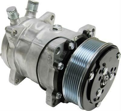

is it the Sanden 508? if so, thank you
look something like this?

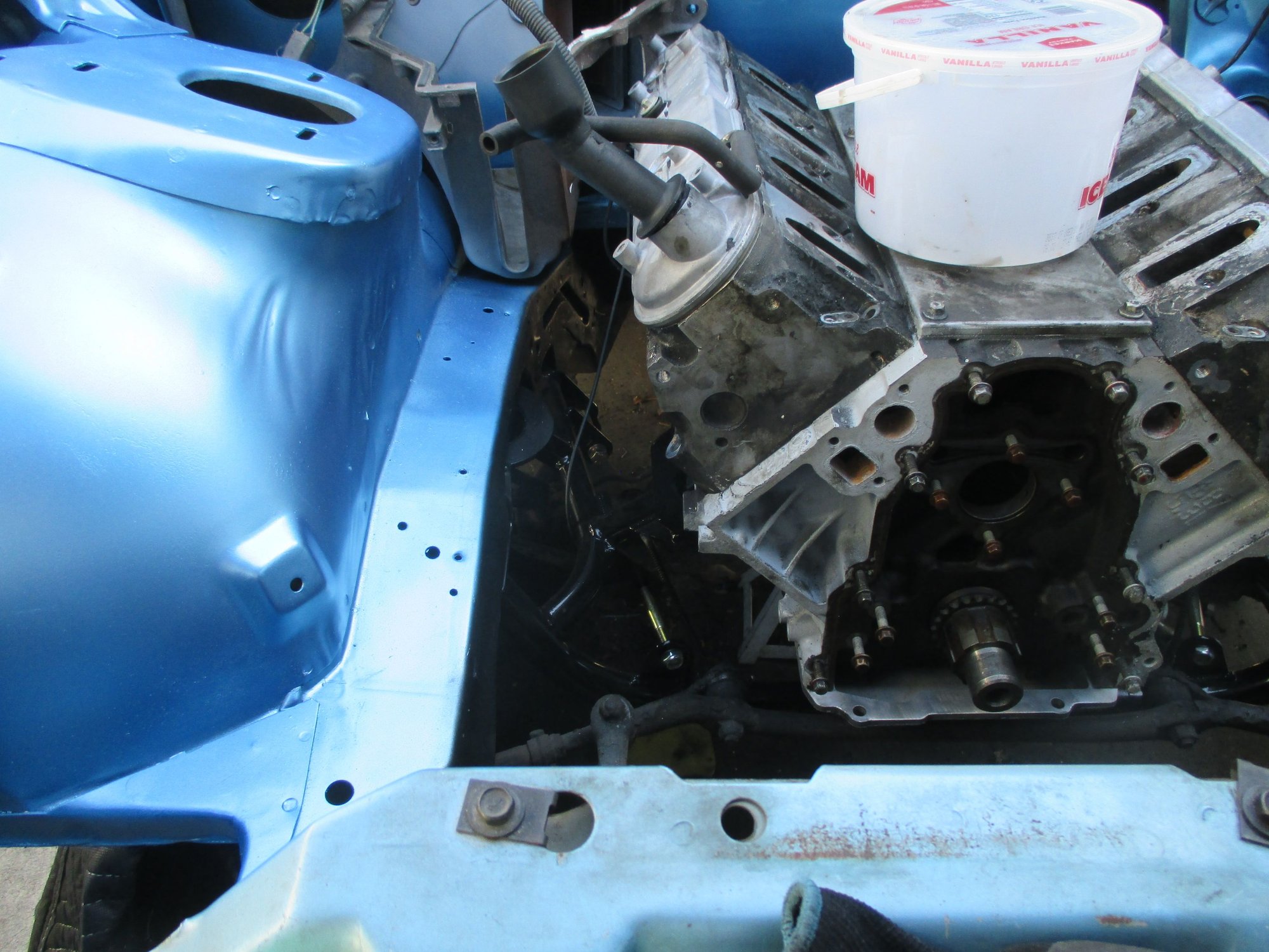

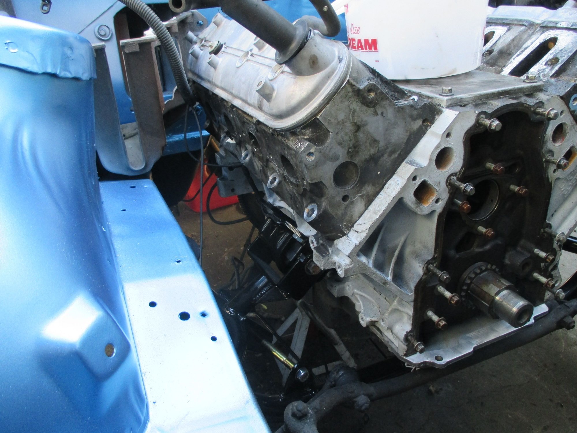

wont have upward headers. having some made. been lookin at the whole thing these past couple days theyll pretty much be a block hugger header on the passenger side cross in front of the oil pan and up to the drivers side. turbo will sit behind the drivers side headlight. need to get a mini starter now.
1st pic is where the downpipe is going to go. that pipe sitting on the tape is a half inch bigger than what im goin to run.
2nd pic is where the cross over is gonna go from passenger side to drivers side.
