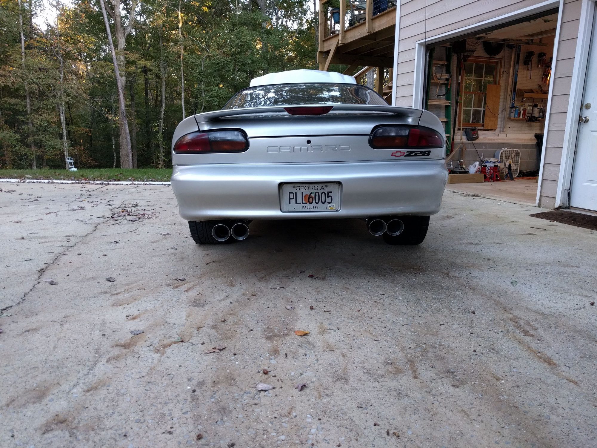

Just wanted to post my experience with this system... I was very impressed with everything (especially for $340 shipped)!
https://www.ebay.com/itm/Quad-Tip-Tr...53.m2749.l2649
My car has an LQ9, TSP 228R 112lsa, an unknown set of headers, no cats and 3" pipe back to a Magnaflow muffler. It didn't sound terrible, but I did not like how much rasp it had. After a couple of times removing and reinstalling everything, some of the pieces of pipe were pretty beat up and I had a tough time getting rid of an exhaust leak (and I just wanted true duals). So I went ahead and pulled the trigger on this kit.

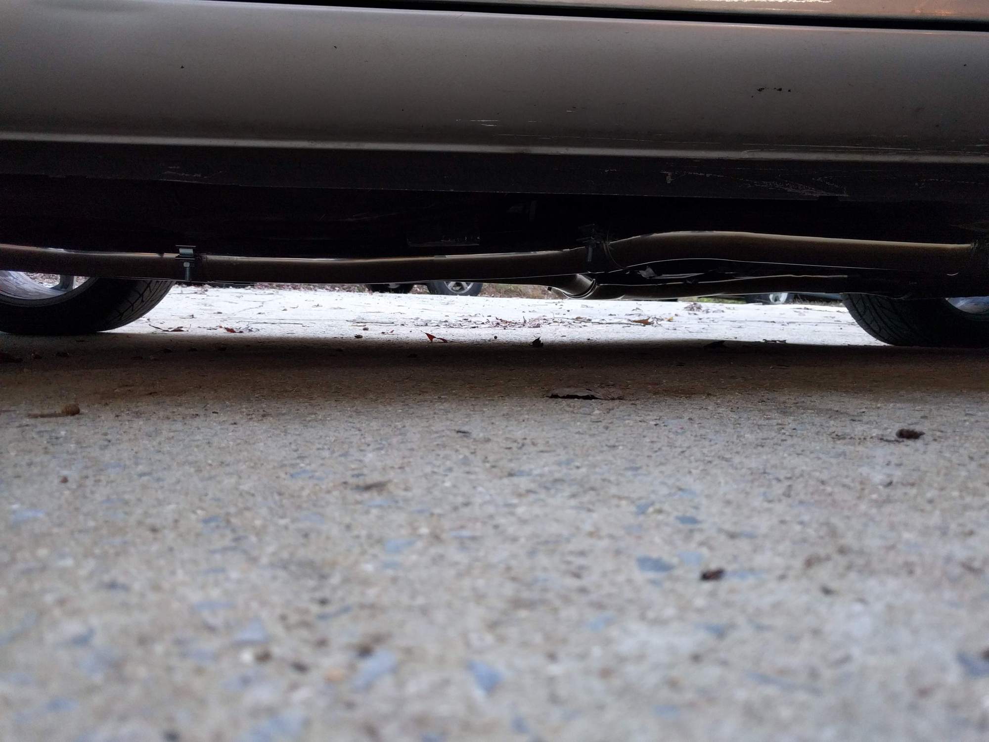

I ended up using the whole kit and didn't have to replace any hardware or anything. It took a long weekend to get it installed and mostly adjusted (including the panhard bar relocation kit). I was able to get it tucked up pretty good and I am happy with the ground clearance, though I think I need to do some more tweaking because some spots are hitting the body. I'm not a huge fan of how big the quad tips are and they definitely need some more adjustment (I probably spent the most time back there). The driver side sticks out further than the passenger side and it is also lower. I ended up not using the rubber isolators on the hangers in favor of some heater hose and hose clamps in order to get everything higher up.
These pictures are from before I drove it any significant distance so I think it's settled a little bit lower, but nothing drastic like some of the stories I've heard.
Here are some videos of before and after... though the phone really doesn't pick up the difference. The true dual is ALOT louder (duh!)... though I wasn't prepared for how loud it actually is. Standing next to it while idling, you can feel it in your chest! I can't get these to embed so the link to the album will have to do...
Exhaust Comparison Videos
My android phone wouldn't record anything over 90 some dba's... which is probably why the videos don't show much difference. So I used my work iphone to get these decibel readings... it's just running through the gears going up to 4500ish rpms (similar to the interior videos). As you can see the true duals are much louder!
I'm planning on getting some cats put on to quiet it down some... I feel bad for my neighbors when I leave at 5:30 in the morning! Whenever that happens I'll get some more decibel readings for comparison.

That ground clearance is great!! Did not expect that. Am I the only one who think eBay kits have stepped their game up? Not just exhaust, but with turbos etc.?
