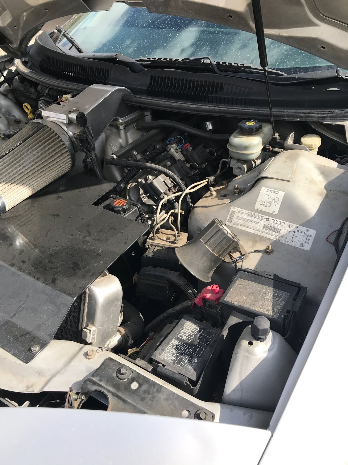

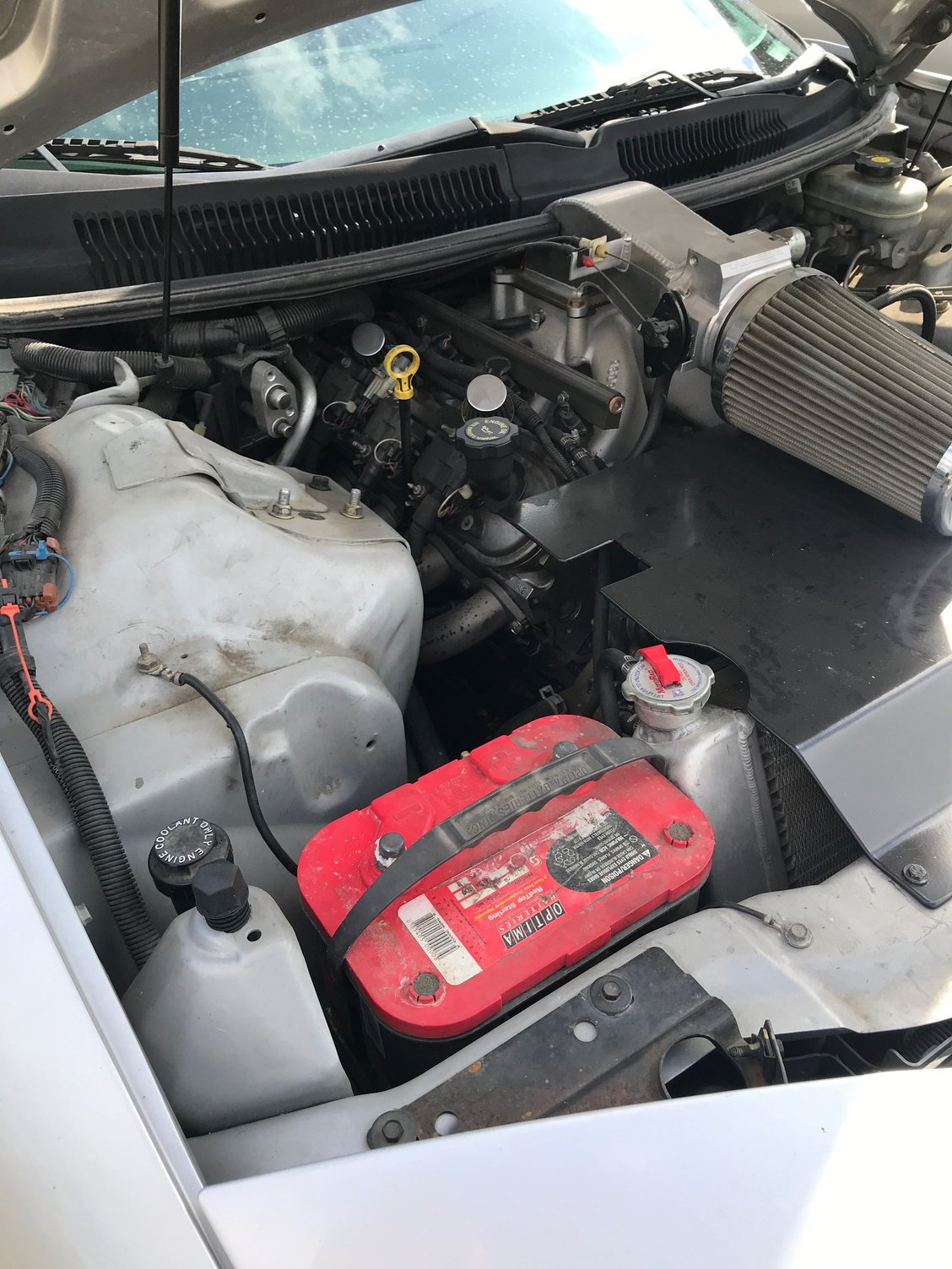

How’s it going I have a iron block 408 11.5:1 compression 248/248 .609/.603 108 cam, 243 heads that have been ported. Currently running a super victor intake with a custom sheet metal elbow and a 102mm throttle body. I know the elbow is killing power big time. I’m looking to switch either to a fast 102 or a msd atomic. Car is a 6 speed with 4.11 gears in a 12 bolt. Currently making 443whp. Car is a street car that will see the strip once in a while. What intake do you guys recommend and why?
