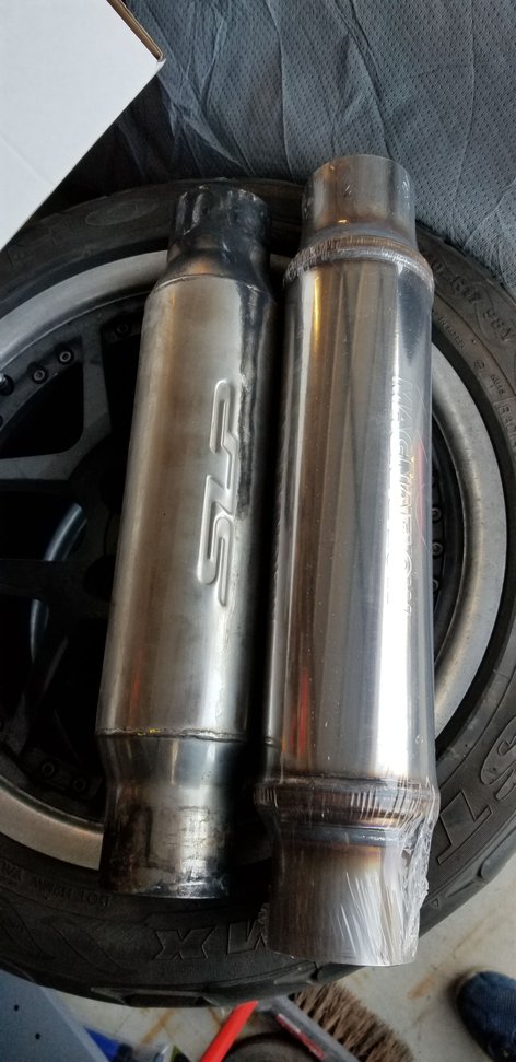

For anyone else wondering about this, here is a pic of the LM1 and the Magnaflow 14419. The Magnaflow is a bit longer, might need some trimming on a pipe or two. Just a heads up, it may not be a direct swap. I'll see how it goes likely tomorrow.

Also, the 14419 is 3" ID on both ends where the SLP is 3" ID on one end and 3" OD on the other end so it won't directly mount up to your pipe going over the axle. You'll need a 3" OD coupler to join the two pipes together.
