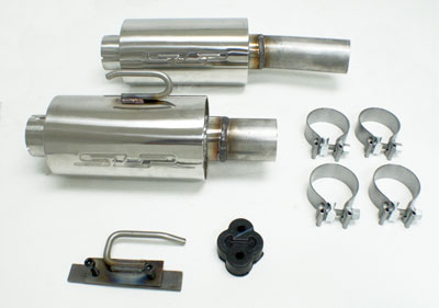

The SLP PowerFlo conversion for $300 just replaces the rear section of the exhaust. This will sound the best... and quiets it down quite a bit vs the LM II. And a lot compared to the LM.

I have some of the SLP Powerflos that I am no longer using. They sounded great and finally made my car quiet enough to enjoy. Go to YouTube to look at sound clips. I am selling them because I am no longer using them. Message me if you are interested.

Do the powerflo. I was very happy with that setup.
