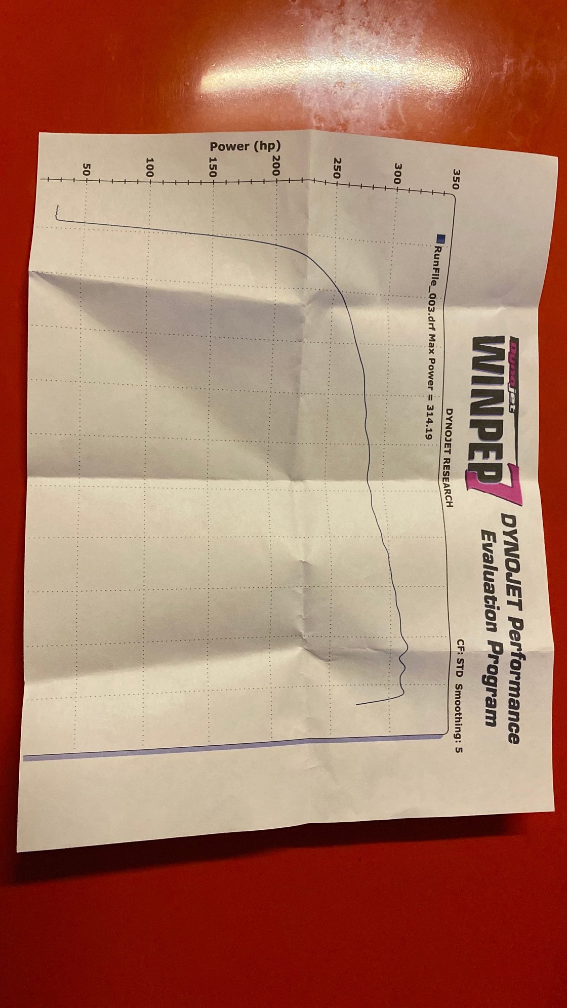

Finally got the tune done, thanks to anything automotive and performance in Denton TX. I’m not making the power I hoped for but I have a solid running car and some direction on why. The biggest thing is the 3500 stall not really making power until 4K. Currently I’m at 314hp at the wheels per the dyno but I think it’s about 390/400 without the slipping. Any thoughts and or advice?

That seems low to me, but hows it drive?
On a mustang dyno I did 330 through an unlocked stall, which shouldve been 360-ish on a dynojet. I have long tubes, true duals, stock intake, slp lid,ws6store hotcam which isnt all that big. I was told 330 was low, but I still think my car can go 11's with good tires.

It pulls hard way up in the power band. 4K and up its hauling. I see the graph flashes almost vertical. I guess we will need to track it.

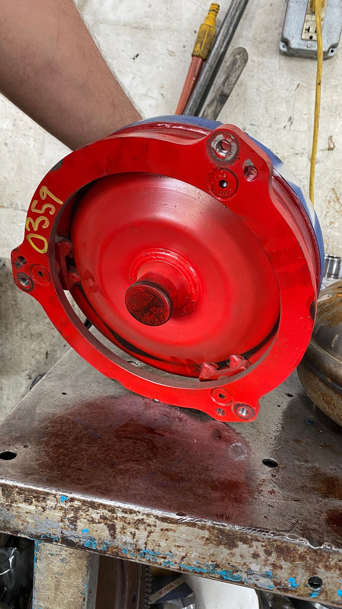

Well you were correct, tranny gave up 4300 miles after tune. I don’t know what brand stall this is but I replaced it with a Boss Hogg 3200-3500 stall. If anyone knows please educate me!
Who in the DFW recognize this converter?
Who recognize this converter?

That sucks. Good luck with getting it fixed and back together.

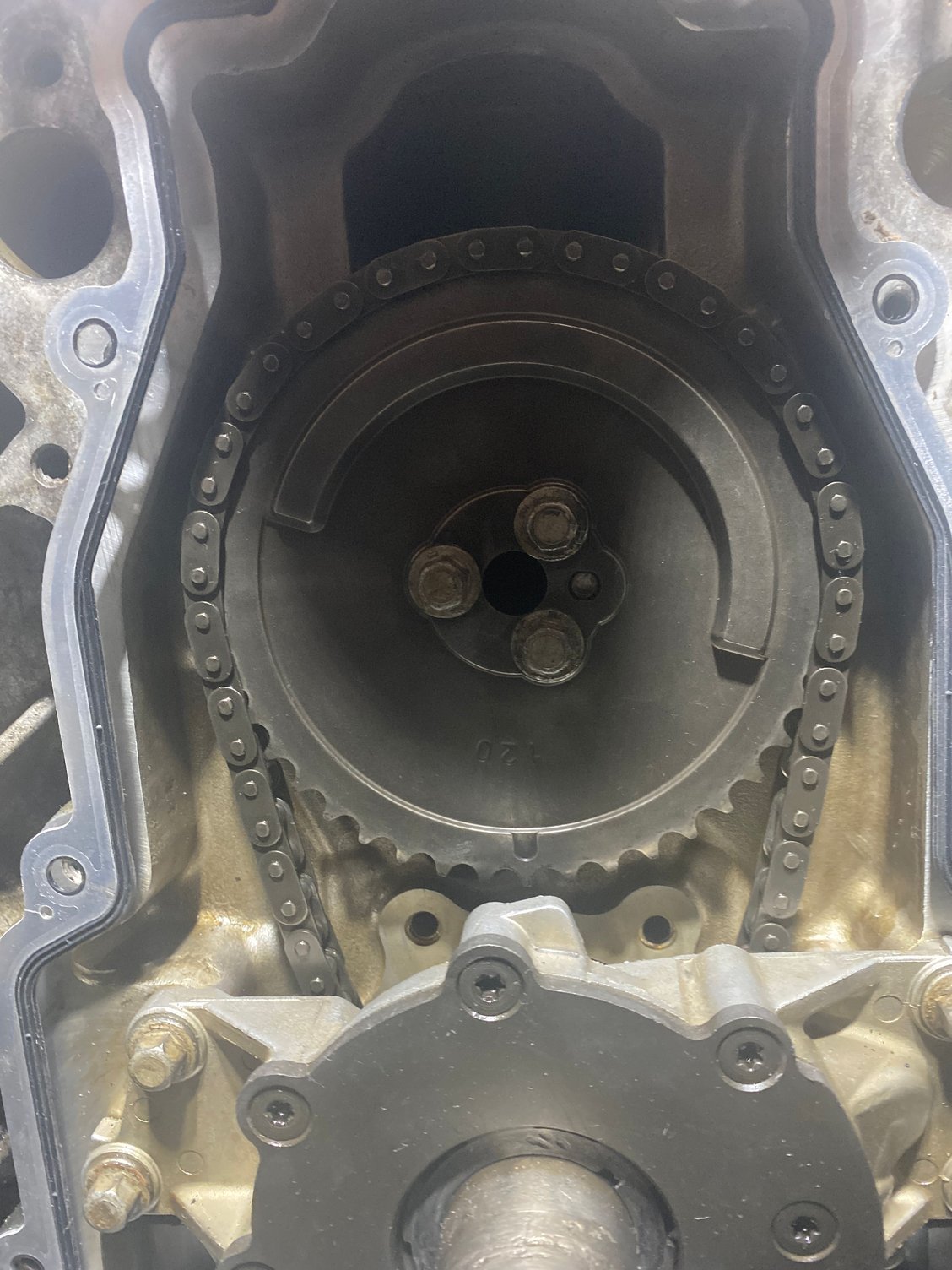

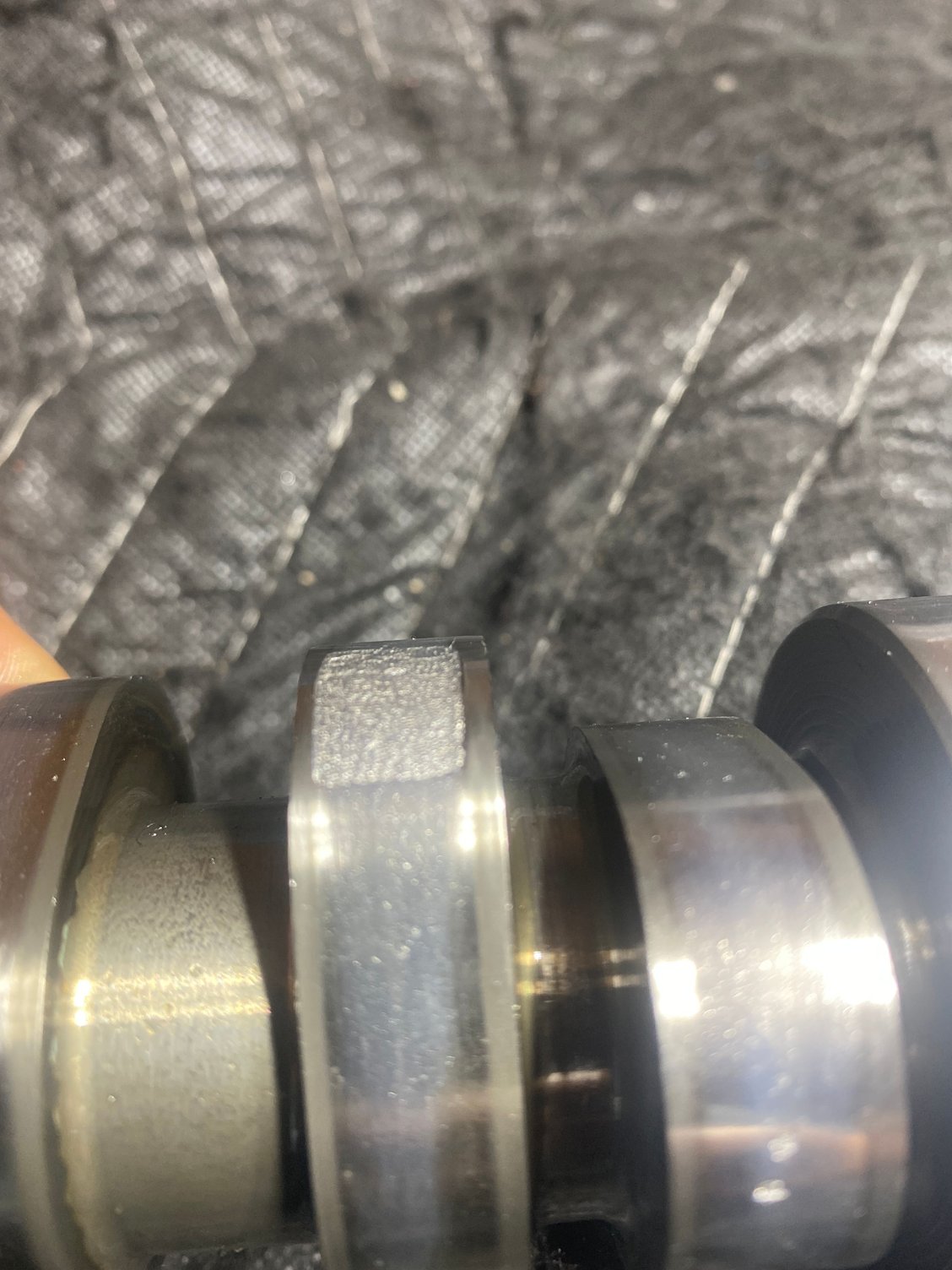

So today I was pulling the trans am apart to do a cam swap and complete the build as I knew nothing about this car when purchased as far as the internal specs on lifters, cam, heads.

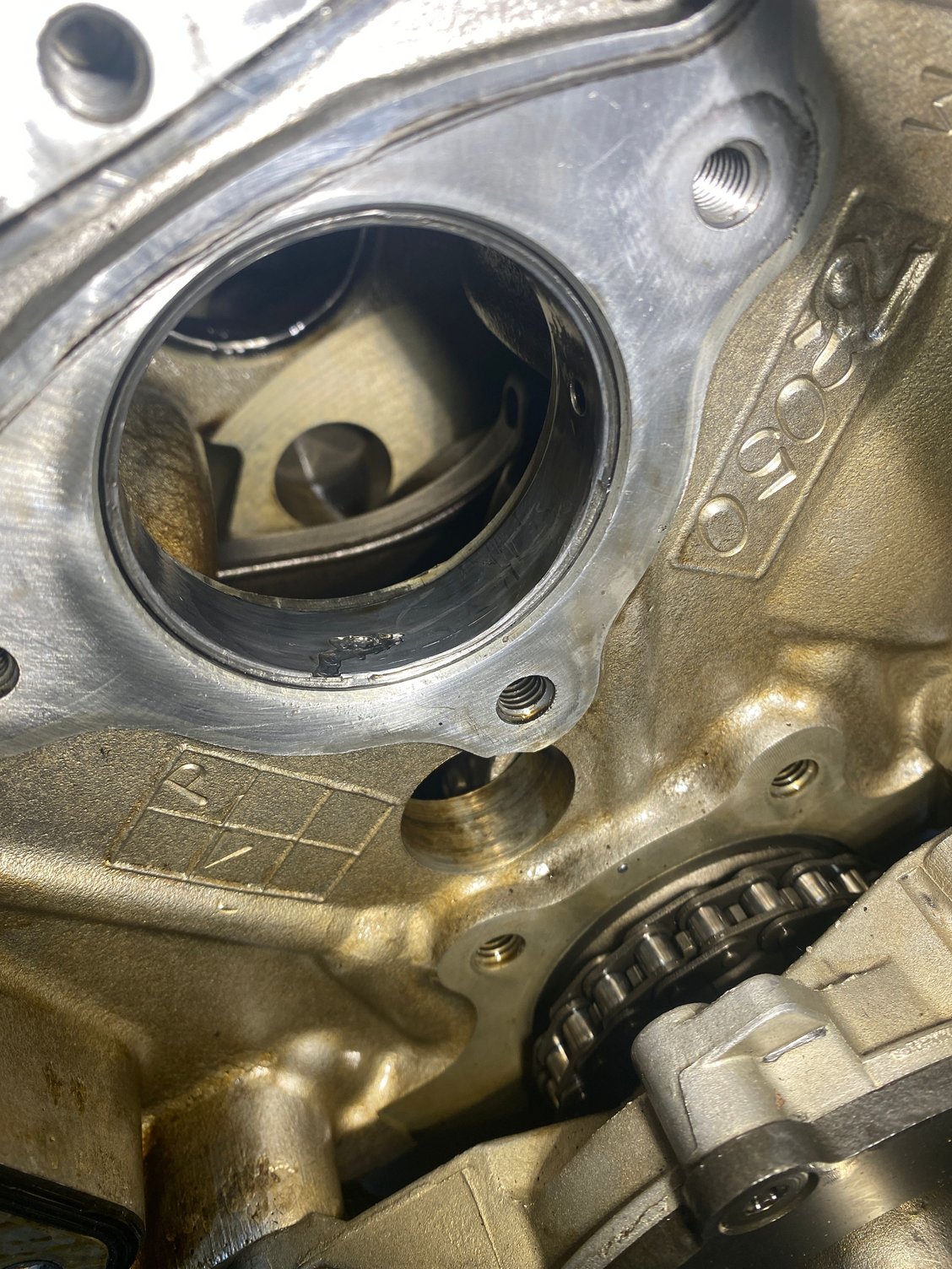

I pulled the cam and this is what I found. The 1st bearing is shot. All other bearings look good. The cam lobes look good except for one and all lifters rotate and look fine when I looked inside via mirror. I rolled all the lifters and inspected carefully. Took me a few hours but I got it done. Looking for some advise!
Cam Bearing

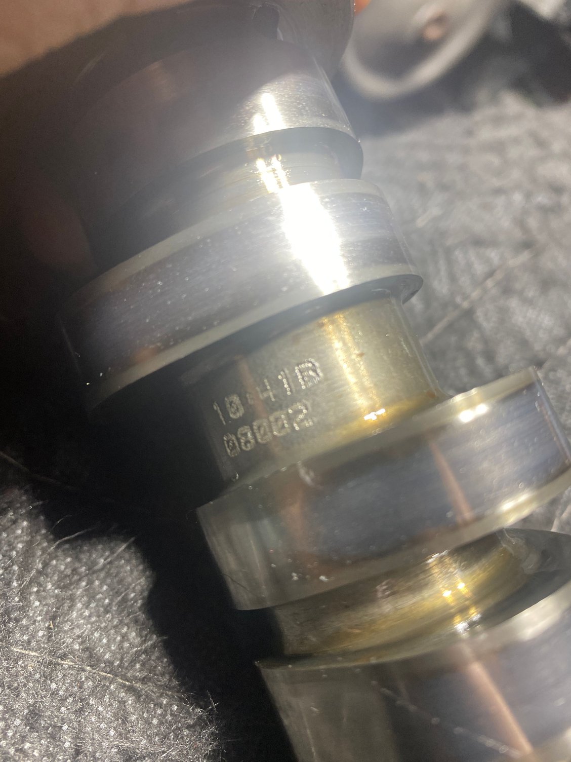

Numbers from Cam. No clue what these represents. Help!
Lope looks shot, I think someone installed this crap and sold me the car. It doesn’t add up the damage I’ve found.
No chain tensioner installed.

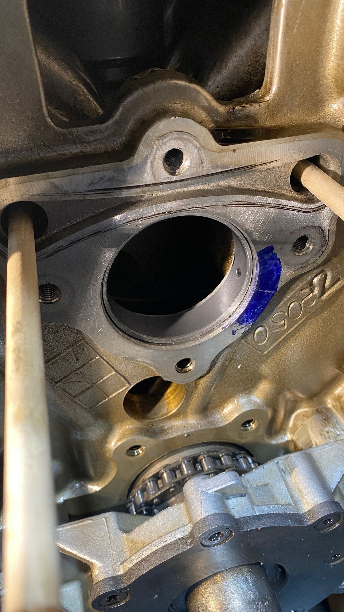

Replaced cam bearing, hopefully this will hold.

Pulled the CAM, has no numbers other than 10:41B 08002.
