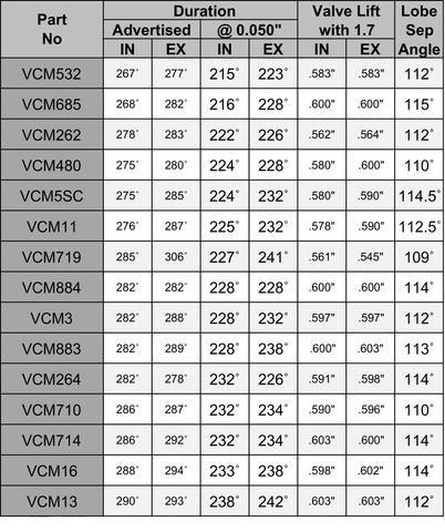

CAM specs are below

I'm no expert (so take this with a grain of salt) but I feel like that's a lot of cam for a street car with "mildly ported 241 heads". Unless you plan on running a smaller turbo for lower RPM boost, I feel like driving it around is gonna be really sluggish.
That being said, why not talk to an engine builder? There are plenty of vendors on the site who will spec you a cam, either something off the shelf or something custom that will suit your motor. Remember that the cam selection should be one of the last things decided upon when speccing your build, so I would decide on what sort of boost route you're going to go, then figure out your cam.

No, that wont drive too well with stock cubes. It will definitely have big cam characteristics.
I think you will be disappointed. The Intake wont help you in the torque department either.

ok so the "mildly ported heads" are now going to be Higgins CNC'd 241 heads so that should open it up a bit more.
I would have thought eh intake with the internal trumpets would have been good for torque, particularly down low as it would increase air veolcity.
Plenty of people have used the VCM710 cam here and had good results on mostly stock motors.
