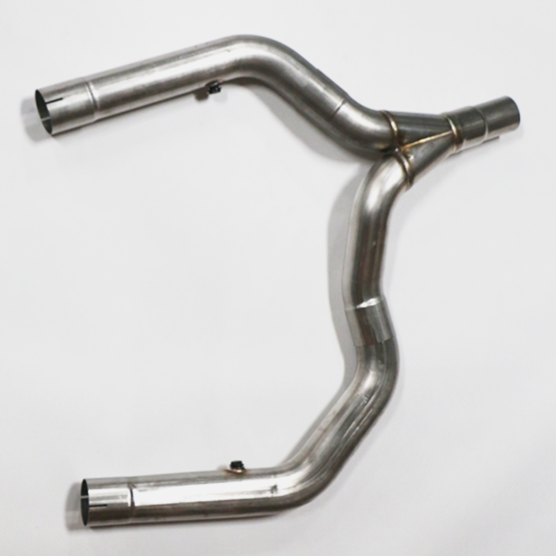

If it looks like the second pic yes. If it looks more like the first pic no.
This is the exact pipe I have. Which looks like the first pic to me. So I don't think that's the problem.

Yeah that should be fine

So basically Texas Speeds y-pipe is a POS and I just wasted money buying their stuff? Is that what you're saying?
Darth is right on the merges. They are all a bit too small on the off the shelf y-pipes. Mine is a speed engineering y-pipe. I sliced it as far forward as possible and flared my 4" pipe so it would sit over it. In other words I opened up the merge as much as I could. Still isn't as good as the flowmaster one which I've been meaning to buy and fit but haven't yet, but it's very close to it. If you don't chop off the end of that merge as much as possible and weld a 4" pipe onto it, it is too restrictive as a 3" outlet.
