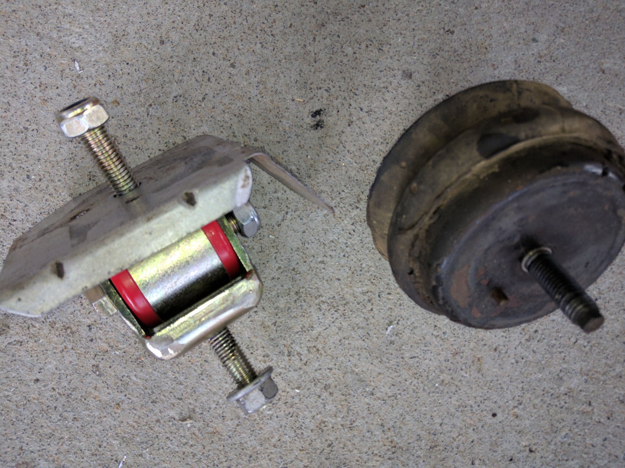

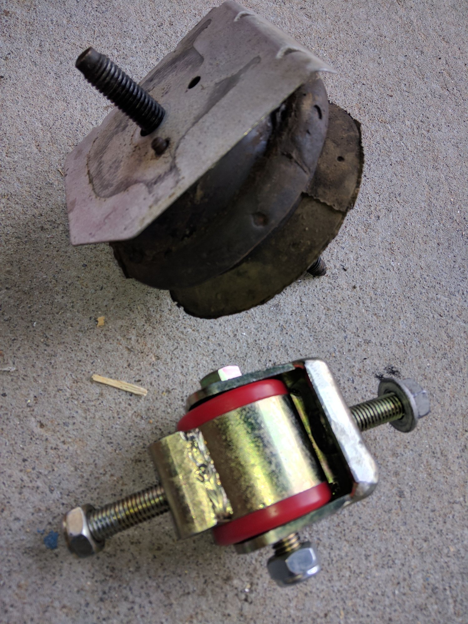

Hi
I have these new red nolathane engine mounts (yes I know they emphasize engine harshness) what I want to know is should I use the stock engine mount sheilds or is the red nolathane more resistant to oil. The reason I ask is I like the appearance of them and would prefer not to cover them up.

They are heat shields (not oil shields) and yes you need to install them in the OE positions. They protect the motor mounts from excessive heat.

Oh, that would have been a bad thing to leave off, really appreciate the info thanks.

Thanks for the link, I soaked them in vinegar until the plating was removed then painted them red. Hopefully they will stand the heat ok.
Lots of differing opinions on NVH levels with poly engine mounts, I was hoping the added stiffness might emphasise the mild shake from the cam I have in my engine?
