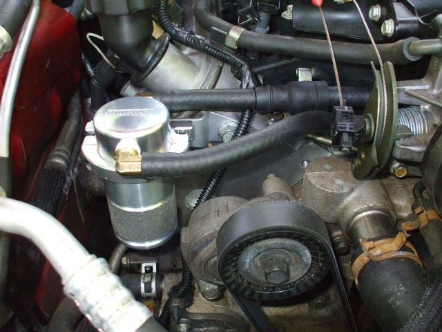

Converted PCV system to the LS6 system using the LS6 valley cover. The Moroso catch can fits perfect. I made the mounting backet using 1 1/2" wide 1/8" thick steel purchased at Home Depot. Also used the stock PCV valve of the LS1.

Better than nothing, but I find that one to be too small for me, I wouldn't want to be emptying that every day or week, depending on how much you collect.. I actually run 2 in series, an MM and a RXSpeed.
