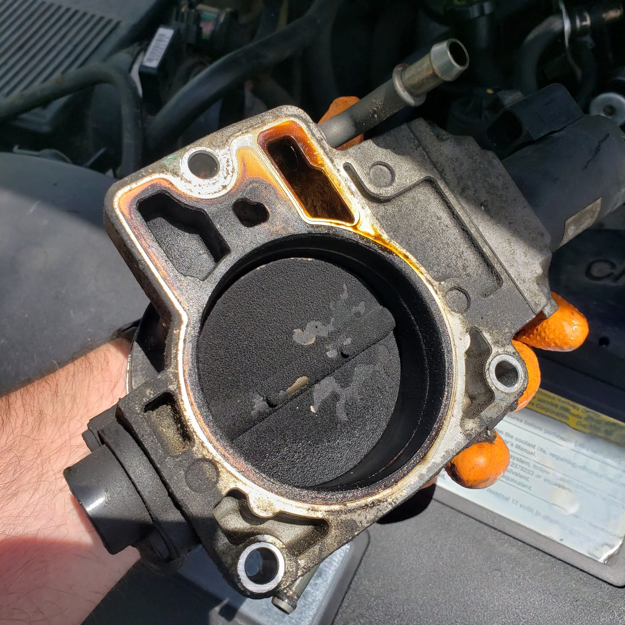

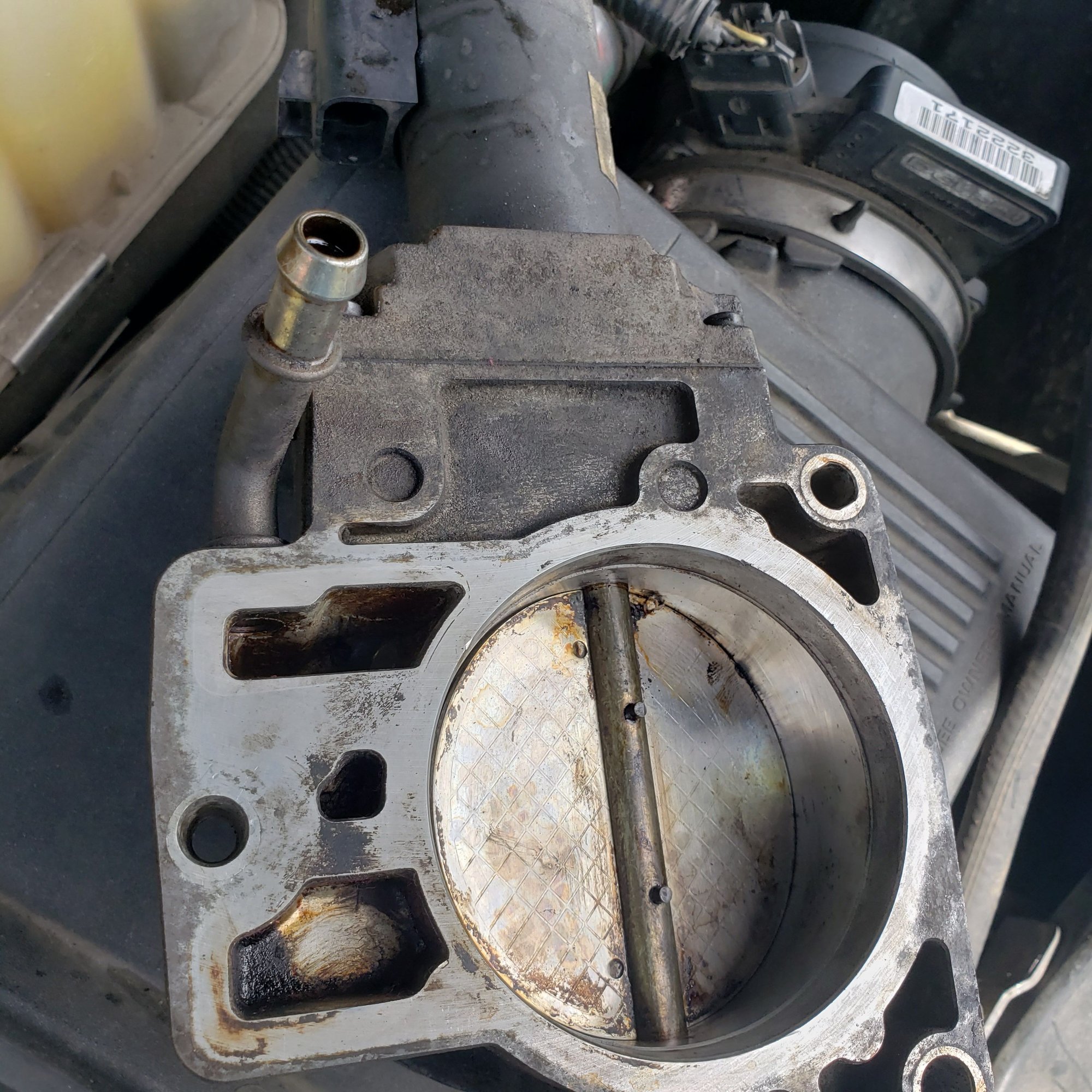

Cleaned the throttle body and that stopped the stalling issue at low speeds in parking lots. Seems to run great. The lt fuel trim still goes to -8.3 while idling for awhile, but im not too concerned.
So if anyone is having any of the issues i had. Intake gaskets, clean your throttle body and check your fuel pressure.
