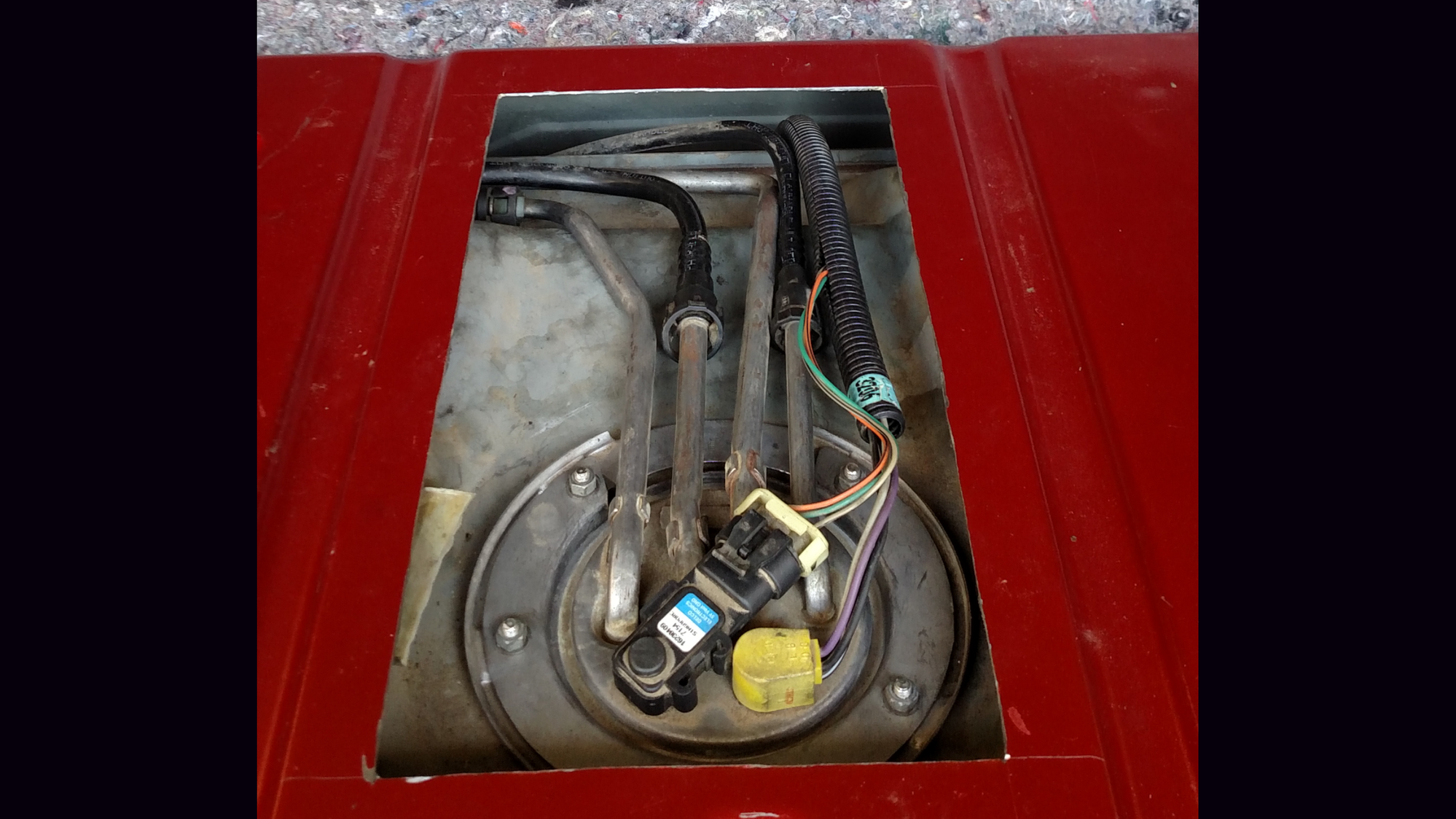

You dont remove the tank, you cut a trap door.
Let me know if ya want the measurements for cutting.
That's ghetto. There is a right way to do things and hacking holes in your floor isn't it.
Old May 14, 2020 | 11:39 PM
Bspeck82's Avatar
Joined: Jan 2017
Posts: 1,758
Likes: 442
Originally Posted by Spamfritter
That's ghetto. There is the right way to do things and hacking holes in your floor isn't it.
There is the right way to do things. Then there is also the smart way. My real door mod came out very nice and works well. Took 10 minutes. Dropping the tank is a waste of time. Trapdoor also allows ease of service or pump replacement in the future.
I've seen it done nicely enough on occasion but most of the time it's a hack job of a repair that I've never liked.

Is that pic from a 98 model? Because I believe that the cut for a 98 is different.
You have any pics of yours? I've seen a million different examples. Its not ideal but it does make it far more easy to access the pump in the future if you need to.
You could not be more wrong. Nothing ghetto about that. Clean and straight. 90% of vehicles have a trap door from the factory.
True story
Yes mine is a 98. The other year's are lower.
We are the top one

You guys can keep dropping your tank, I couldn't care less.
Me...... if my pump goes out I will be back in action in a hour

Cut like the pictures shown above but follow the hard lines and cut a bit more on the top left to access the connections there easier. Cut as much needed before you break the seal of the pump.
I'm not wrong. Does the service manual have you cutting holes in the floor? No, it does not. Do you now have a squishy spot in your carpet where metal used to be? Yes you do. (Unless you make a door for it, or repair the hole in some way.) A faster method doesn't make it the right method. A hole in my floor is not desirable to me. I'd rather do a bit of extra work and avoid that. How many fuel pumps have you gone through where this is a real concern? I've had three fourth generation F-Bodies and six third generation cars..I've had to replace a fuel pump once in two decades of owning these cars. I've also only ever bought one of these cars that had the floor cut like that. None of my friend's that have had these cars had floors cut this way either. That tells me that fuel pump replacements aren't all that common for these cars.
I get it if the car's a full race build or something. At that point you need the car back in action quickly should the pump fail. Full on race builds typically have a lot of cutting done to the body anyway. But short of that, I wouldn't do it.
