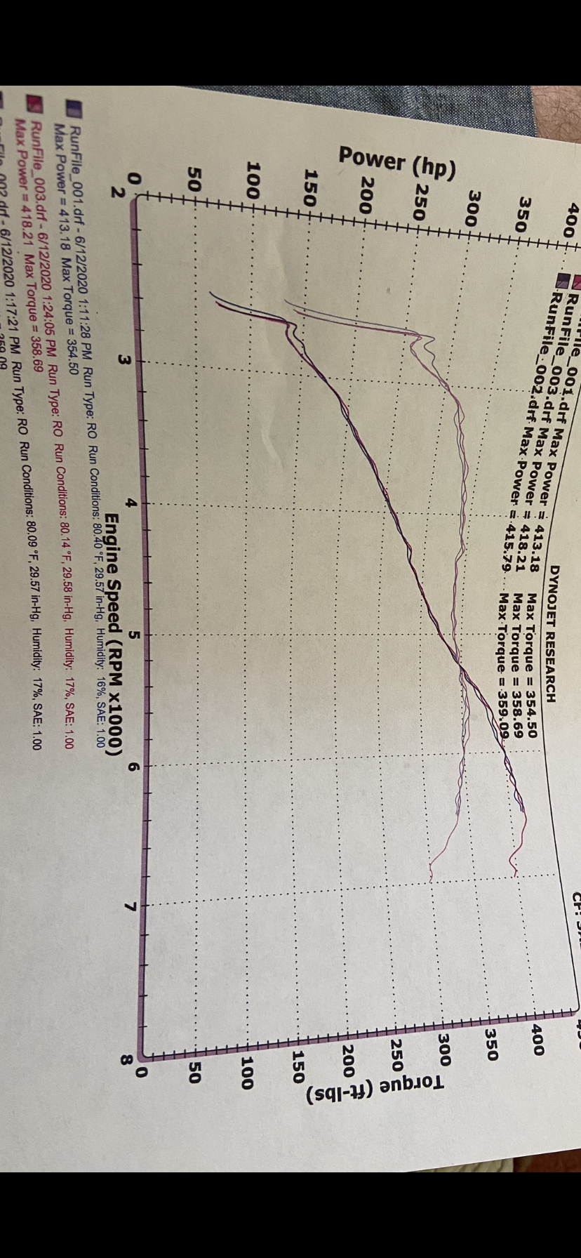

do you happen to have a picture of the graph? Those are pretty solid numbers.
here
here

Nice. Looks like the torque comes in early and holds a long time.
