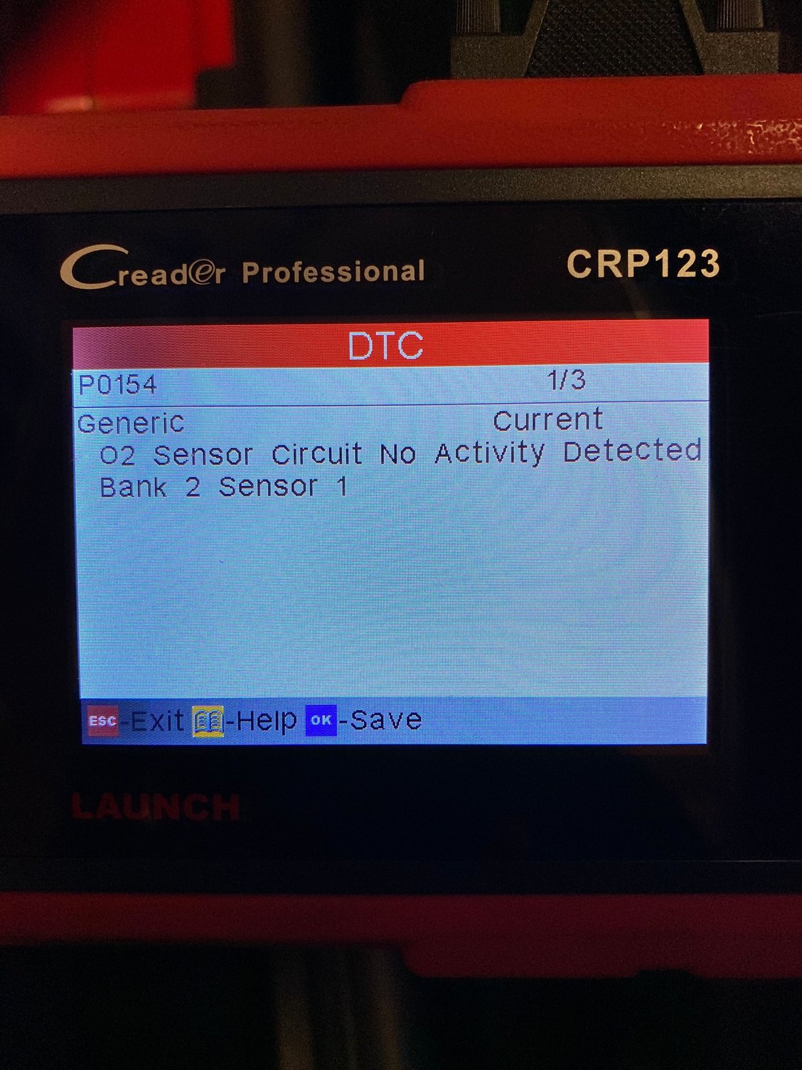

I’ve got code P0154 (O2 sensor circuit no activity detected bank 2 sensor 1) ive heard this one is a pain in the *** to get to. passenger side behind intake manifold.

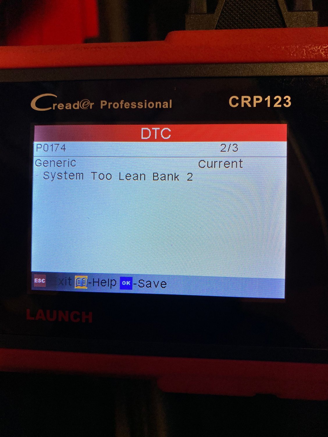

car runs awful under 3500 rpm, sitting fuel and has no acceleration at all. i’ve attached a picture below of the code i’m getting.

You have a connection issue on the 02 sensor on the passenger exhaust manifold before the cat. It has either become disconnected, needs to be replaced or the sensor is bad.

Yep. And I would add that it would be unusual for the harness to be fried; 99% the O2 sensor is fried.
