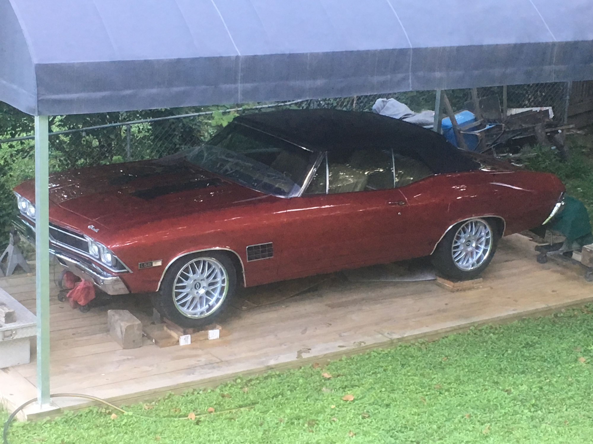

This has been a 14 year Nut & Bolt resto project so I'm not panicking now. To be honest it was nice to here it "kinda" run, I know I'm close. Thanks for all your help guys.
Tony
