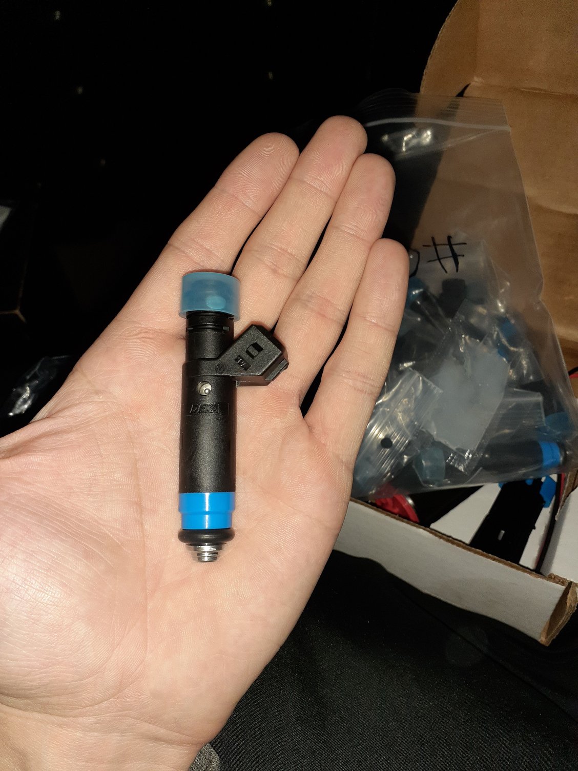

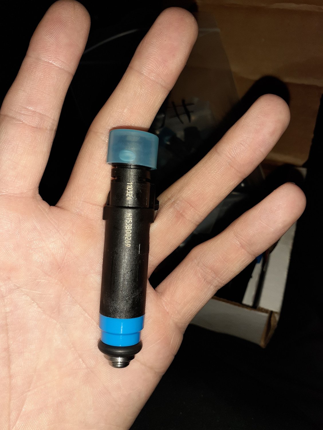

I read a couple things about the fast102 and issues people have with installing them and some people have said that you need a "special skinny injector" I wanna upgrade my intake before I send it off for the tune (still trying to decide between SD and MAF tune&#128542 but I bought my Deka 80lb injectors so I could get tuned for E85 now I'm wondering if these injectors will work with a fast102 if not I'd probably just go with a fast92 sense these injectors are still brand new in the package and I'm not going to buy anther set of injectors

Spacer between the rail and injector so the spacer would bolt to the intake? I just read a post someone put a spacer between the injector and the intake seems that would really screw with the spray od the injector

its a spacer for the fuel rail not the injector

This-
Originally Posted by 01camarosstx
.........you may have to install a spacer between the fuel rail and intake manifold.
not this-
Originally Posted by tberg725
spacer between the rail and injector

The overall length of my ls3 injectors with a height adapter are equivalent to a stock ls1 injector. Injectors werent long enough without the adapter so in a pinch i used some small washers to fill the gap between the rail and manifold. Hasn't failed me in 5 years.
