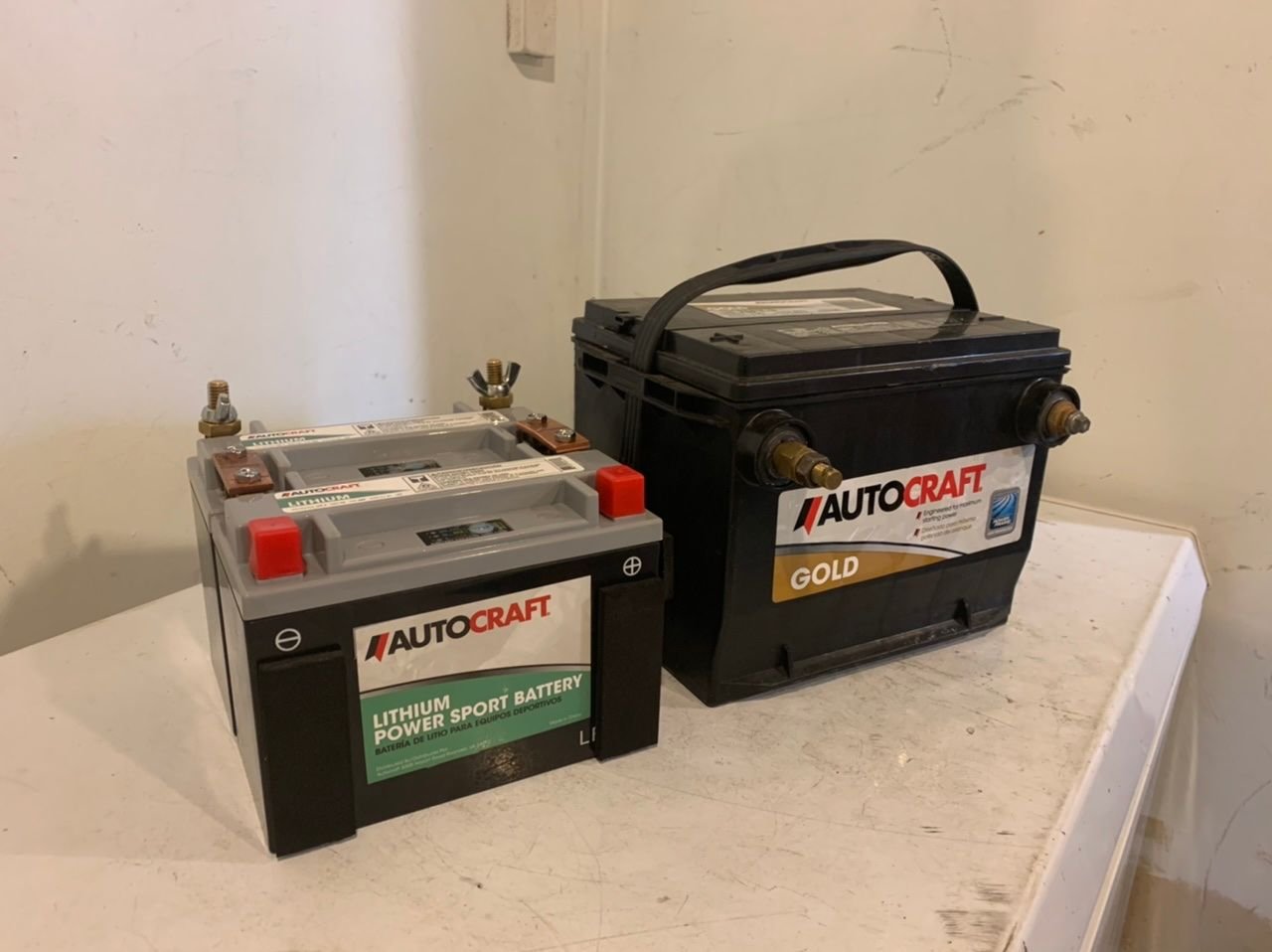

I’ve been running dual cheap LIPo lithium batteries in my firebird for about a year. They were $110 for 2 about a year ago and now u can’t find them lol. They are power sports batteries and connected together and starts my turbo 5.3 from the trunk so much faster than a gold series lead acid. I put in a manual marine cutoff switch that if the car is gona sit I kill it but I had a hot start issue one day and I cranked and cranked the car like 10 times in a row and it showed so signs of slowing down. These lithium batteries have built in power level leds and I have maybe $135 invested. I bought the batteries, 1/8” pure copper plate that I cut to make the jumpers and got a marine battery strap to hold it down in the battery mount in the back of my 87 TA. I ran single 0 welding cable a year or two before when I did the rear battery relocation. I run a custom blower cam and and FB db electrical stock style gear reduction starter.
I will tell you these batteries turn the engine over very easily and much faster than the led acid. They have never needed a charge since I got them and they will sit inside my warm basement for the winter and will never need a trickle charger or anything bc of how well they hold a charge. these are 380CA each so they provide 760CA and all together weighs less than 10lbs.
I got the battery tender 4 amp LiPo battery charger which you will need for these types of lithium batteries.
the cost of the lithium setup was less than a new led acid at my local advance auto. I couldn’t imagine paying $300+ for a lithium battery...
