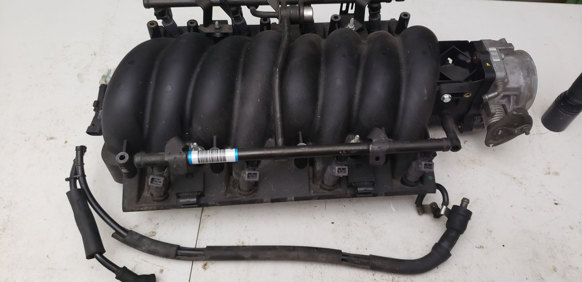

Are you sure that 90 is also check valve? It certainly wasn't on my 01 LS1 and the only PCV I found was on the line from both valve covers and it was just before going into the intake manifold.
Here's a picture of this line I speak of. Notice the PCV valve at the end of the line. The original LS1 had a large port on the rear driver valve cover and two small ports for 3/8" hoses on the passenger valve cover.
Yes, it's definitely a check valve. I blew into it from both sides because I originally just thought it was a 90 fitting. After pulling it out I saw the valve. I have the same set up as you as far as valve covers and the stock pcv goes. The engine was originally built for a procharger so maybe the previous owner had something else going on. Guessing I should just come up with something different so it's a straight through fitting on that driver's side valve cover?
