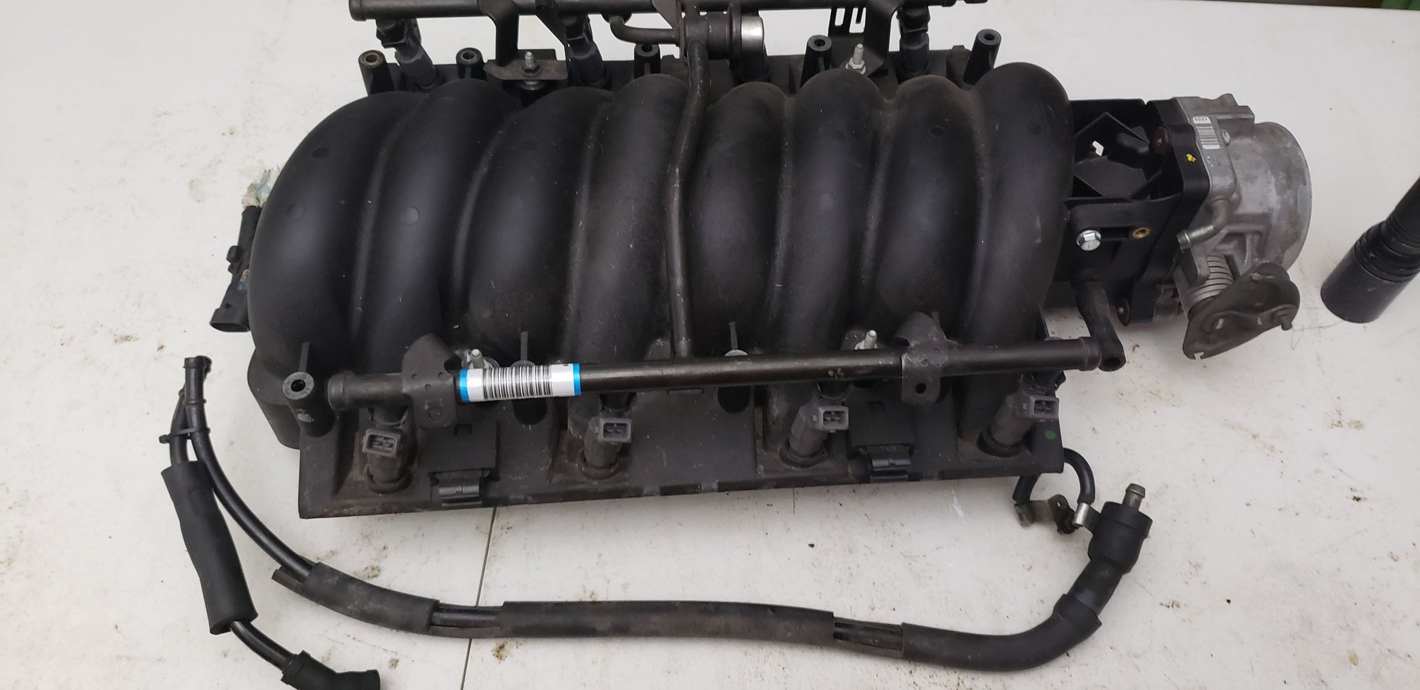

This is the stock setup and the passenger valve cover had two ports instead of one. Notice the PCV valve at the end of the hose just before going into the intake manifold? You don't have to run a sealed catch can but it will help slow down some of the blow by from getting into your intake manifold.
