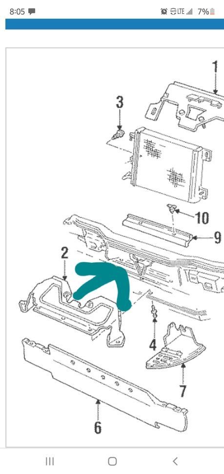

I do want to keep the Air conditioner. The lower air dam is still in place, only trimmed a little that was needed to clear some piping. The air diverter in front of the radiator has been removed due to the front mount intercooler. My stand alone transmission cooler is mounted on the passenger side in front of the AC condenser.

What do you refer to when you say the "diverter in front of the radiator was removed"? Got a pic of what piece you mean?

The fans only come on once temps reach 180*. So if temps are within range they run, or if AC is turned on they will come on no matter the temperature. The Diverter in front of the radiator I was referencing is the radiator baffle shield. It normally installed to funnel the air from under the nose up through the AC condenser and the Radiator. Items 1 and 2 have been removed.

The pieces you took out are definitely contributing to your issues at low speed
Yea, he needs to figure out how to fit those back in or make something like them...the air has to be directed to the radiator.
Those pieces will no longer fit due to the front mount intercooler. I also believe my IAT will rise as there would be no place for the air to flow to once it exits the intercooler.
Air is currently directed to the radiator through the nose of the car with the fog lights removed and license plate hole cut out. Then flows through the intercooler and then the transmission cooler, AC condenser, and the radiator.
