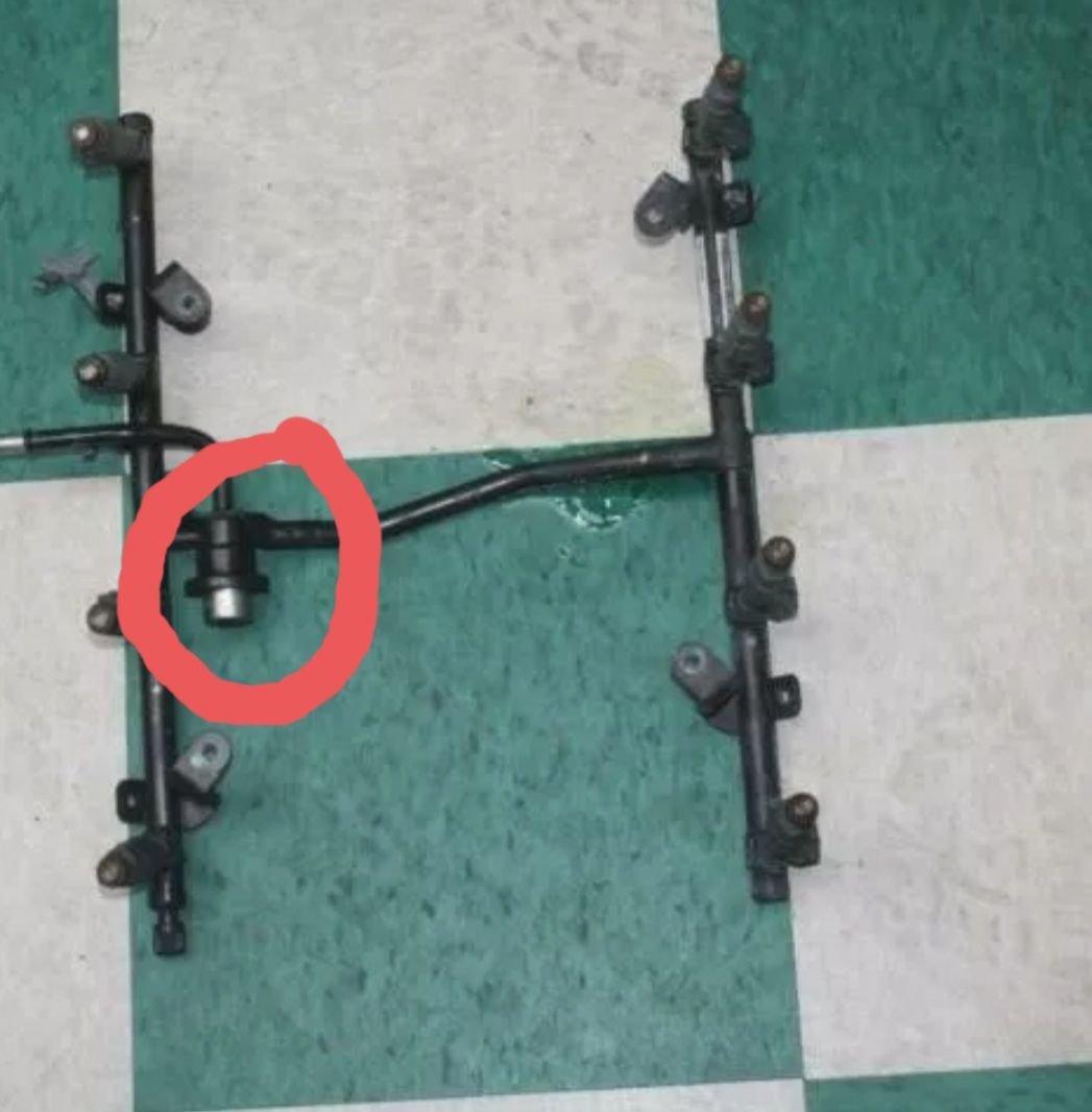

I have been looking at aftermarket fuel rails and they don't have the piece circled in red. What is it? Some type of regulator? Do I need one with an aftermarket setup?

That looks like a fuel pressure regulator but I am not certain.
If that is in fact an FPR and your car came with one from the factory then yes you will need to add an FPR setup with aftermarket parts.

Are you running a return style or a return-less fuel system? If you are using a return style then I wouldn't use the rails in your picture. I have the LS6 intake with a return style system. I'm using FAST rails and a adjustable regulator.

The item circled is a pulse damper, it's not necessary to incorporate it in your new arrangement.
