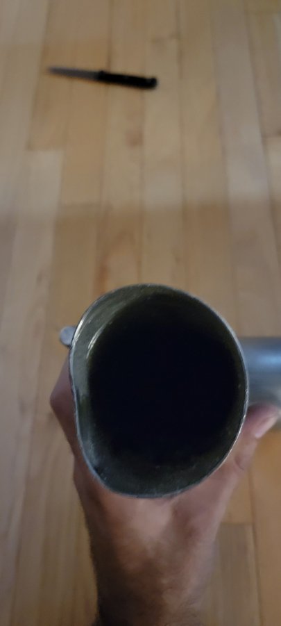

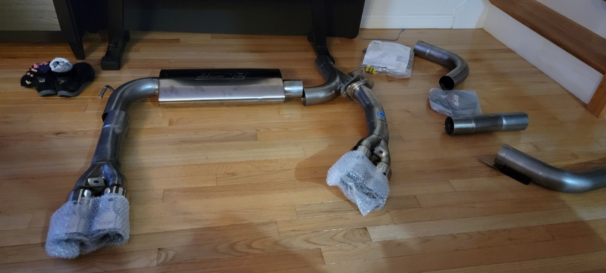

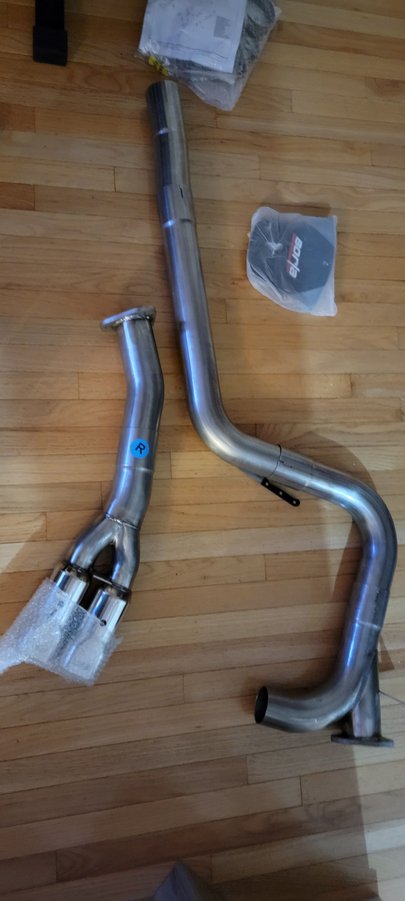

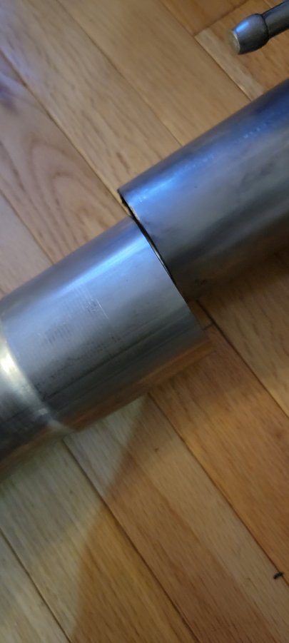

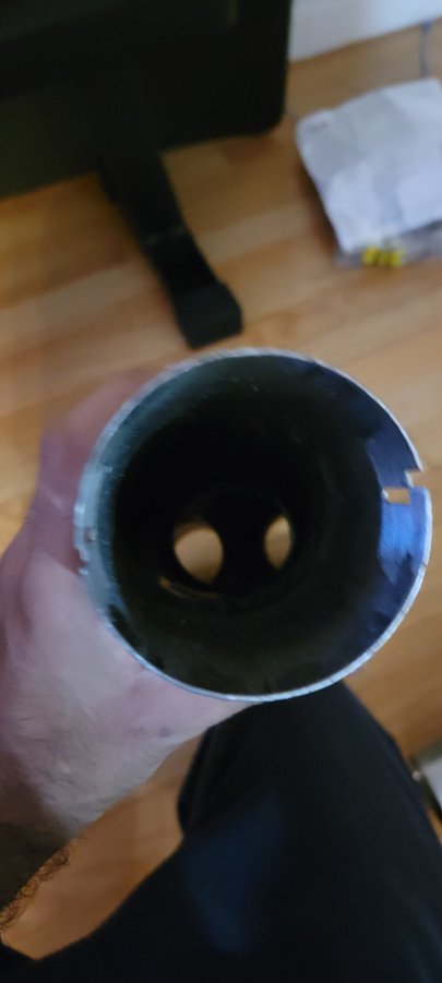

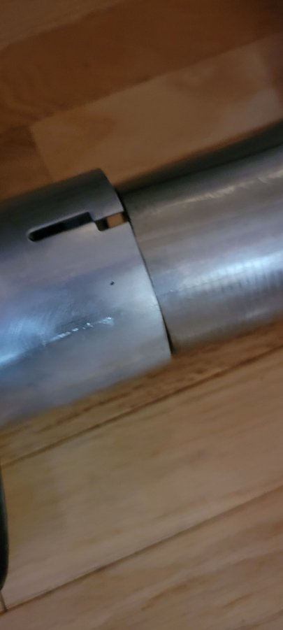

Hello All.
I just received Borla 14780 Catback Quad Exhaust.
As I began to put in together on the floor, I saw that two sections did not want to go into each other smoothly or at all.
I have pictures. The muffler is the one, the entrance and exit pipes off the muffler are not able to go in due to one being flat and the other being the same size.
All the other sections fit on smoothly. Even the right tips are ok. Just those two sections. I spoke to Borla who suggested but I'm not sure he quite understood me, said to take it to a shop but they won't need to bend it?
I wanted to simply do it myself and save the money.
Should I just get a connector or coupler and reduce the length so as to fit them on?

Take the muffler to a muffler shop and have them expand the inlet to allow a slip fit. Shouldn't cost more than a few bucks.

You could also try taking a torch to the female side for a minute or so . The heat may make it expand enough to get it together

Go to yer corner parts store and "rent" an exhaust pipe expander. Won't cost anything except gas for 2 round trips you're probably gonna make anyway.
