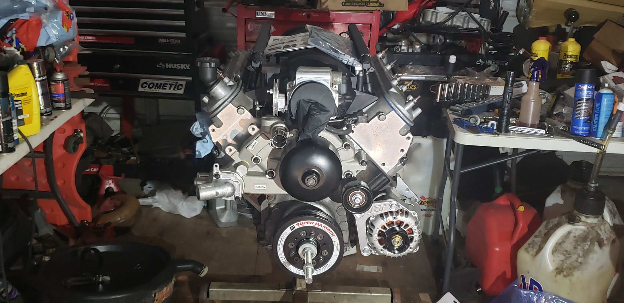

Looking for a nice, and correct puller for a 5.3 truck style ATI super damper. I'd like to hear what you have used, likes, dislikes. Thanks

I bought the ati puller with mine. It’s really easy to use and put it on or off the crank very quickly.

I unbolt my ATI’s from their hubs and use a 3-jaw puller on the steel hub itself. Easy peasy.

Assuming it's the same style as the ATI for F-bodies, the rental remover at oriellys worked for me (non-jaws style).

ATI918999 which is the puller/installer and ATI918999SC which is a shaft that threads into the crankshaft to remove the balancer. Not a cheap tool by no means but at least you will not have to disassemble the balancer which isn't a big deal either.

A piece of all thread with nuts and washers works for installing the balancer.
