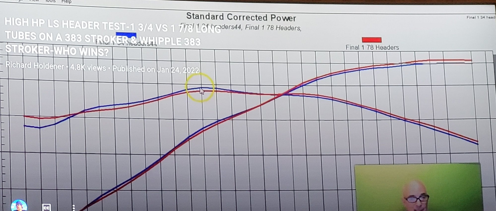

Definitely not worth worrying over too much for NA based on Richard Holener's dyno results in
. I'll stick with the 1 7/8 on the 383+ LS1. Matches pretty close to what TSP, VR & LPE have shared previously +5 to 8 hp for 1 7/8 vs 1 3/4
Moral seems to be we should pay attention to the full exhaust (collectors & Y pipe, X pipe, true dual etc)

Some points you guys are missing.....
First off, look at the different in the collectors between the two headers. We all know header collector design does play a role in this. the 1 3/4 headers have a better design collector where its longer and more gradual into the merge. Also, the supercharged 383 MADE MORE POWER with less boost. Bring the boost back to where it was.....well, I think we all know what will happen.
My opinion on this..... a 5.3, 5.7 and even most 6 liter engines won't need/benefit from 1 7/8.... but if you plan on more power, bigger engine or boost/nitrous later on, maybe just do the bigger headers from the onset so You arent spending money twice and/or regretting you didnt go bigger in the beginning. A 6.2 thats pretty stout with big heads and especially big exhaust ports will likely benefit....and over 400cu. in. making big power will benefit.
Sometimes I feel like his "tests" are quite like comparing apples to oranges in alot of ways and the average uninformed tinkerer will not know any better that details are being left out....that really matter.

Originally Posted by 2001ws6ft
Your engine is 80 cubic inches over stock with upgraded heads, intake,, and cam. Testing was done on a 5.7 displacement.
The point is, not every combo will produce the same outcome. Like Che70velle said.

What reason would Richard have to distort stats between two header sizes? If it were different name brand products I could see possibilities there. He has made his rep on straightforward dyno tests.
How would you know there was no loss with the 1 7/8" headers unless they directly replaced some 1 3/4" headers? You didn't mention any previous headers

I enjoy most of his videos, he’s a lively soul. But a good scientific, controlled comparison is definitely not what he’s about. A lot of times he will compare some **** that similar, but aren’t the sane engines. Example. He may test this cam or that cam, same size engine, but not same engines on the same day. Then compare those two graphs. Might even have different heads. To me, that’s not a fair test at all. I honestly think he’s doing it for the views and whatever money he gets. Sometimes he will post stuff that would be acceptable, but most of the time he’s pulling graphs and comparing in past tests. How is that valid?

A lot of what he compares is what people ask about. If he has done tests in the past that are very close, that is what gets put up. He WILL point out differences between test subjects and how that affects the test. Sometimes those differences don't affect the target outcome of the test, and he will also point that out. You can't just see the parts tested and skip to the dyno chart. Dyno time isn't cheap, and I doubt he's getting wealthy off this. Hopefully a decent living....

I don't think Holdener even mentioned the results in the title? So, I'm not sure it's clickbait? I think that he would get pretty much the same number of views no matter what the results were. Although, a few extras clicking on it from this thread maybe

There was lots of controversy and the 1 7/8's generally came out as better overall based on what was posted. I posted a search and links to some of those threads earlier in this thread.
We all know different dyno, different day different set up means we can't say absolutely without testing.
I like Richard Holdener and his video's but there's nothing new about 1 7/8 headers in his video that Texas Speed, Lingenfelter and many others haven't shared with their testing many years ago.
Couple years ago, considered putting Lingenfelter's little GT2-3 cam (207/220 .571/.578 118.5) in my nearly stock 02 Z28. Talked in detail with LPE about best headers to purchase 1 3/4 vs 1 7/8 for that cam for best performance. Based on LPE's dyno results answer was a quality set of 1 7/8 headers.
RH provides as honest and accurate information as his budget allows and I'm grateful for it. However, one still needs to do the appropriate research for their project and not take YouTube video as gospel or at face value.

Technically you need to compare apples to apples but that is problematic. Testing same brand would be consistent but even TSP 1 3/4 and 1 7/8 header collectors look slightly different. Different brands run the tubing different.
I think his conclusion is probably valid. Smaller tubes on the street and larger tubes for track. Your butt dyno probably won't know the difference though.
On Mamo's test in another forum/thread he DOES put in the disclaimer that he is speaking of WOT only. I think tubing size MIGHT affect part throttle response one way or the other.

In-vehicle results with full exhaust won’t necessarily mirror engine dyno.
