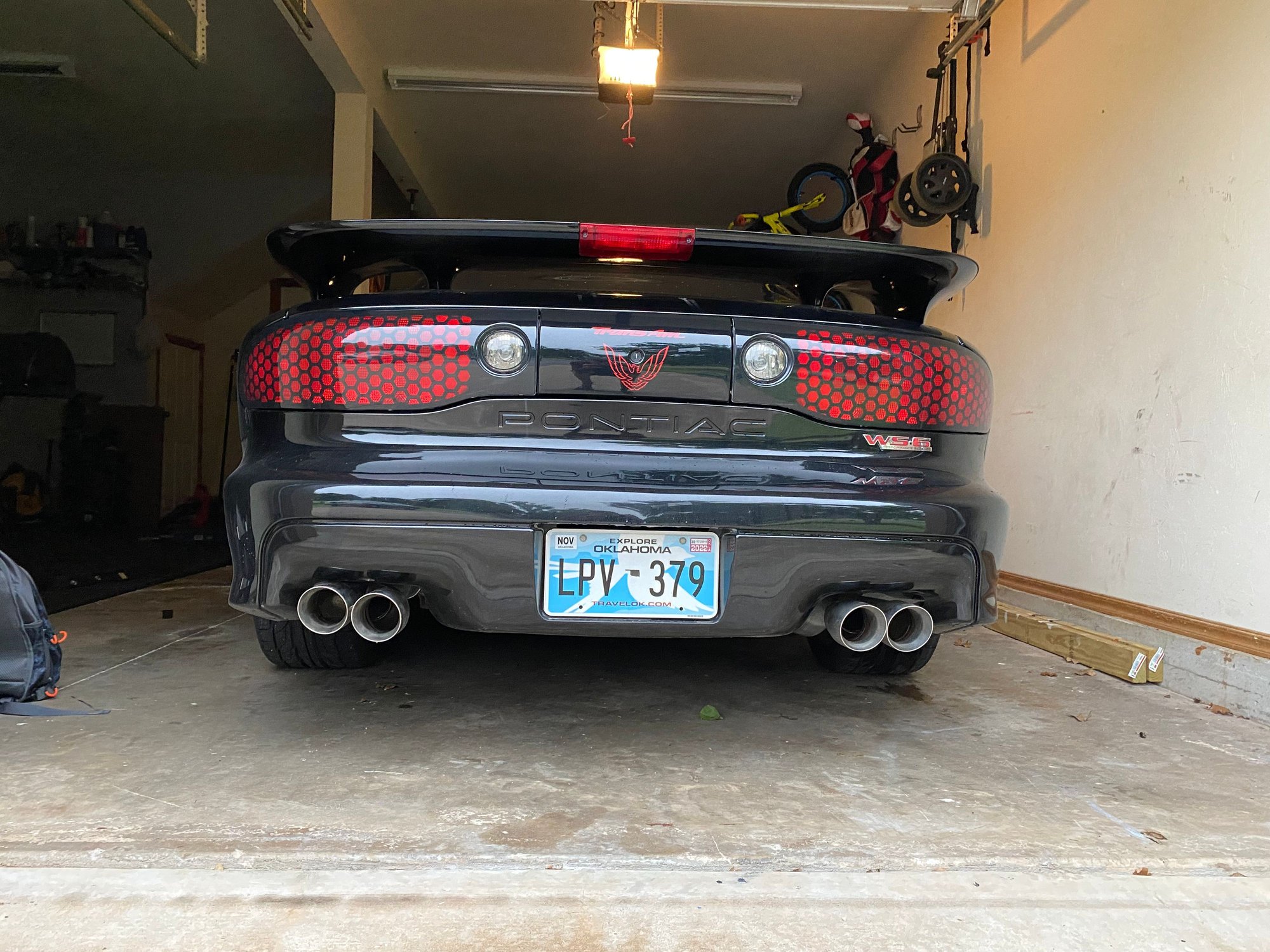

Well, thought I would take a moment to button up this thread since I finally got the exhaust installed. Here's how it broke down:
-Used Borla cutback from Facebook marketplace ($200)
-3.5" Corse clone tips from SSclones.com ($155)
-Installation ($120)
That means I'm at $475 all in on this exhaust system. I feel like I got a very good deal, and it looks and sounds awesome. I have a restrictor plate in there for now. I might pull it at some point for giggles, but I'm really happy with how it sounds. It's pretty deep and tame at low RPM like the Flowmaster was, but the difference really happens at 3k. It's a different animal in the mid to high RPM range. The tips aren't perfectly centered, and I may get that fixed at some point. It just not enough to bother me at present time. Overall, I'm very pleased. Thank you for your time.

Sweet! I would take it back to the muffler shop and just ask them if they can straighten the tips up, no way I could drive it like that lol.

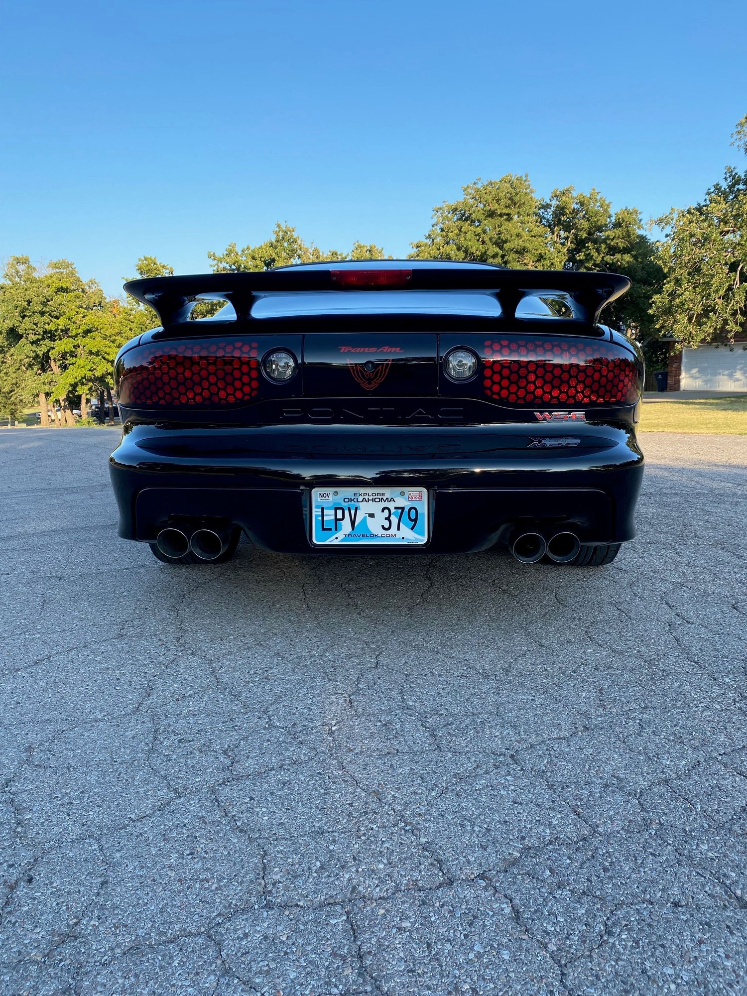

Fixed!
