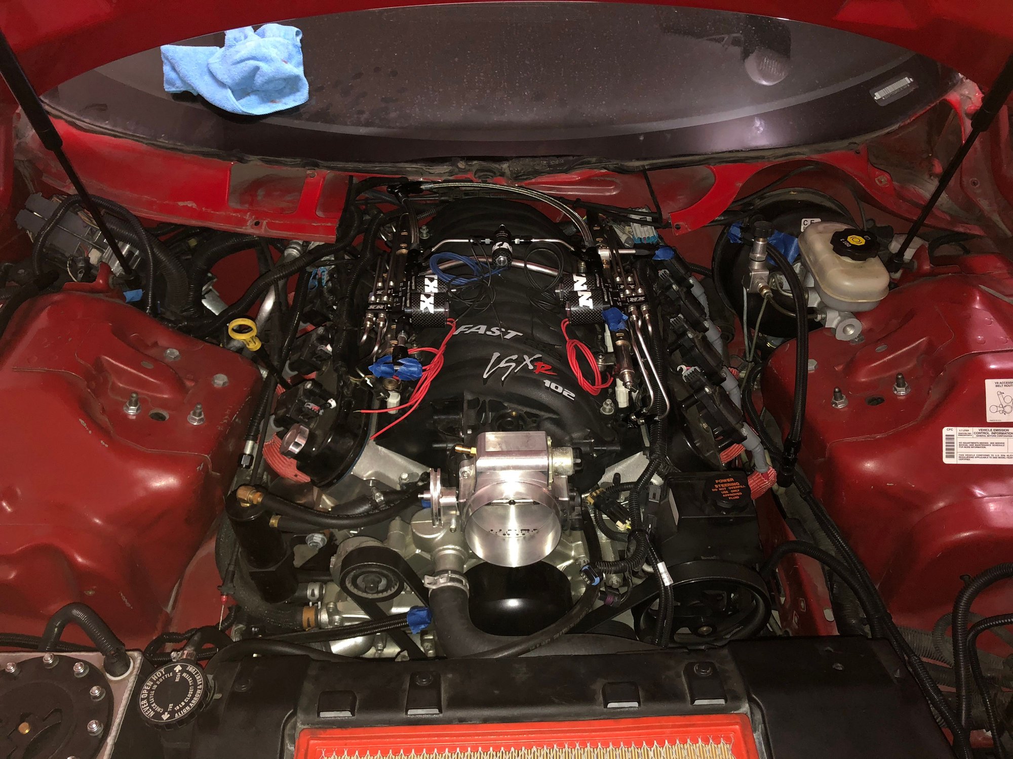

Just an update, bought a ported fast 102 from tony mamo, put it on a few days ago and went pretty smooth. Intake dropped right in without any cowl clearance issues like i feared. Bought the LS2/3 fuel rails from tony also with the spacers and fasteners, a map sensor extension harness to move it to the front and a 4" 22 degree bend silicone coupler, and a NW 102 throttle body. Had a new 85mm maf already so decided to use that with the harness adapter and a 98mm lid. Had to fight with the fuel rails a little to get the bracket holes to line up with the intake but eventually got it on and was able to reuse my 50lb deatchwerks injectors with the supplied fast O rings. Already bought a new waterpump which is the updated LS2 version but still had to grind the rear edge of the water pump a little where the snout of the intake was touching, also bent down the coolant crossover until it cleared. Bought a small rubber vacuum elbow for the HVAC vacuum line in the rear since this intake has the port coming stright out in the back. Was able to reuse the PCV lines from my LS6 intake and stretched the brake booster hose a bit and it hooked right up. Aside from the pain in the *** of reaching the passenger rear intake bolt it wasnt all that bad. Started it up but it wouldnt idle with the new MAF so i temporarily rigged up my old maf and snugged down the clamp so it would be tight in the 4" coupler. With the old maf and a small adjustment of the set screw on the TB it fired right up and idled. Just have to swap the fuel pump and get it to the tuner now.
which boot did you use to connect the throttle body to the maf? it looks like a reducer
