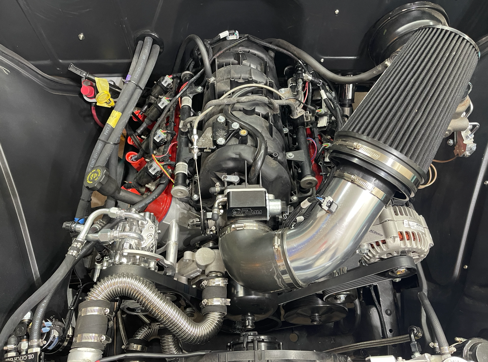

I am trouble with my vacuum lines. I just rebuilt a Chevy LS motor for my 57 Chevy 3100 project. I am running a 2022 LM7 5.3 Vortex truck motor. I started it up for the first time this week. The good news, it started right up. The bad new, it's making a screeching noise and I have no brake pressure. I have good oil and fuel pressure. The motor starts and runs fine. I am thinking that the vacuum lines are not hooked up correctly. Below is a picture of the motor and a diagram of the vacuum lines. I am looking for advice on my set up

Take that yellow open line from throttle body area and put it to the out port on catch can……..what is ecv? Hopefully that’s not open as well…if it is , cap it off!!!……oh it’s ecu, your running a terminator x….disregard that last statement, just run that one line to the catch can!!!!
