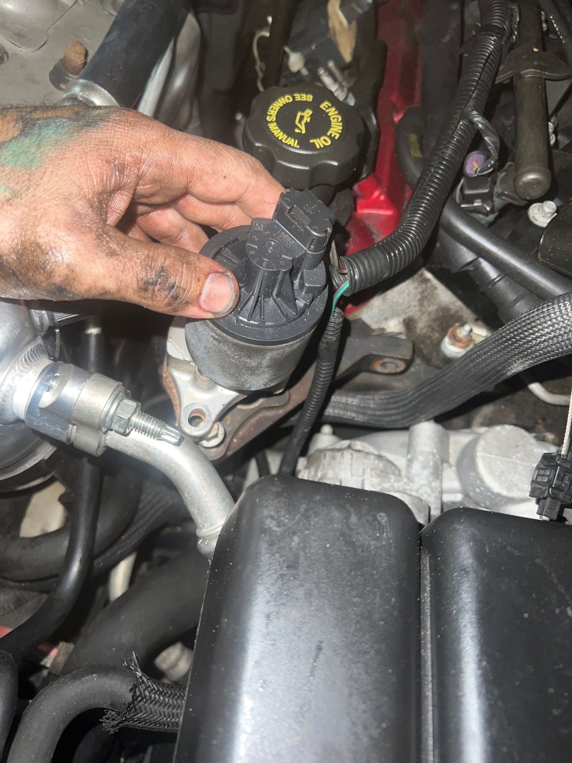

New to the world of trans am and doing a hooker black heart mid length header install and while removing the old exhaust mini fold I ran into this and wanted to know if there is a delete I need to do since the new headers do not have this line going. To it. Thank y’all for any feed back

That is for your EGR. Here is a little writeup on how to remove it since you won't be able to use it anymore.
https://ls1tech.com/forums/generatio...gr-delete.html
This will also throw a check engine light so tuning will be needed (plus beneficial for performance) after this is all done.
