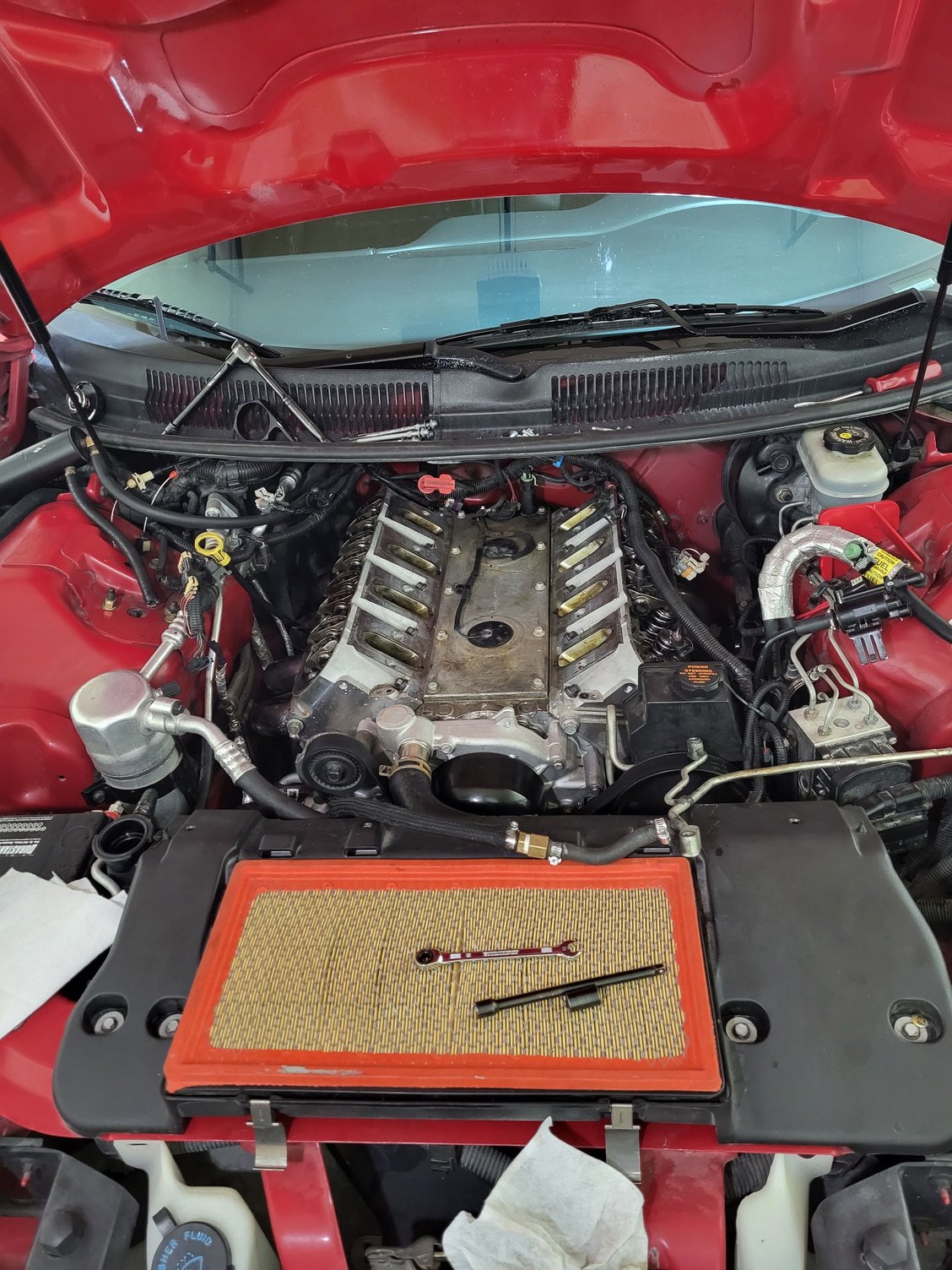

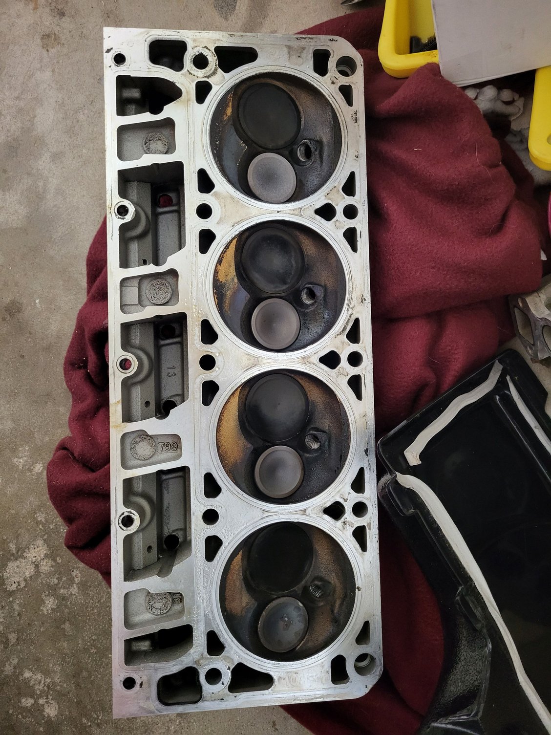

Passenger head is out

Well if coolant made its way in then the valves and piston should have a nice steam cleaning. Did you run back through the sequence again after each pass? It's unusual to have the end bolts be the looser ones after being torqued, I have seen where the 1 and 2 bolts needed to to be retorqued after the initial pass.
Yes I made all the passes in spec with the ARP guidelines for head bolts. Idk wtf happened but I'm sure the old *** Snap On torque wrench didn't help. Haven't pulled that head yet. Here's another pic. I don't really see any issues on this side.

Nothing jumps out at me either. How long have those heads been on the engine?
April 19. Thinking I will find the issue on the other side where the loose bolts were.
