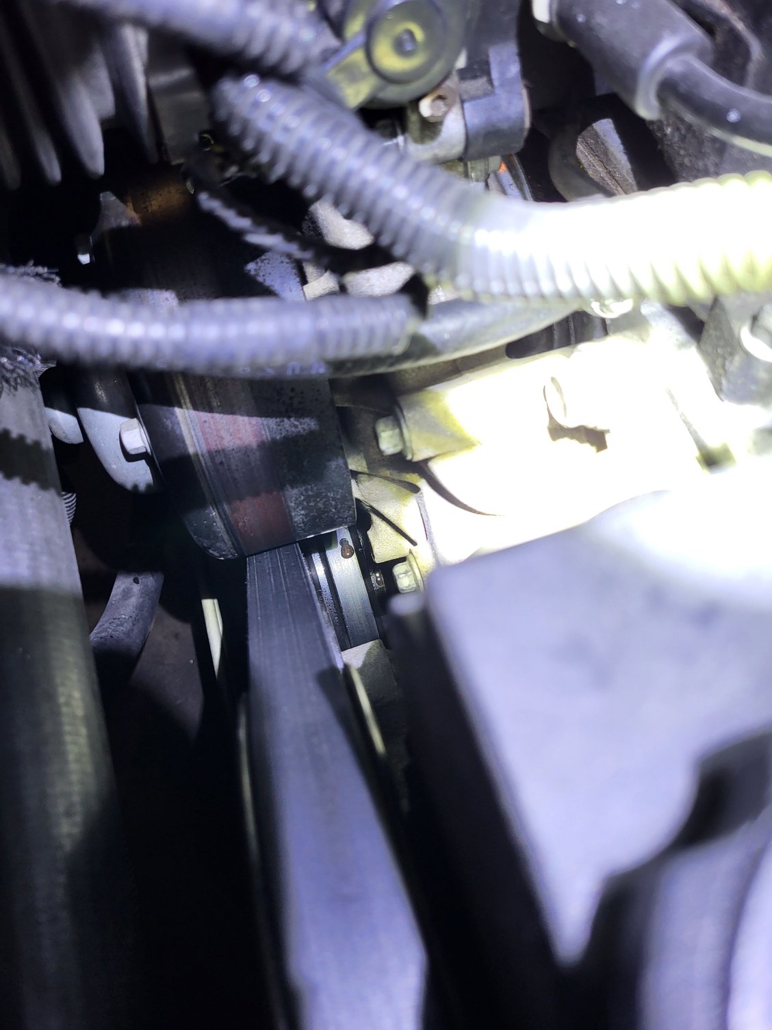

New development. Rented a different pressure tester. It's leaking from either the Thermostat housing/hoses or the water pump on the passenger side

Old Sep 4, 2022 | 11:16 AM
Tyler Dietzenbach's Avatar
Joined: May 2019
Posts: 1,006
Likes: 133
From: Kentucky
Old Sep 4, 2022 | 02:31 PM
01CamaroSSTx's Avatar
Joined: Feb 2015
Posts: 6,024
Likes: 2,303
From: Conroe, Texas
Found it!

Apparently that was just the beginning.. lol. Replaced thermostat o-ring and still had coolant loss. Another pressure test showed this. I think it's the water pump itself and not just a gasket.
You're just full of good news! Are you certain that its the pump and not the coolant crossover? Does look like it's in the area of the weep hole but either way it shouldn't be too much trouble to fix.
Welcome to my life. I've been working in a different city and when i came home:
Camaro losing coolant
Pacifica losing coolant
Camaro hatch struts failed
Yeah i replaced all the coolant crossover gaskets and all is good there. I think it's the weep hole, which means new pump.
