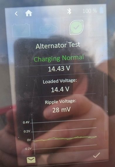

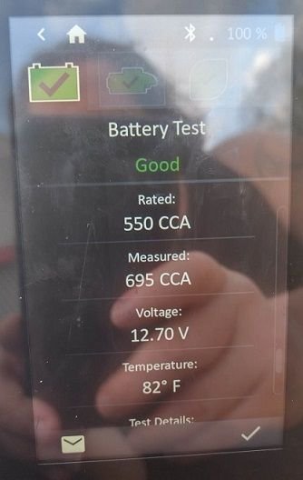

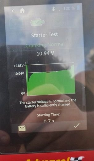

I did the Alt mod, the ACD DR44G (334-2529A), on my bird. The BATT gauge has always flopped around, I figured it was doing its shitty GM gauge dance, but it usually held at the tick after 13; however, just recently, it's been holding below 13. Also, when it surges to the tick past 13, the lights dim and you can hear the loss in power (notice my RPM, OP gauges, and when the battery gauge moves).
I had the charging system tested, at Advance Auto, and everything came back good. I don't get it. I hate dealing with electrical issues 😖

Did you see the pics I posted, in the OP, of the Advance Auto test? I'm sure it's not the most comprehensive test, lol, but I figured that it would shed some light on the issue, but then everything came back GOOD, so who the hell knows.
